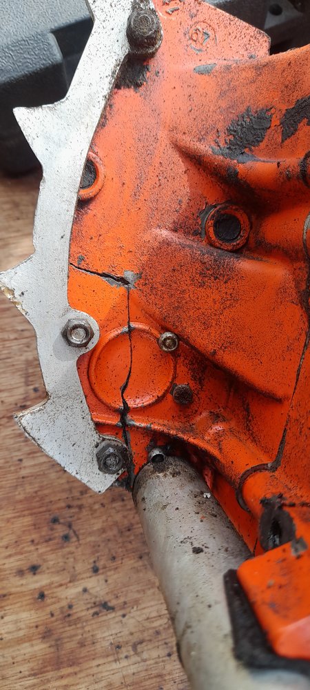

I've recently been getting into chainsaws again and acquired an old Husky with a cracked/broken case, which I'd like to weld. I just can't justify the cost of a tube of rods for 40/50mm of weld....
Anyone have a few spare tig filler rods for Die Cast Magnesium, please.
As above, I have had really good strong repairs using the low temp zinc rods, a little practice first will be needed, Once you get the hang of it away you go.
