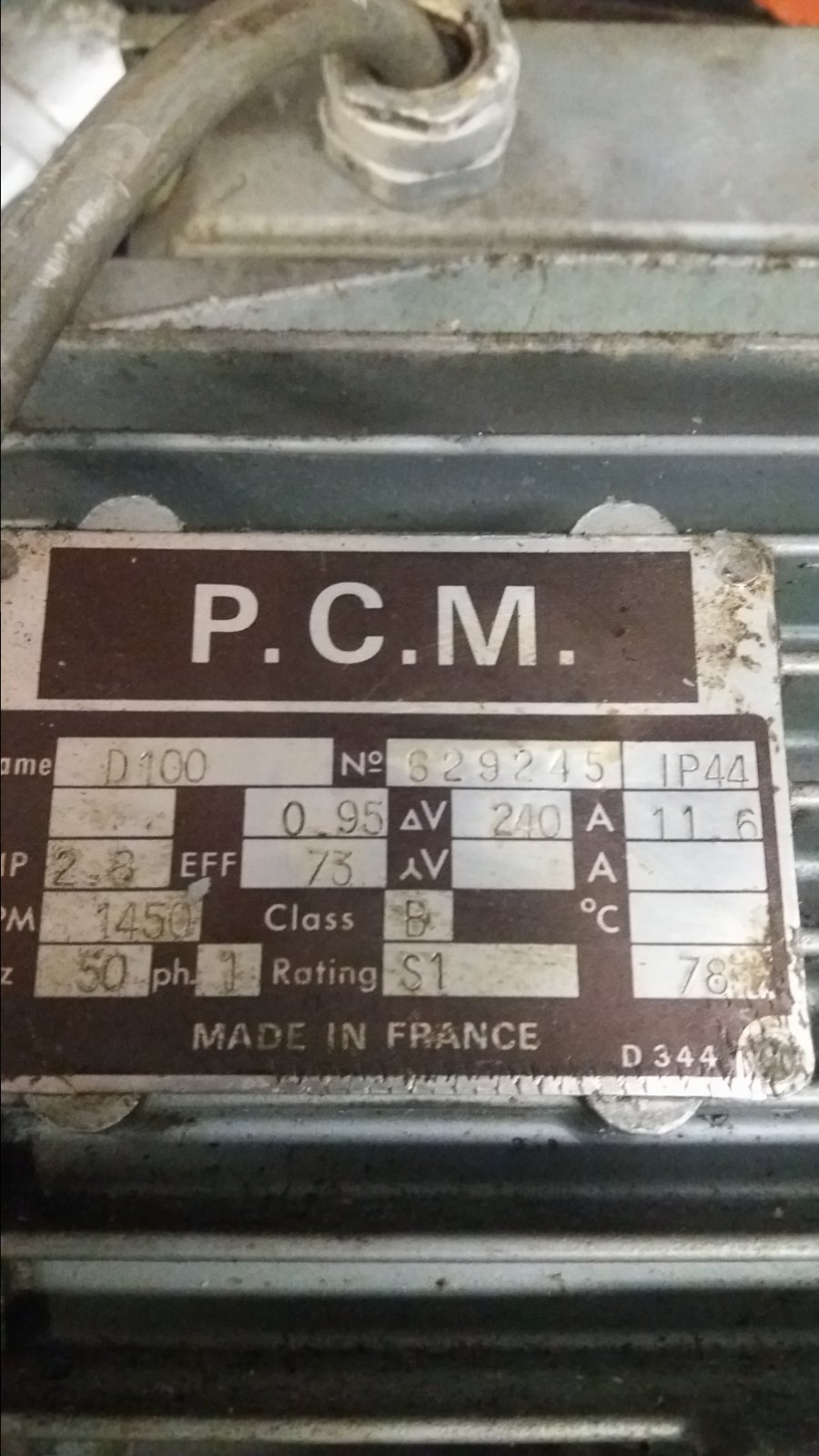

Its a Pallas V1 with 2.8hp single phase motor. Bought with blown start cap. Extracted motor and changed cap (200mfd) and it ran great on the bench.
After a load of faffing getting it back in place, started it up and it was a bit slow. Stopped, pulled clutch in and it ran ok. Let clutch out and it ran ok for about a minute until start cap started smoking badly.
Now have I bought a dodgy cap or do i have a motor problem blowing cap? Mill has not been used for yeats but everything moves freely.
Not happy wasting a precious holiday!
Whats everyones thoughts?
