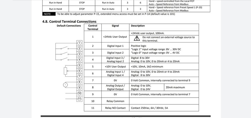

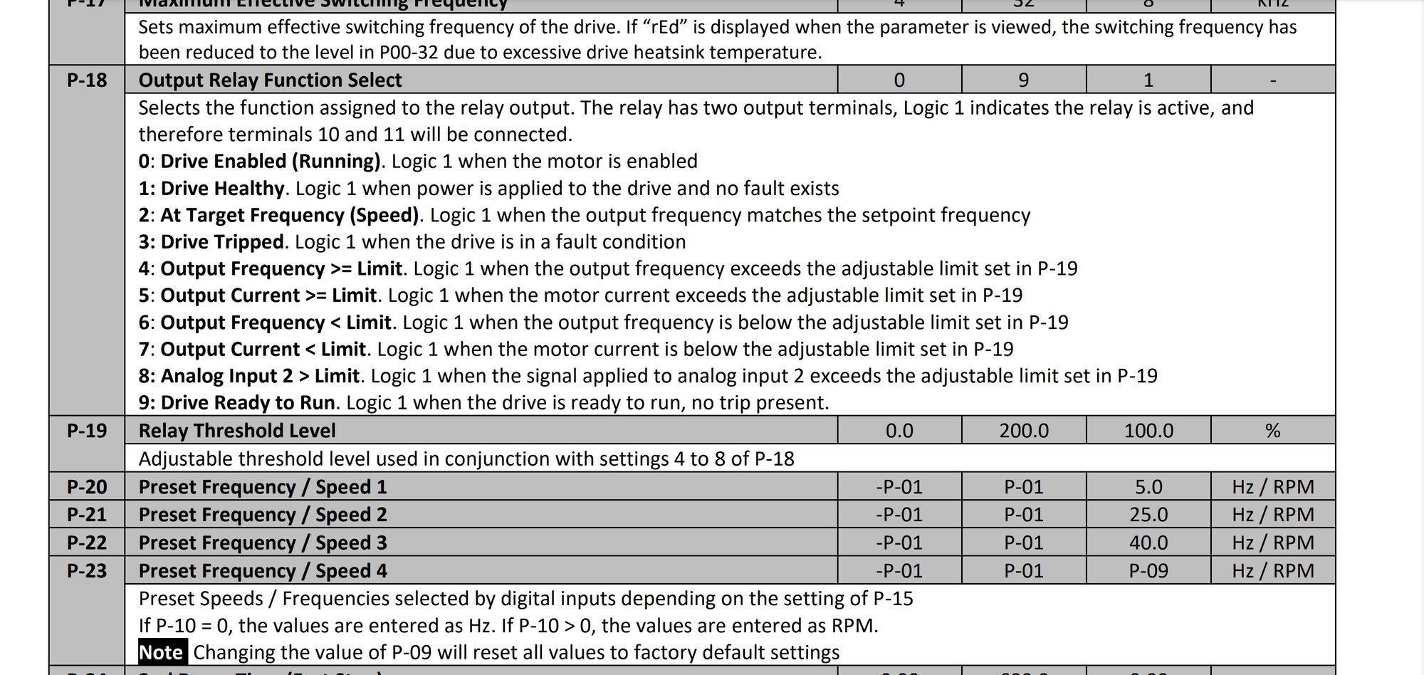

I've got a machine that has a 3phase motor on it.
A cleverer bloke than me set up a vfd on it to run it from single phase.
I want to add a work light to this machine. It would be easy enough to just wire one up but it would be nice if came on and off with the motor
An led strip light would be ideal but I have plenty of room to mount transformers, relays etc as required.
Is there usually any sort of anything built into vfds that I could use for this?
Should I find and read the manual for my vfd or is that likely to be a waste of time?
