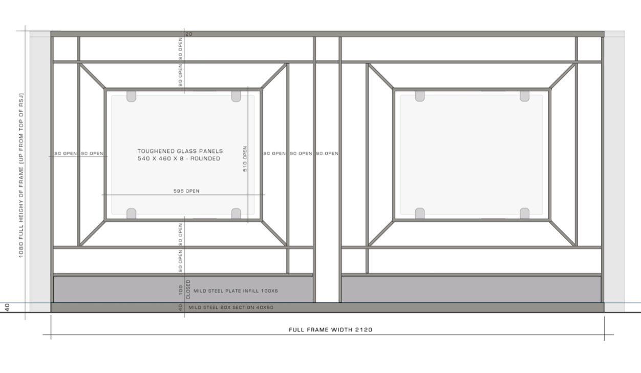

I've been asked to make some railings amongst other stuff that was originally specced as mostly 40x5mm flat bar, no problem.
Spec has now changed to 40x10mm. (Or possibly 8mm)
Pretty much entirely fillet welds.

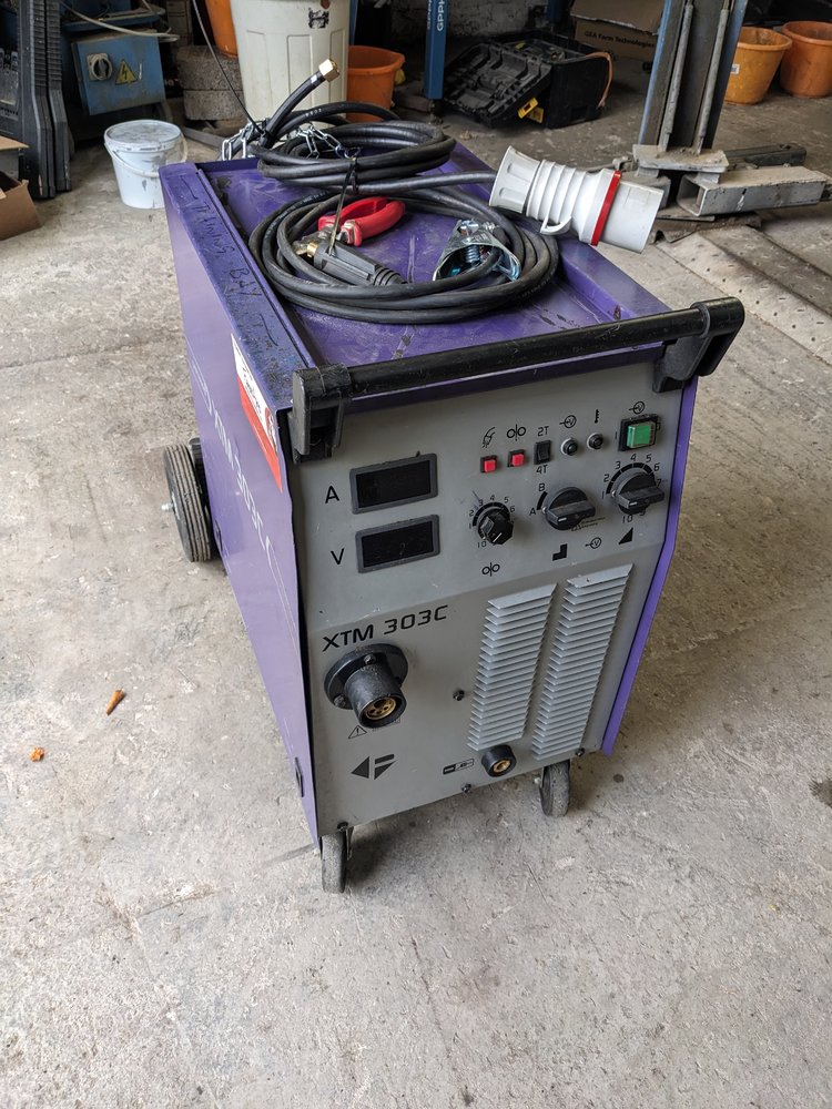

I currently have a 200amp inverter machine (thermal arc 211) which I feel is quite a bit on the small side, even with 1mm wire and heavy gas, even though the charts Inside say it's capable.
I'm thinking of picking up a 250/300 amp machine and selling it once I'm done, Is that overkill for one job? Should I just bevel everything and stick with what I have?
