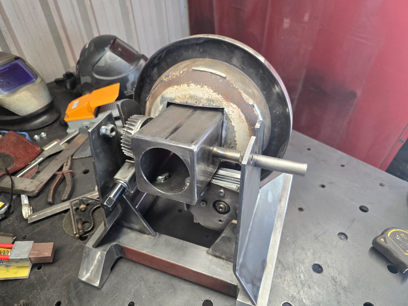

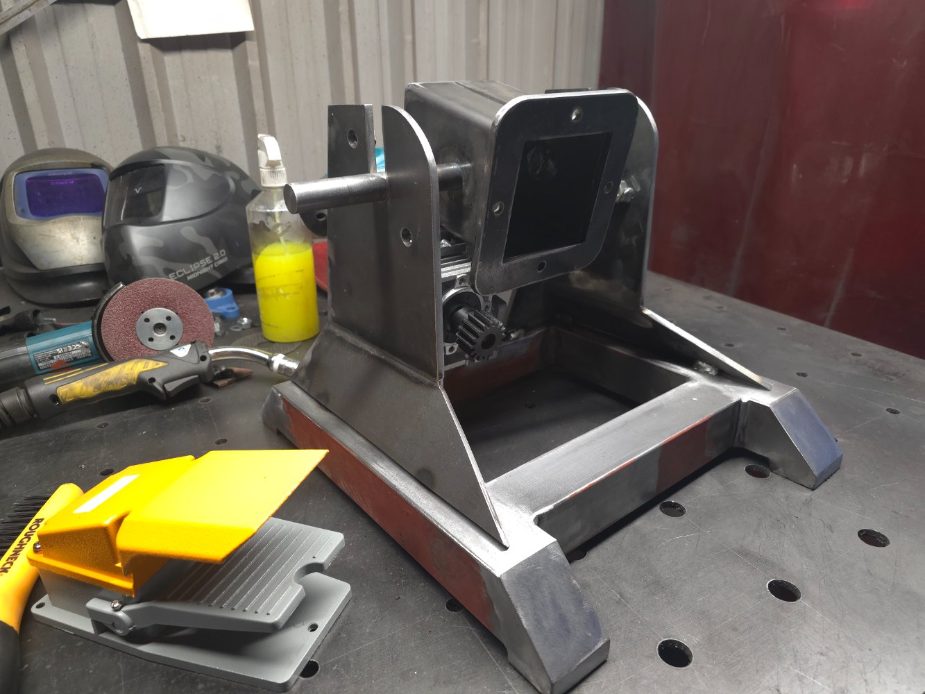

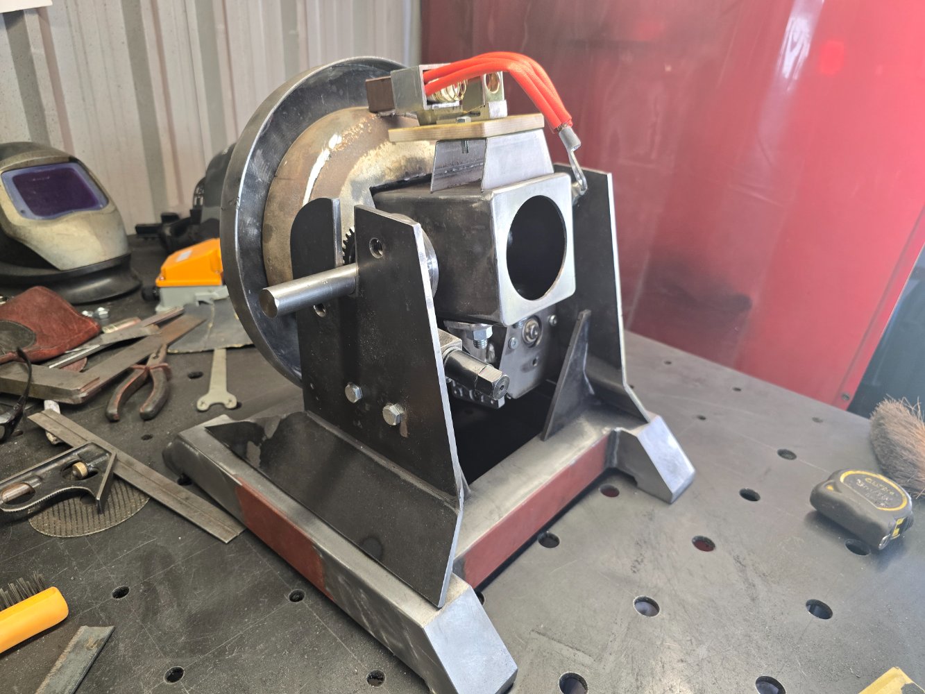

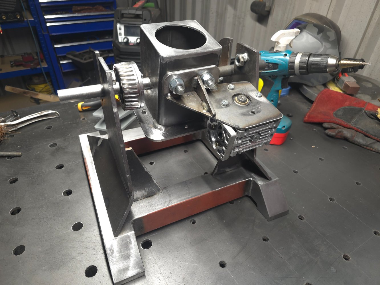

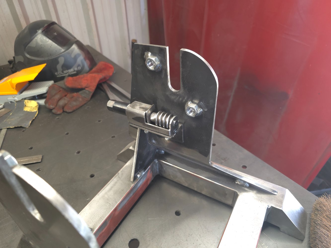

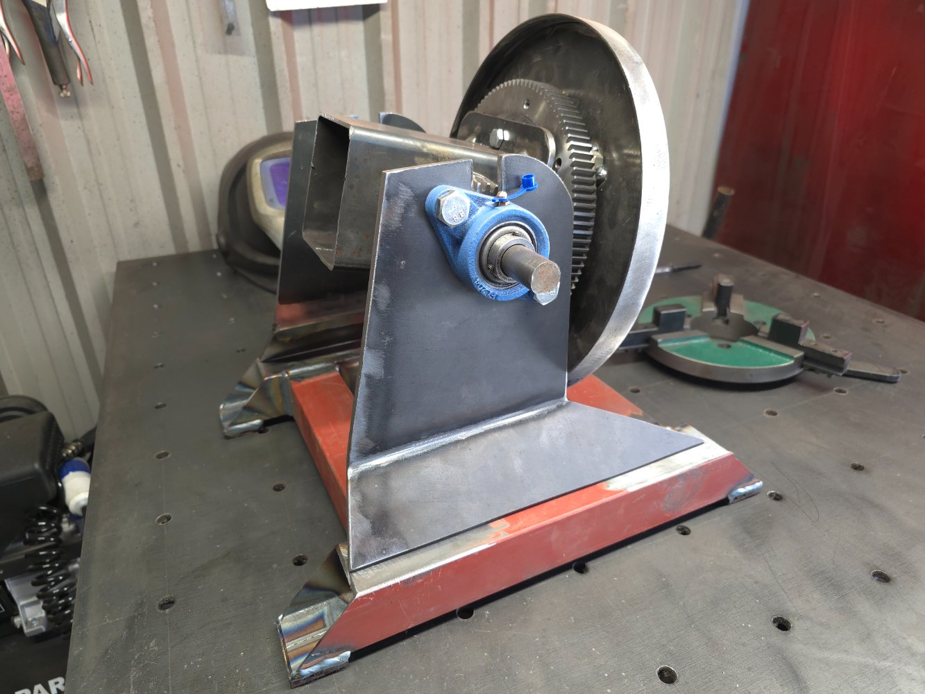

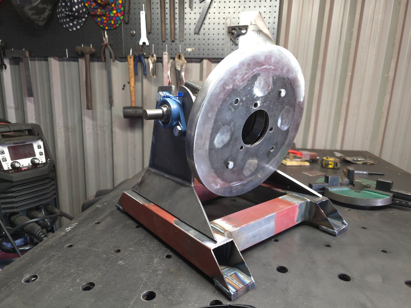

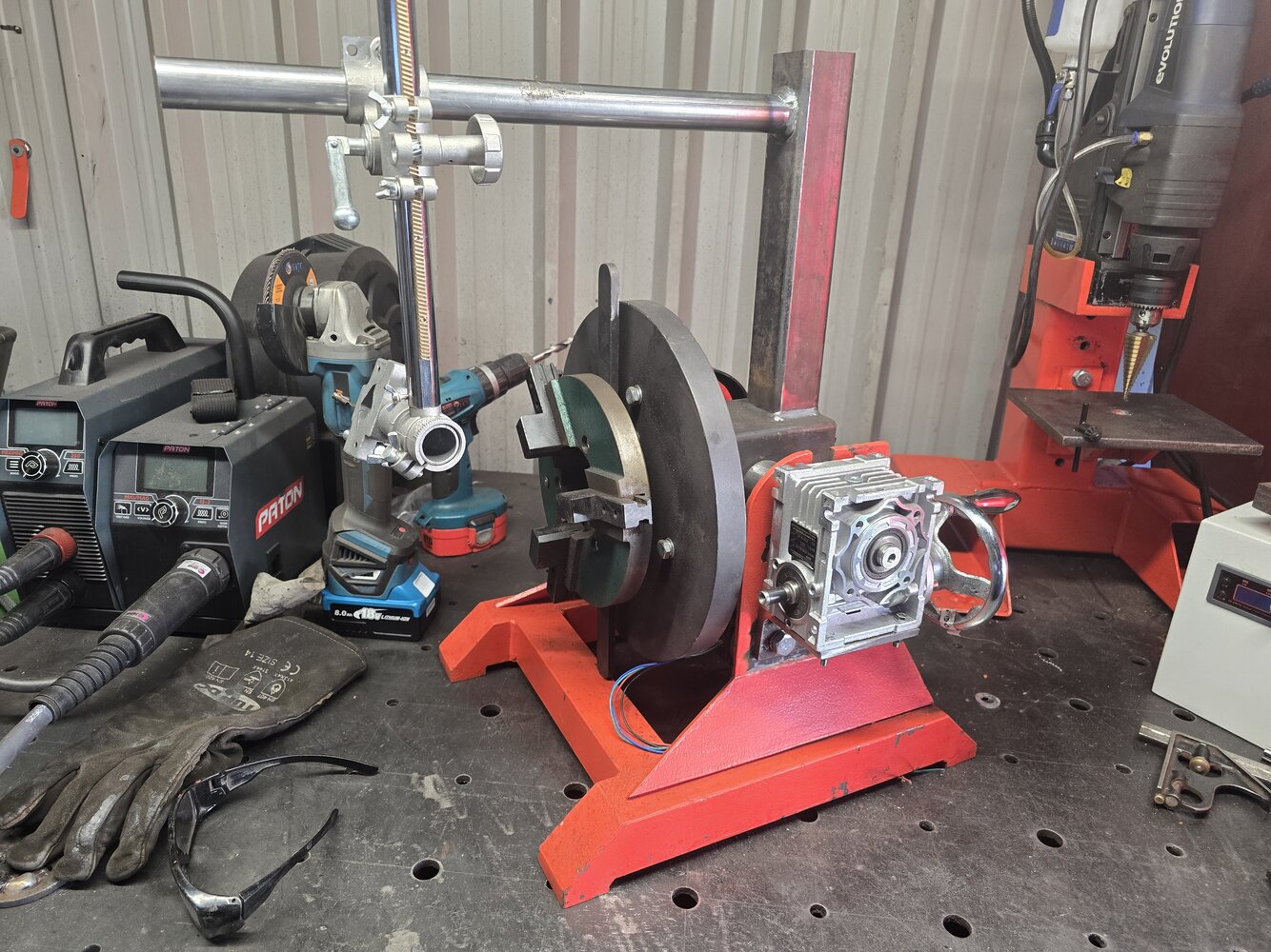

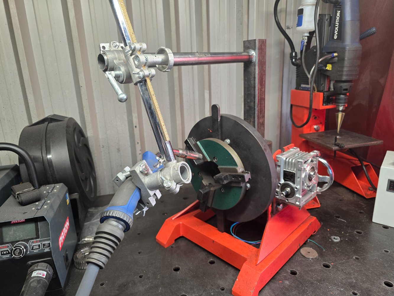

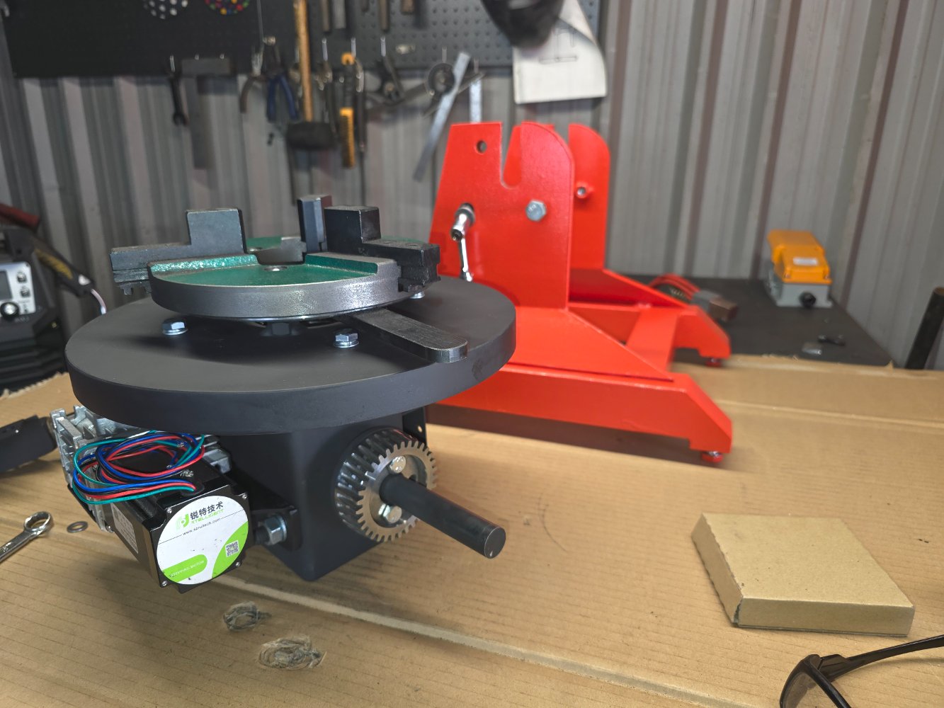

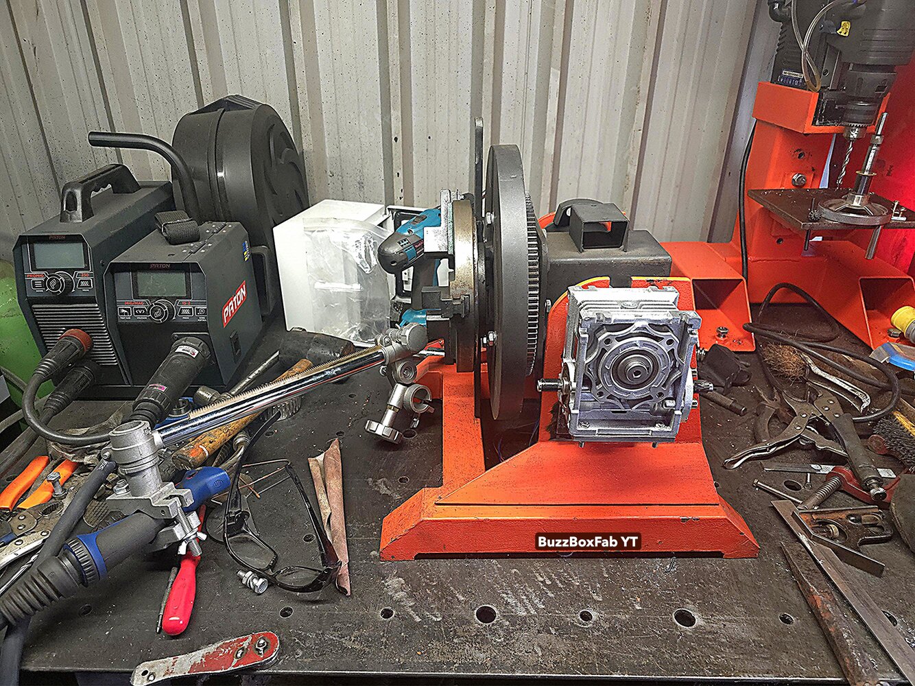

I've been knocking up a welding positioner,its not pretty,I'm still undecided on whether to go with the worm gear on the side for positioning or..if i use it then i wont need those bearing blocks in the image as the shaft would need to be fixed, Or i could just manually position it and lock it off doing away with the worm gear so that's where i am.
Feel free to throw up anything you've made or maybe you use a commercial job.
