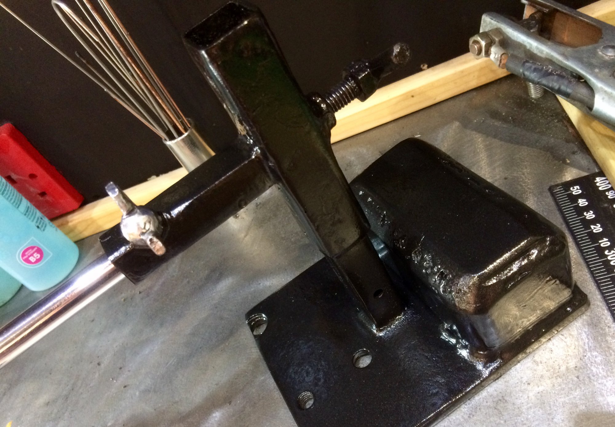

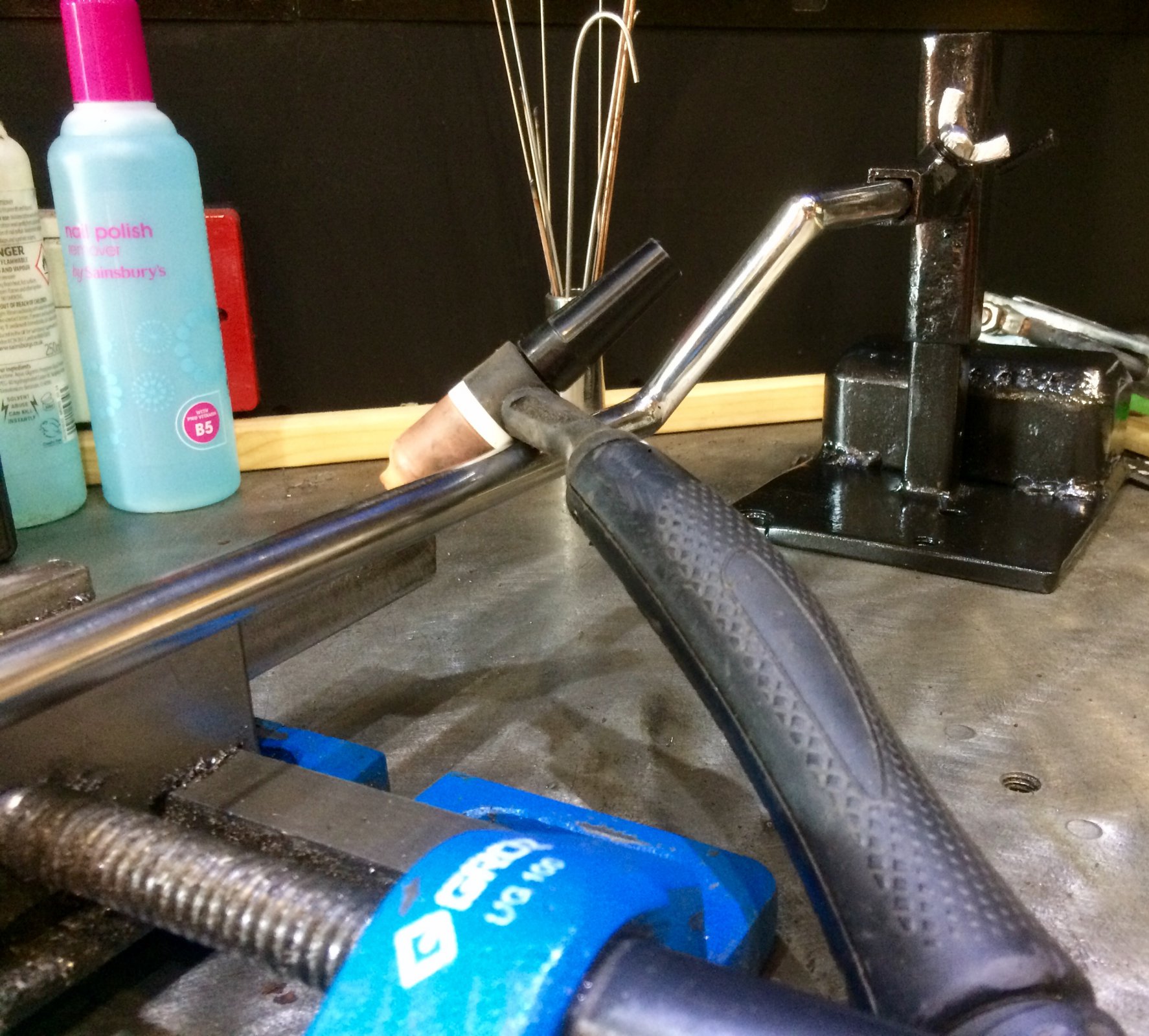

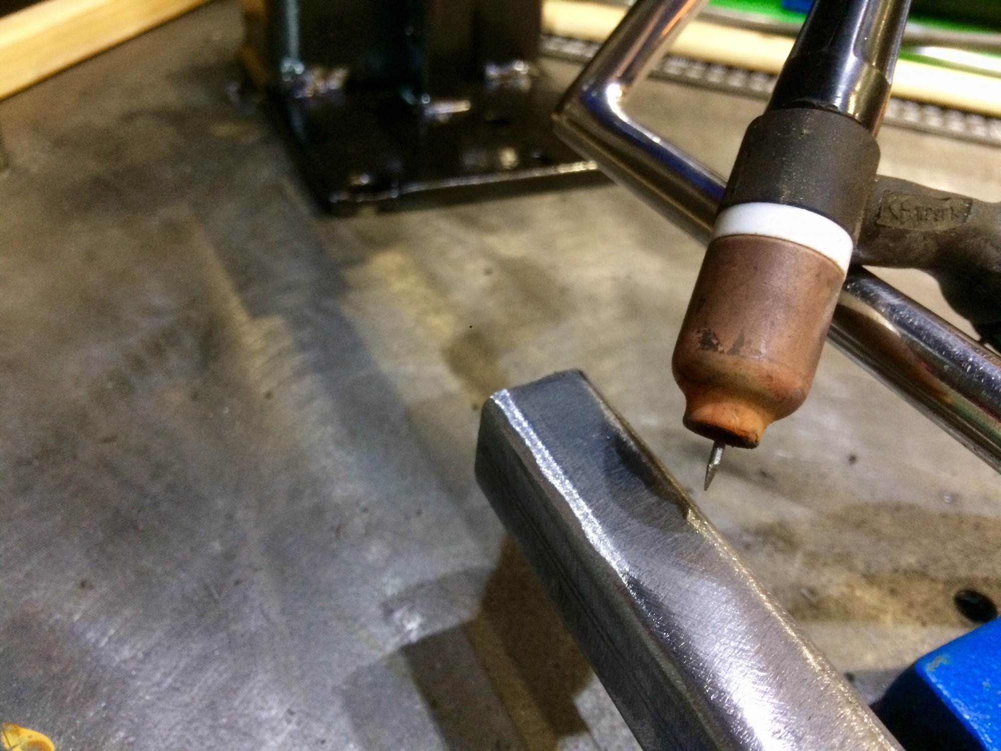

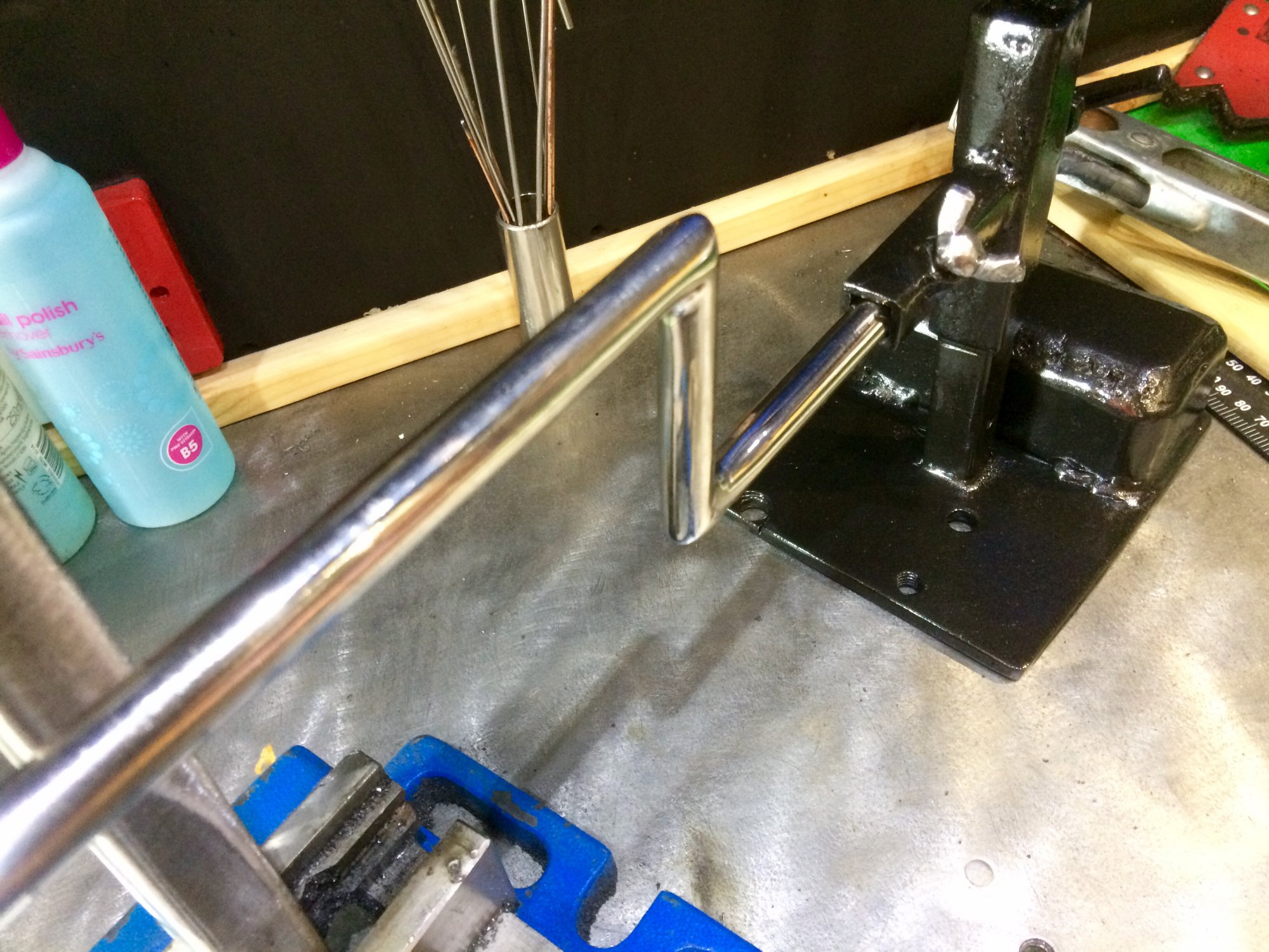

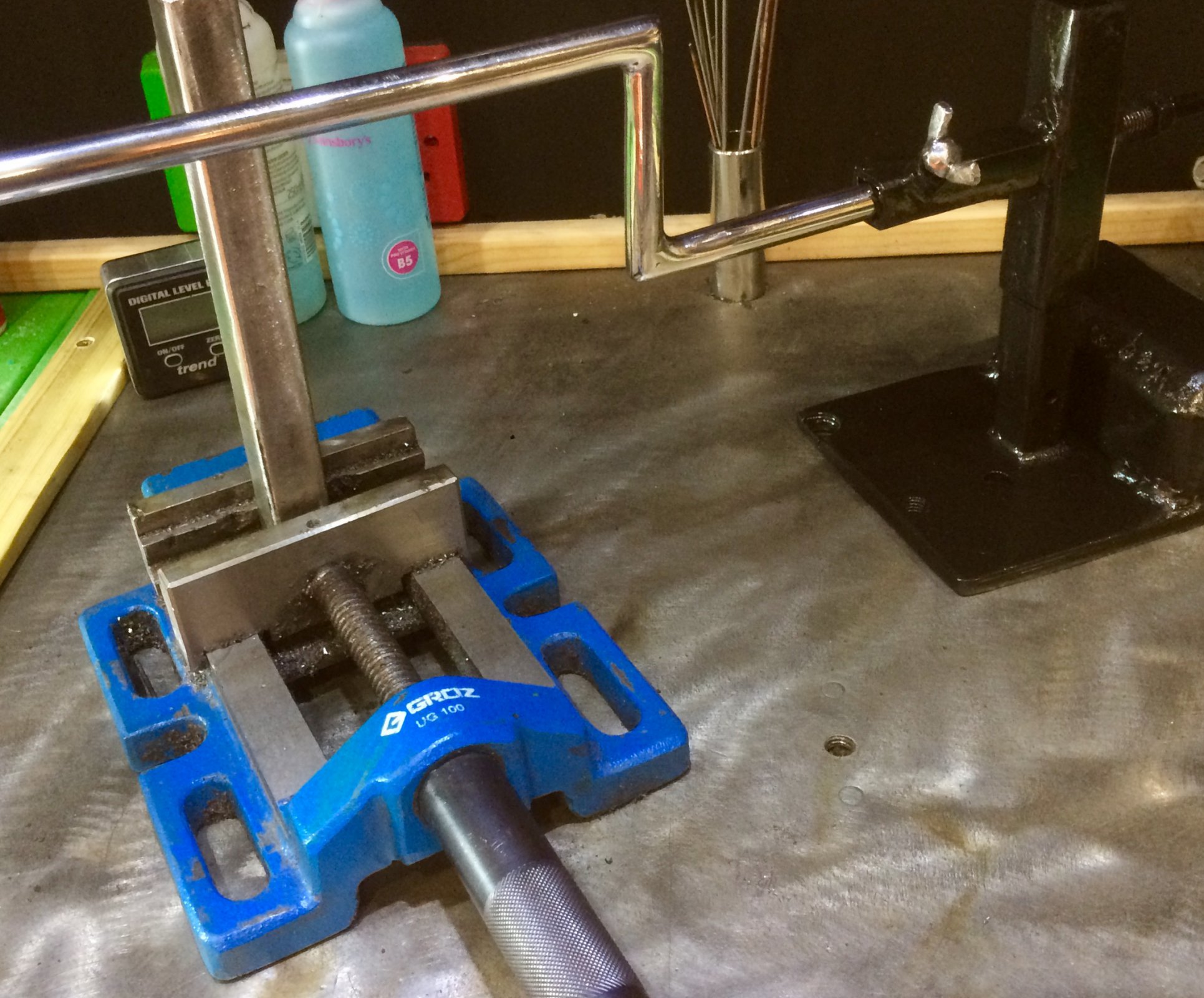

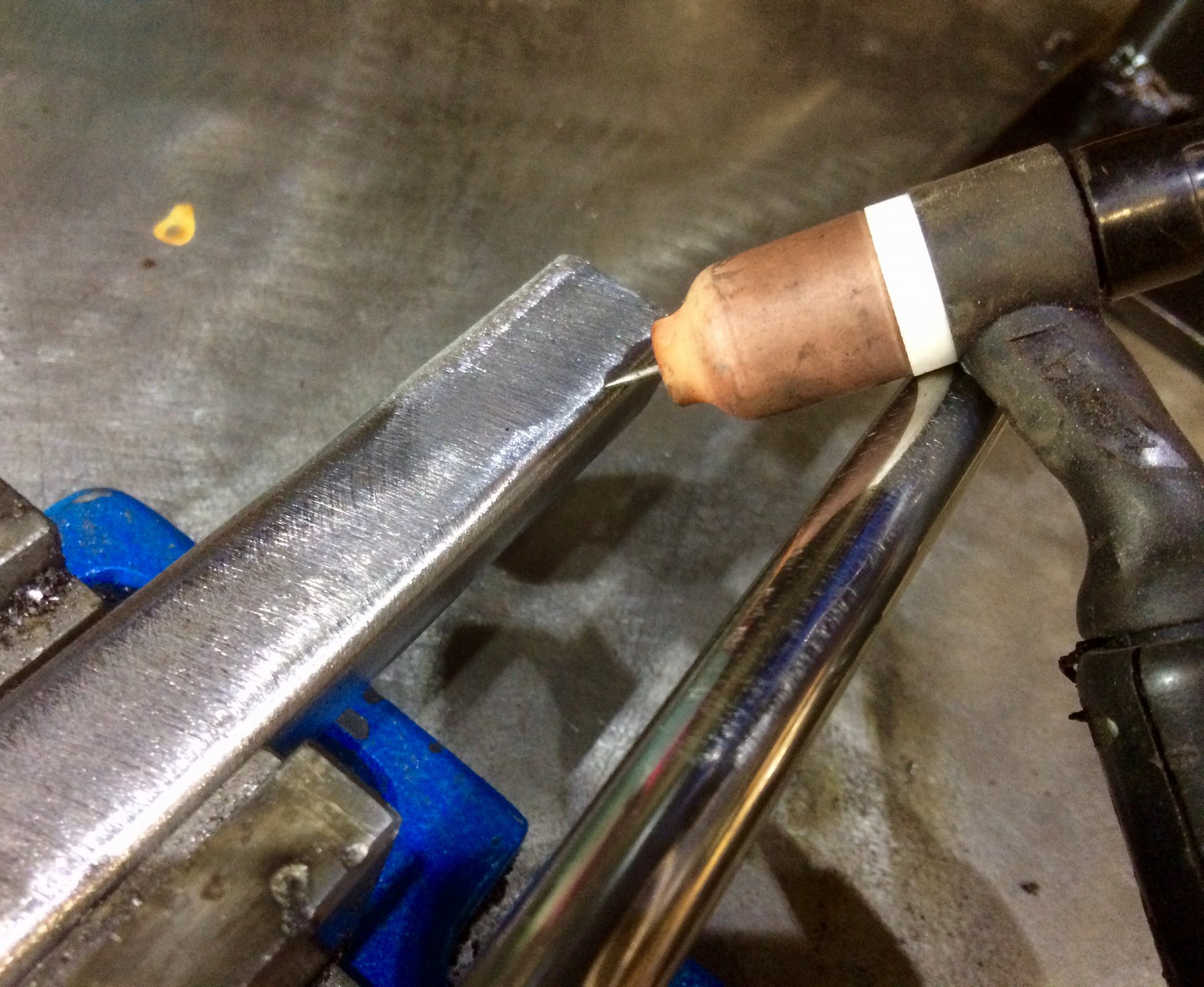

DIY Tig torch adjustable rest/slide project to help me with my shakey torch hand.. the ss arm can be rotated and locked in any position around 360 degrees..
Column adj height wise .. wing nut pinch bolt locks ss armrest..
Arm set in its 12 pm position
SS adj arm to rest and slide torch ..
Counterbalance weight filled with concrete on right of pic...
