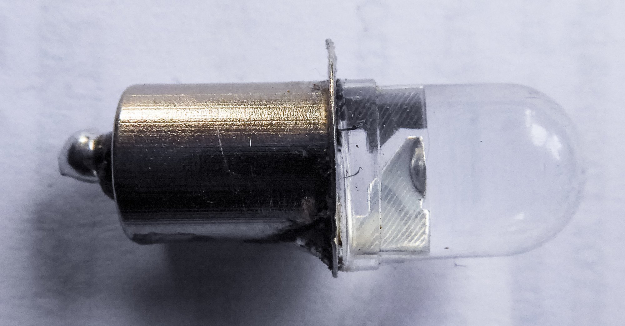

Following up a thread (a while ago) on the forum about fixing LEDs to your welding mask to brighten up the workpiece, I bought a bag of 10mm top hat LED's off the bay (cheap as chips for a bag of 50). Having converted the helmet I was left with 46 & wondered what else I could use them for.
I managed to score a heap of browny points from her indoors by putting 8 round her make up mirror (she was always complaining that the lighting in the bedroom was too dim),but I was still left wondering what I could do with the rest.
Then it dawned on me the LED's were similar in size to glass part of the old pre-focus bulbs, so I tried converting one & it proved remarkably easy (see photo above). The pre focus bulb has a slit down the side & this mates beautifully with the flat portion of the LED lead, the other goes straight to bottom of the case, a drop of solder & it's all done. The LED's are 3V so ideal for a 2 cell torch.
