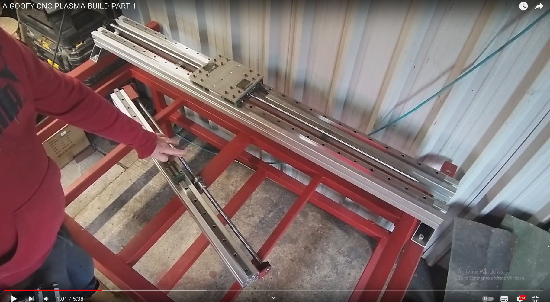

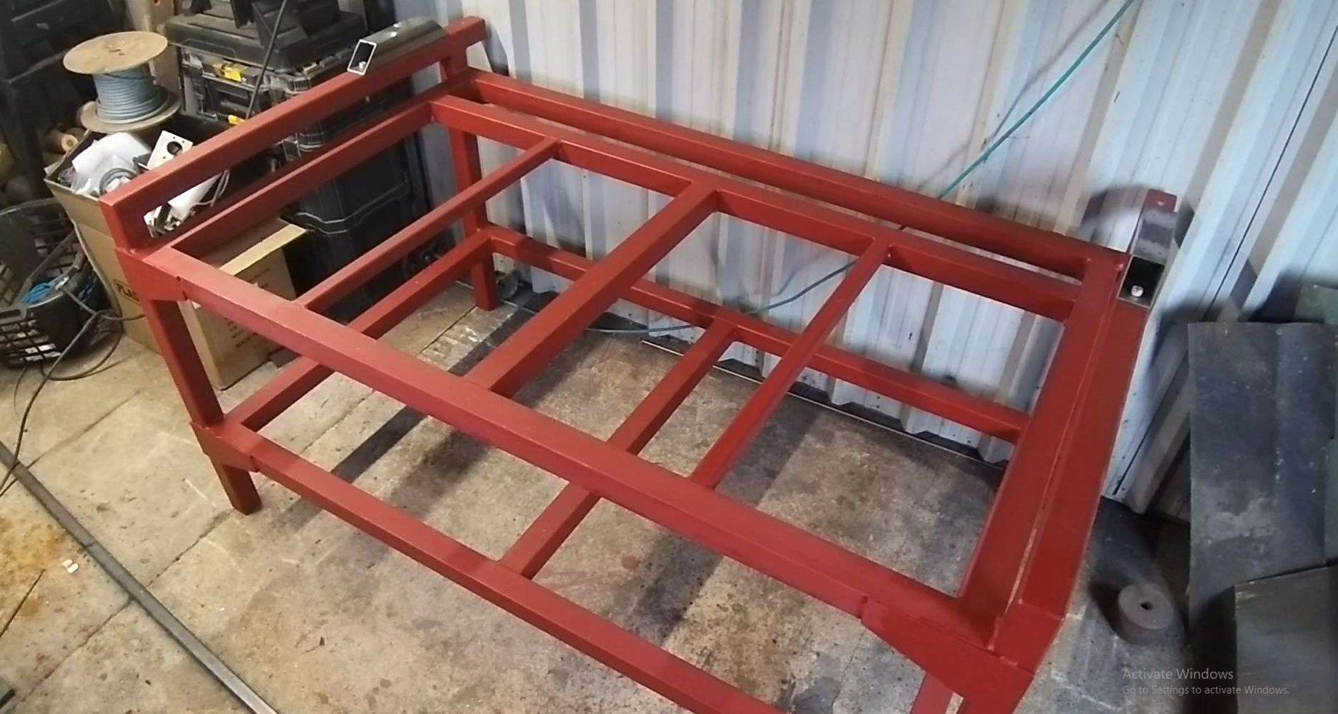

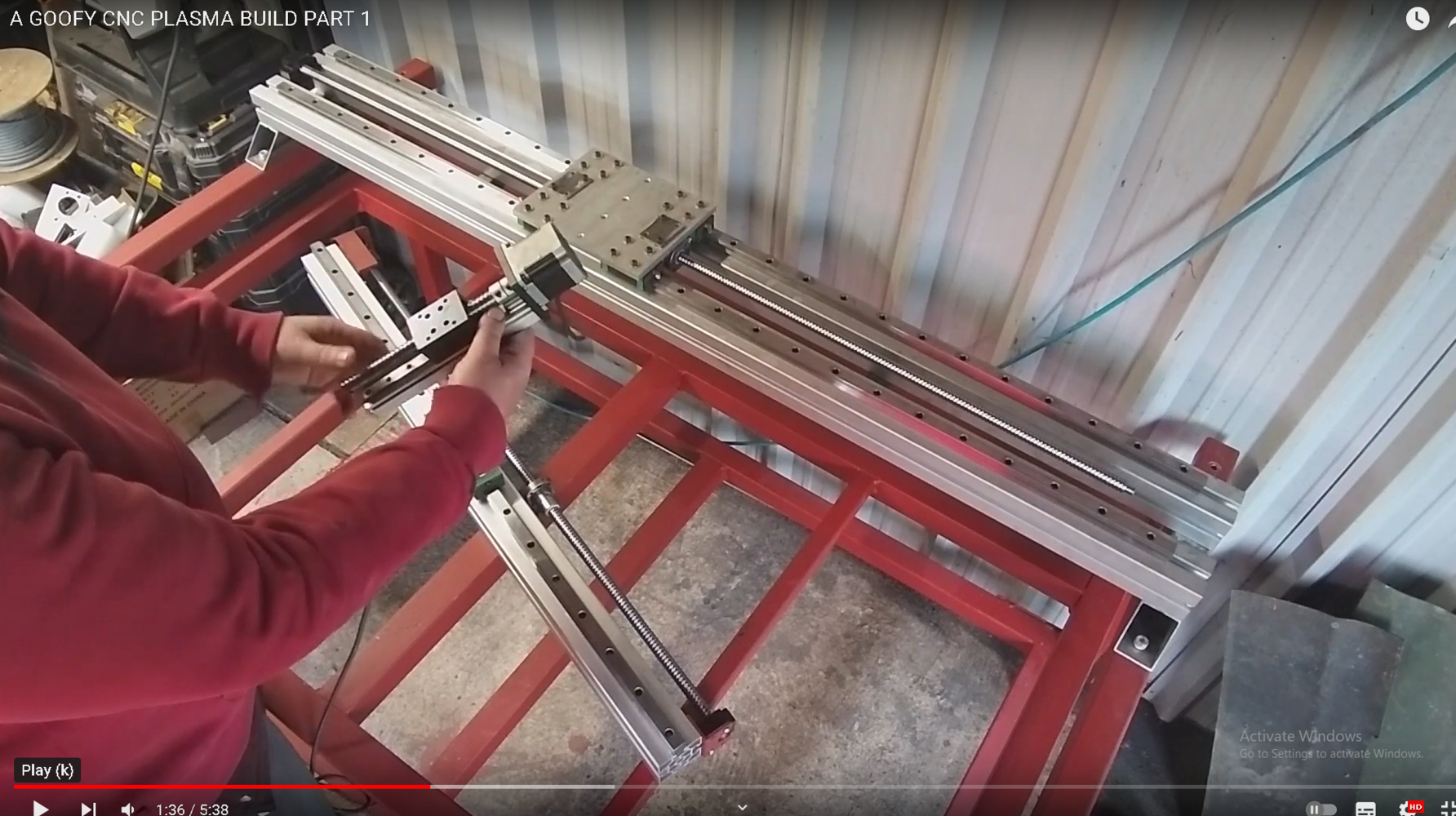

I know what you mean pal..i accumulated the parts over time.. jumping on deals etc as i find them.Something I've always wanted but can't justify the outlay
Same here to be totally honest.Something I've always wanted but can't justify the outlay
You are right..i did know that rack pinion was the better method,i see so many small builds running screws and think i would be happy with those cuts...that performance etc.just my two cents worth.
Why ball screw for the drive?
Depending on the plasma power and the sheet thickness, speed is an important factor to get good cuts. Getting speed on ball screws you can get whip once the rpm gets up. Rack and pinion is the much better method, just saying. Anyway that is my view, good building![]()
Nothing daft about it, they seem to work well by all accounts i just didn't consider themDaft question (maybe) why not belt drive?
The one think that might possibly go against belt is sparks might cause issues.Daft question (maybe) why not belt drive?
Sparks aren't any more of a problem for belts, than general plasma dust is for any transmissions system.The one think that might possibly go against belt is sparks might cause issues.
That's pure speculation by the way.
