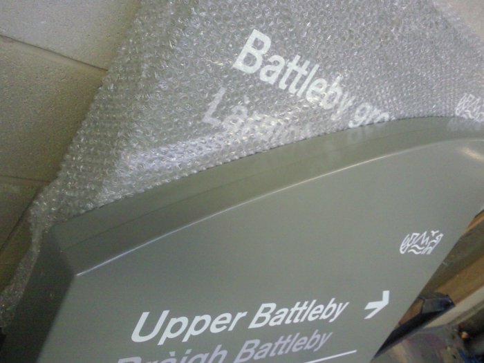

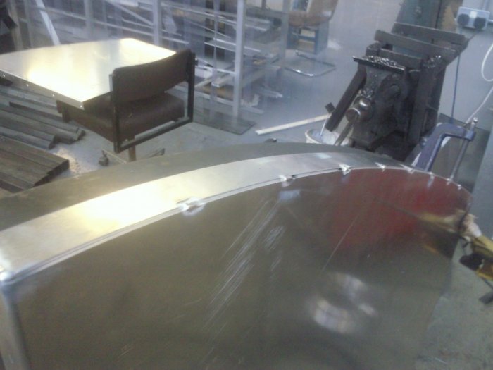

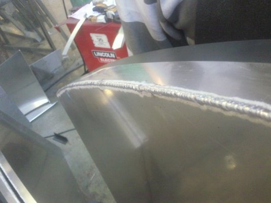

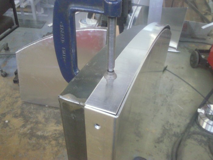

hi all. ive been fabricating aluminium trays to go back to back on steel frames but been having problems getting a smooth finish. the ally is 2.5mm thick and ive been tig welding them on about 70-75 amps then dressing the welds with a 4.5 inch 60 grain flapdisc then a 120 grain disc and smothing off with a palm sander first with p80 paper then p360 wet and dry. they look good until they come out of the spray room. they have a rippling effect where i tacked the top in place before doing the full run. any sugestions would be appreciated.
