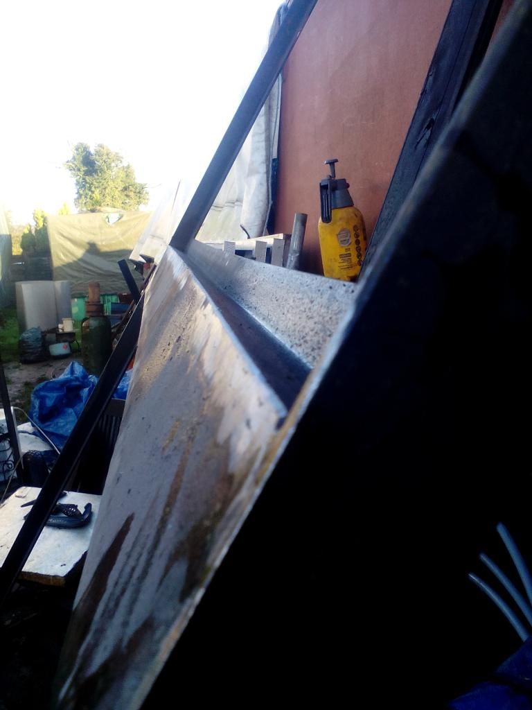

Bet it was straight before it was welded up![]()

Depends, will she hit you or the steel firstYeah, it was straight before I welded it. Its all my known fault. I thought tacked up to the angles it would not go anywhere, but it took the angles with it.
I've got a 1.5 t chain puller, propane roofing torch, oxy/ propane cutting torch, bottle jacks .
The sledge hammer will be first though.

Stitch weld where ever you can with thin flimsy things.
I dunno, is it just me or is 4mm steel not what you'd call 'thin' or flimsy'...?
I guess if you weld RSJs together all day then maybe it is![]()
