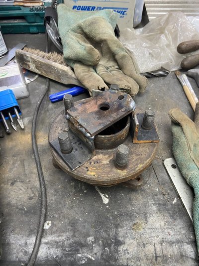

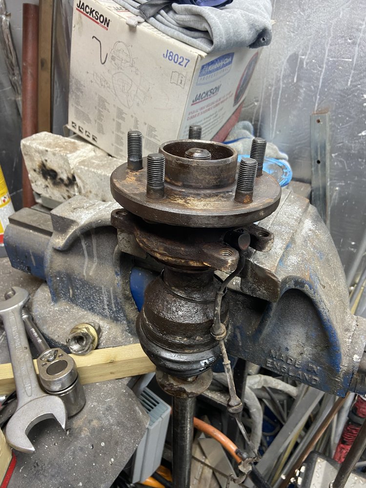

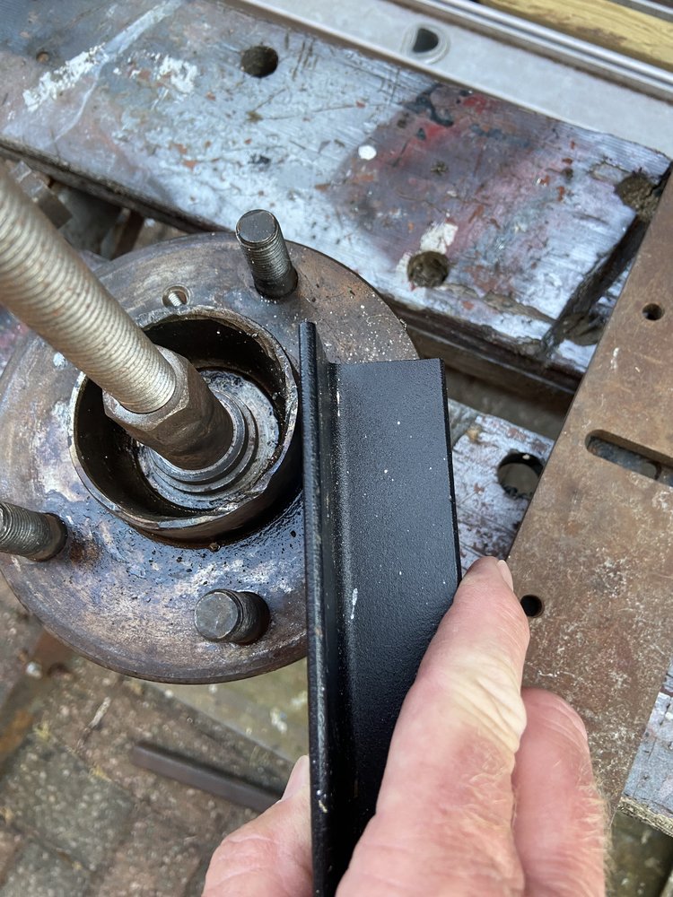

Typically with days to go before showing the landy at the local beer, erm steam rally, the left front hub decided its bearings would collapse, to be fair, its the original hub and abs sensor so its done its job. The only problem arose when trying to remove the hub from the driveshaft. I knew it was going to be tight, and didnt have a puller. Tried a tap with the hammer and no chance, so soak with penetrating fluid and off to the local garage to get it on the press. “Never done one of them, dont have a puller (translation, I do have a puller but know what a pig they are), take it to heath (local landrover bloke). “ Heath was on holiday

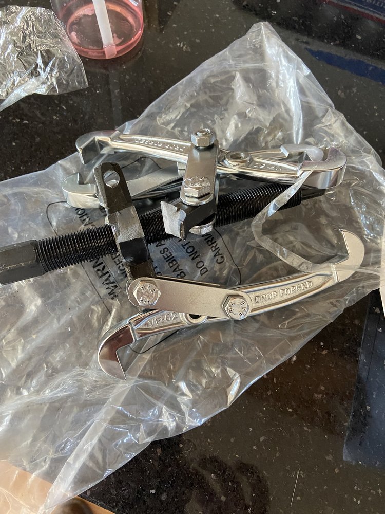

Gaztube was suggesting a gear puller, so ordered one from screwfix, took one look at it, and decided the black cast monkey metal was going to snap like a carrot, which it did. Eventually got it off by braying it out with the hub nut on and a bfh, but it was touch and go whether i had damaged the threads .

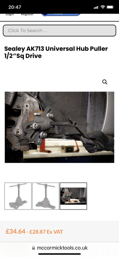

So the other side is due for doing. Has anyone had success with the sealey universal hub pullers, are they universal (except a disco) ?

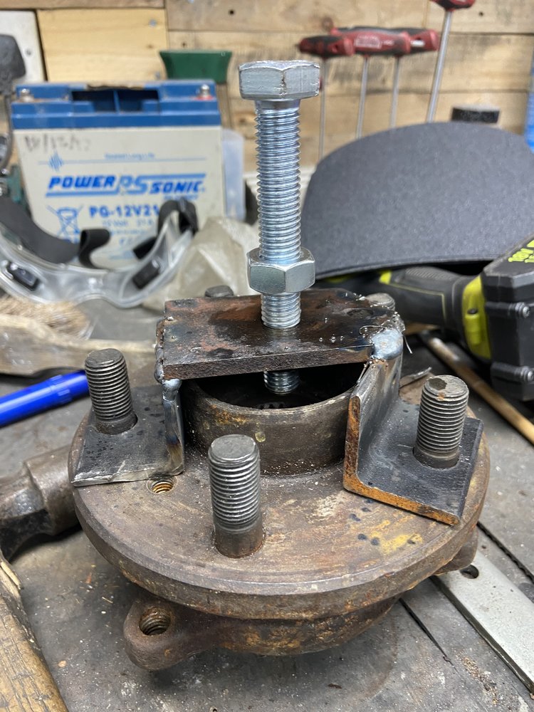

Or do I fab one up. I have a brake caliper winding tool, Im thinking 3 angle uprights held on by the wheel nuts, welded to a top plate which will take the caliper winding tool.
Or has anyone a better design
should have tigged it really but its been the best part of a good few years since any of the welders were out, the later underneath welds were better
