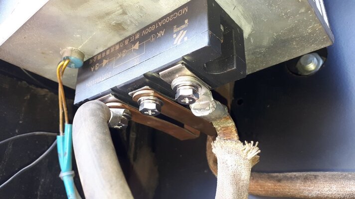

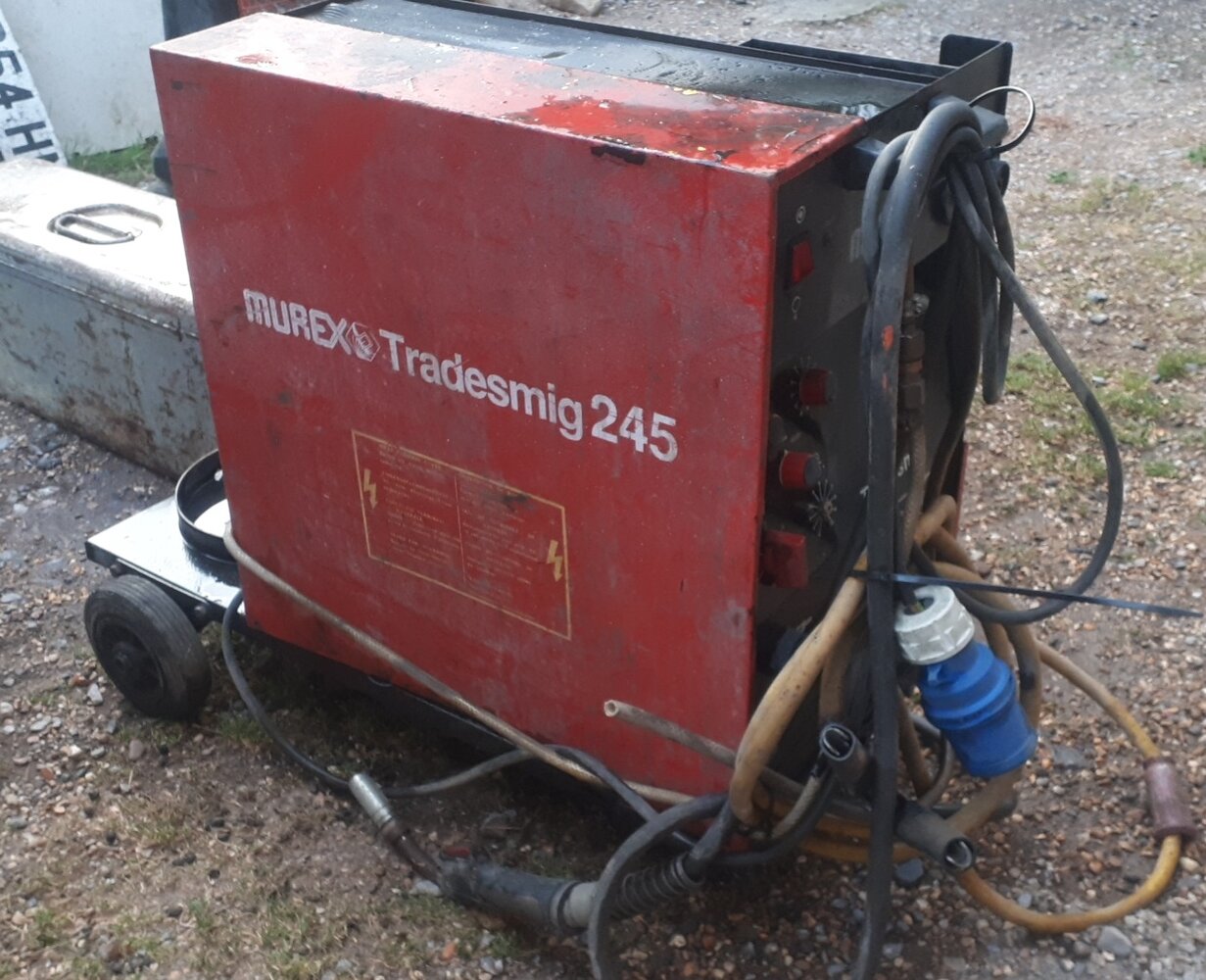

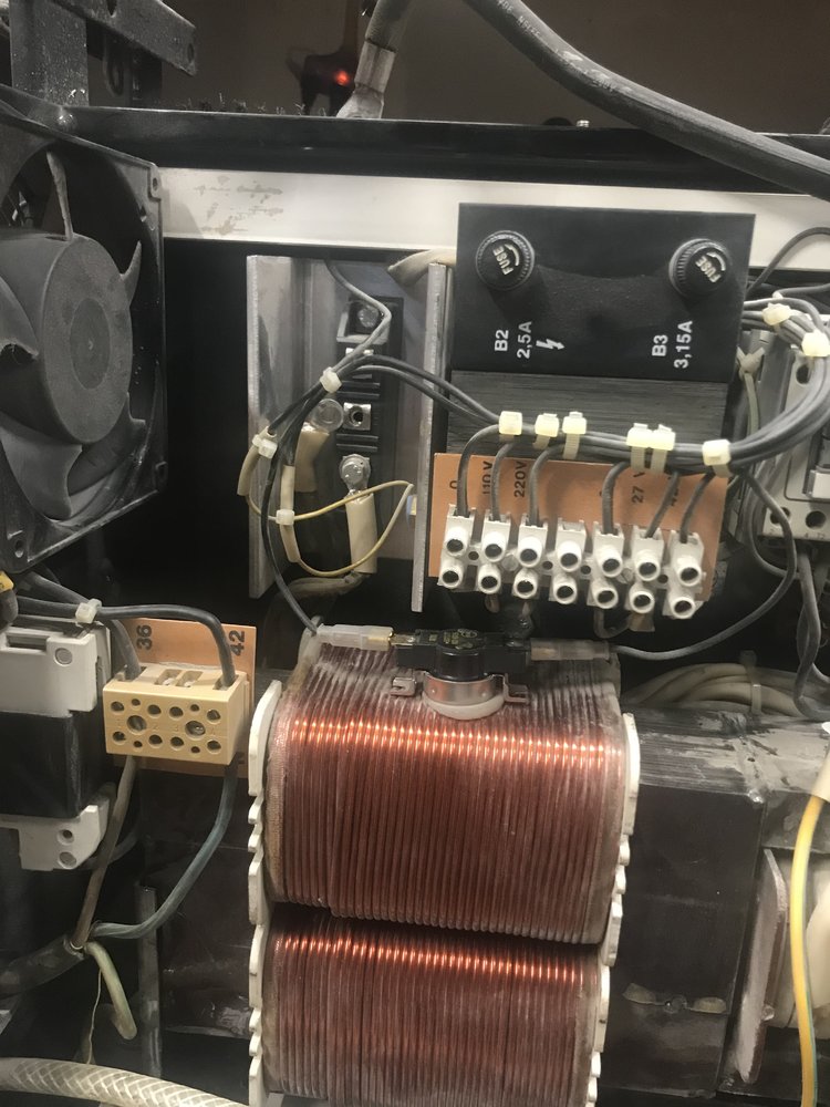

I bought this nice old Murex at a local farm auction supposedly working , but it plainly isn't. There's no voltage at the torch. (Wire feed runs)

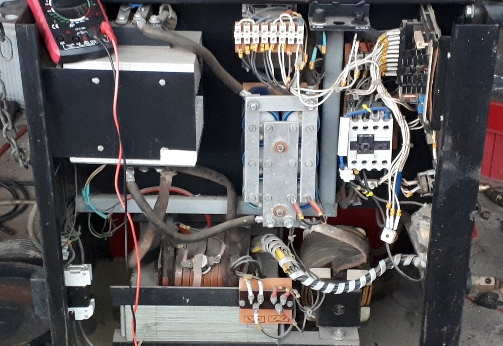

Transformer seems ok, so I unbolted the main diode blocks (2 diodes in each) and tested them . The top one checks out ok with 300mv on each diode in one direction only but the bottom one is open circuit.

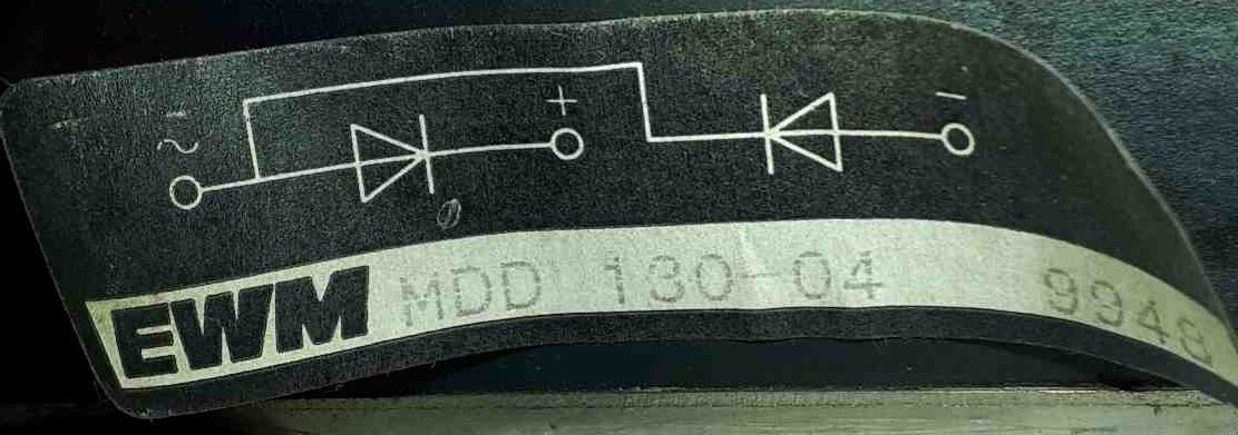

Does anyone have a new or used spare diode block? The part number seems to be MDD 130-04 9948 only similar looking EWM diode on ebay has a different internal layout looking at the diagrams on them. Hoping someone can help, I would imagine many machines used these diodes. Thanks.
