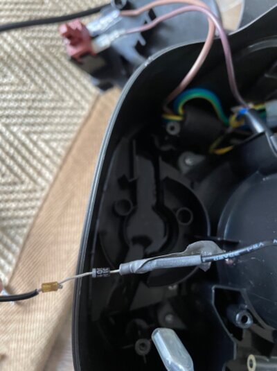

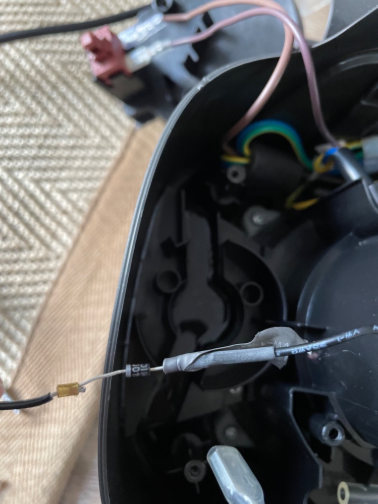

Voltage to the water pump before the diode is 230v voltage after the diode is only 139v, way under.

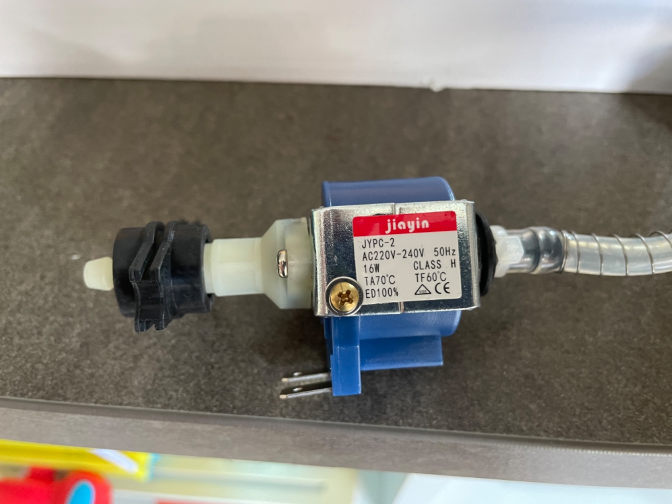

The pump was quite hot. Tried it direct to a 230v supply, it sounds like it’s pumping but failing to move water.
Replacement pumps are available for a good price but don’t want to knacker the new one by sticking it on the end of a bad diode and it being under voltage.
Any ideas?
The pump
The diode, numbers read IN4007 MIC
