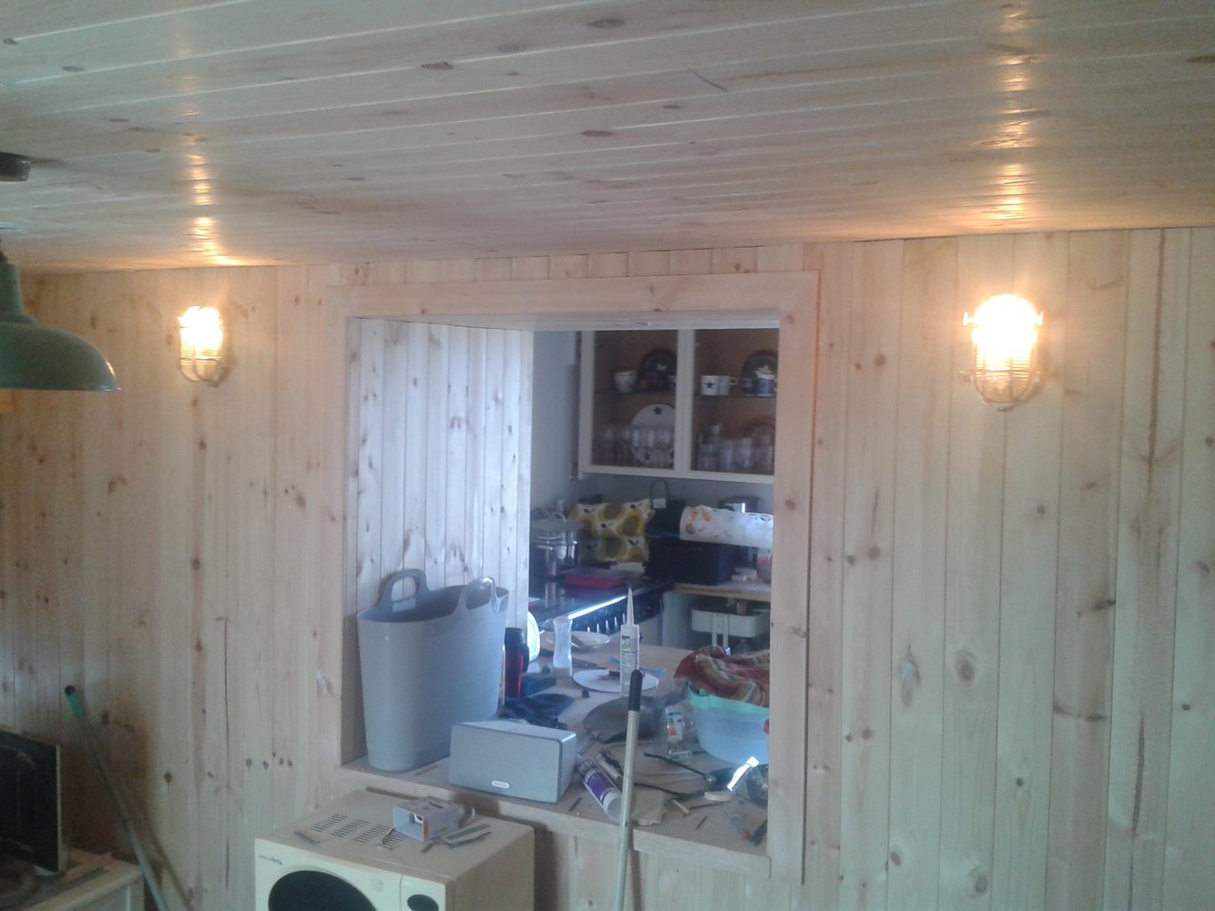

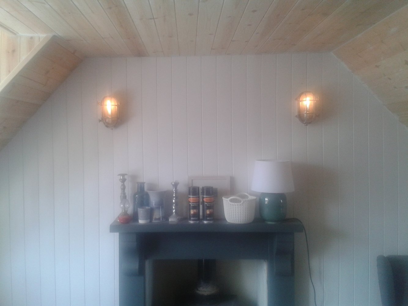

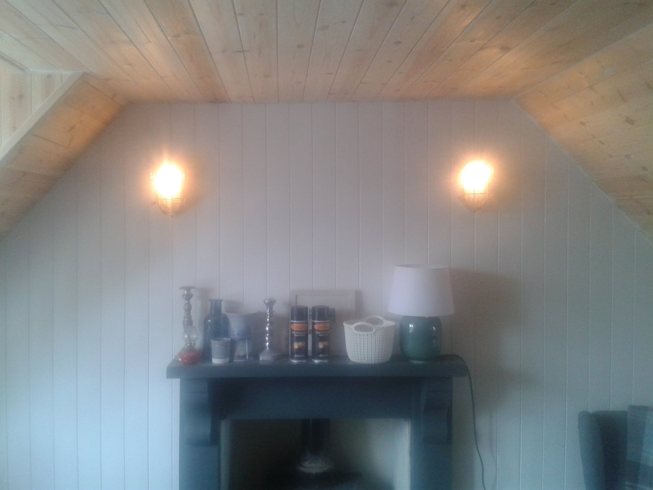

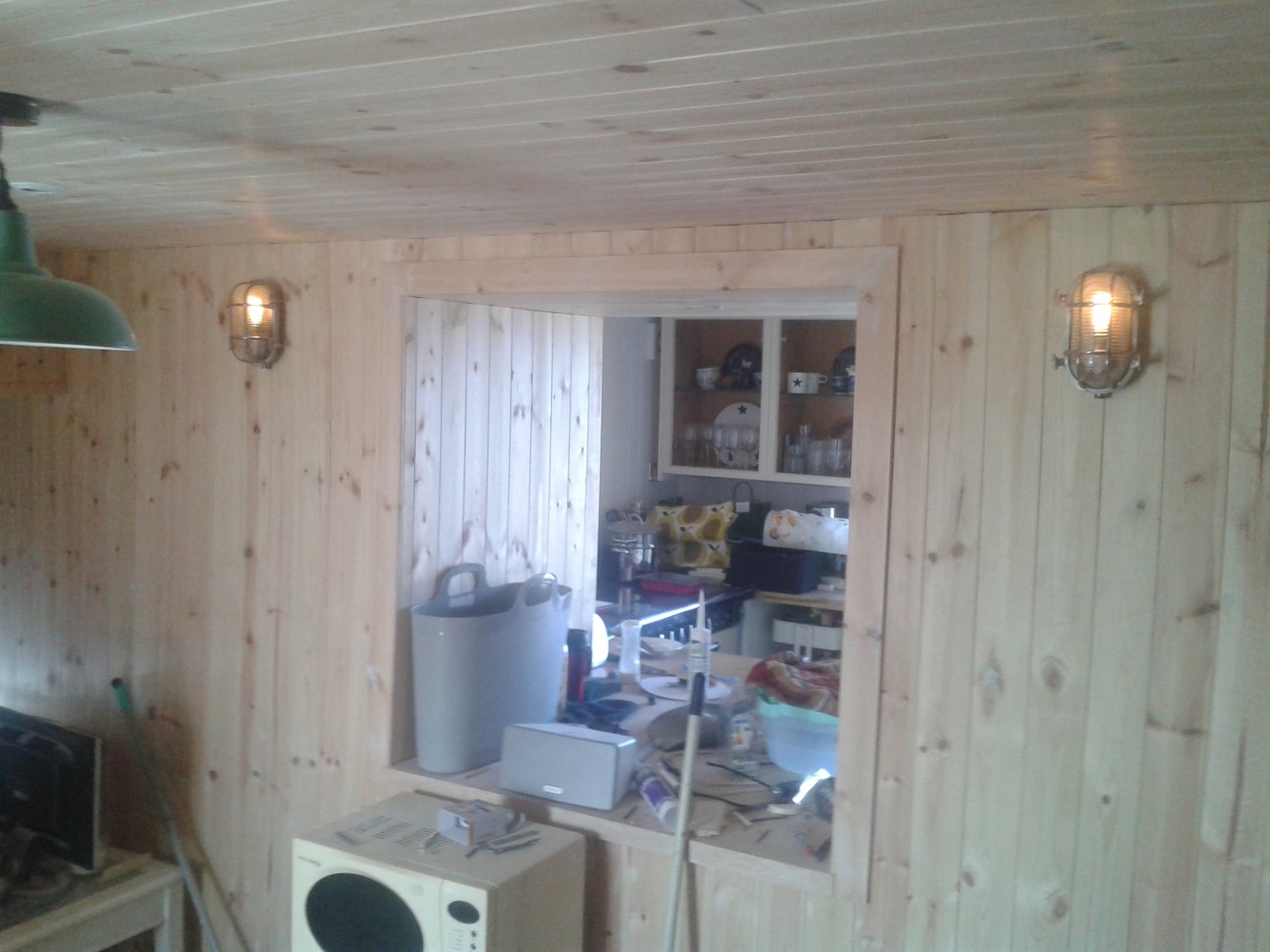

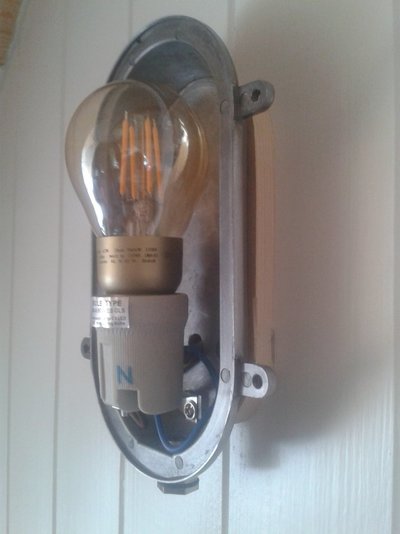

- i got a proper trailing edge dimmer for leds and they worked great even with all bulbs changed.
