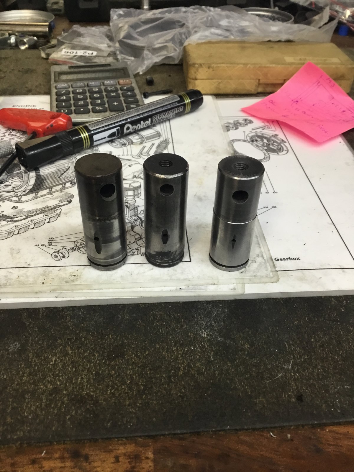

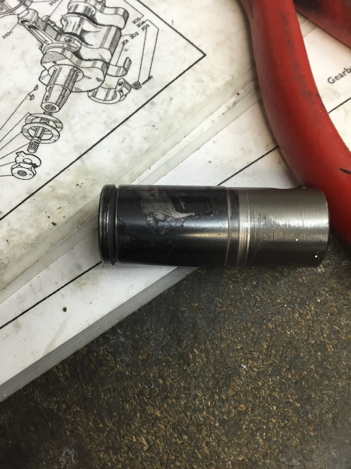

Bought some 19.05mm (measured at 19.07) silver steel. Heat treated - carrot hot>quench in water.
came out 19.05mm needed it to stay the same ie 19.07, so case hardened it. Blow me it shrinks again to 19.04.
so bought 19.50 silver steel, machined down to 19.10. Heat treated and its got f’in bigger 19.11
Arrrrrrh
What im i doing wrong
