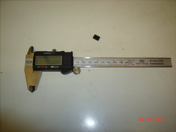

some time ago I bought one of the cheapo digital micrometers off ebay, and it worked OK for a while. Then the display started showing odd characters and the instructions said remove the battery for 30 seconds to reset it.
That didn't work, so I tried a new battery but that didn't work either. I decided that I could still use it as a manual device and bought another one.
Six months later the battery died in this one and they're a bit pricey on the high street, so I used that one as a manual micrometer for a while too. Then a few days back I noticed that RDG Tools on Ebay sells five button cells for £3-odd so I bought some.
New cell in the newer device, working OK. New cell in the first one, still showing a row of '8's so I decided to remove the digital bit and bin it...took the four screws out the back.
There's a bit of circuit board that contacts the metal, probably has a sensor in it, and I wiped my finger across it...the display cleared back to zero!
After reassembling the micrometer it's working perfectly. It probably picked up some grinding dust, or something. I always put it back in it's box so I don't know how that happened, but it's something to watch out for.
