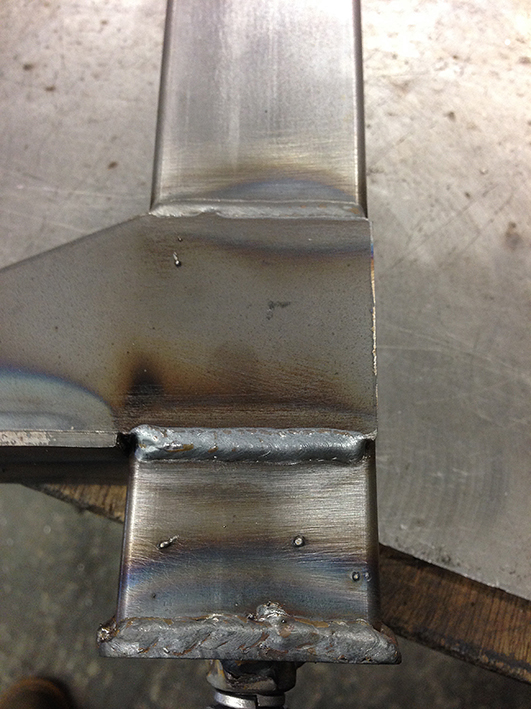

I've been using a mix gas for some time now, HobbyWeld 5 it's called, tri-mix.
Been having difficulty getting a decent sizzling sound form the arc, more of a loud crackling.
Ran out of gas yesterday and pulled out the reserve bottle of pub Co2, made some joints tonight and totally different - a smooth sizzling sound just as the videos show it. A fair bit of spatter but I expect that as i'm welding through mill scale on HR sheet.
The welds also stand a bit prouder but i think thats normal??
Was it a duff bottle of mix or is this normal??
I'll ask our team at the filling plant to put a few of our mixes through the gas analysers to be on the safe side.
