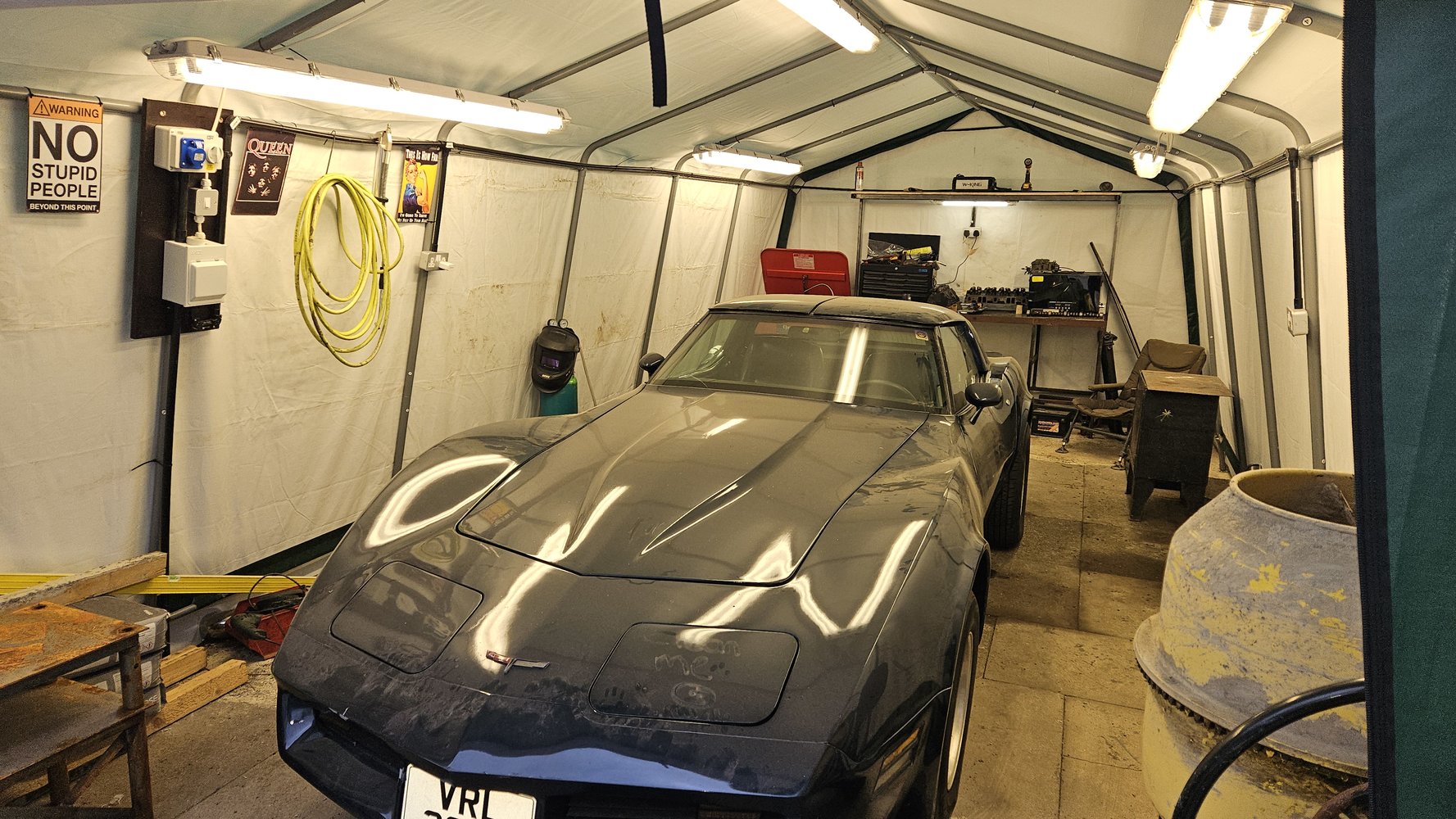

As in title a diesel heater. I am hoping to avoid a little condensation as I am fittimg vents all.around it.What type of space heater are you considering?
Oil
Gas
Electric
Note that using a gas or oil space heater in any garage and especially that one creates moisture which condensates on the car or metal surfaces rapidly.
An indirect heater such as a Chinese diesel heater in a masonry garage is a great option as this brunt fuel gas is sent outside.
Note also the Clarke garage is going to be very hard to heat and will have severe condensation. I know, I have one too! I normally run a dehumidifier inside it all winter and don't bother trying to heat it up I just avoid freezing days or don extra work wear.
Well spotted. And she did get a bollocking from me for doing it. For a time she was not a SWMBO.Whoever wrote 'clean me' on the headlamp cover needs their ar5e kicked for scratching the paint.
Vents will just waste all the heat your putting in. The moisture will be your biggest issue. Id suggest an infared heater next to you when working, and dehumidifier on all the time.As in title a diesel heater. I am hoping to avoid a little condensation as I am fittimg vents all.around it.
