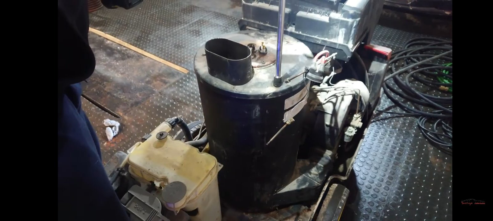

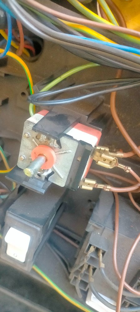

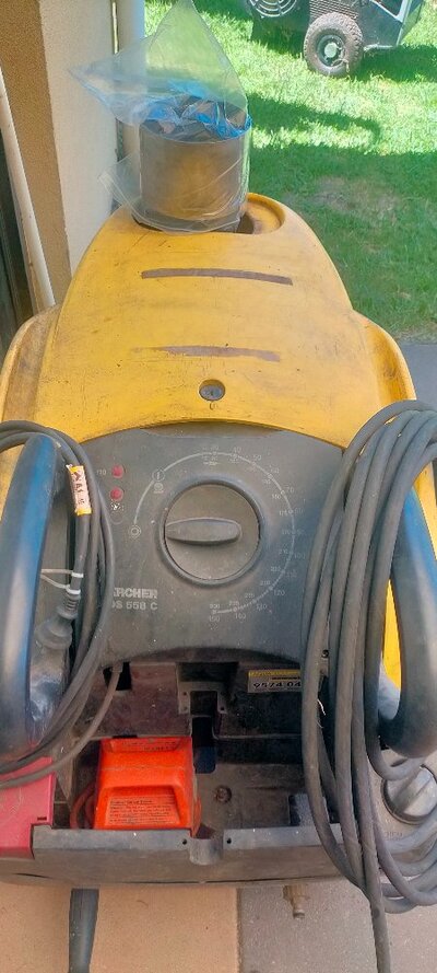

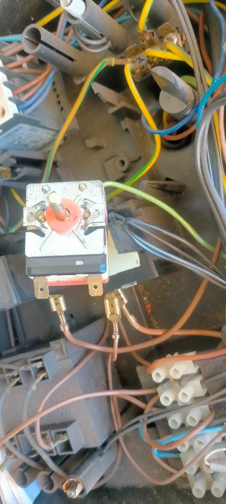

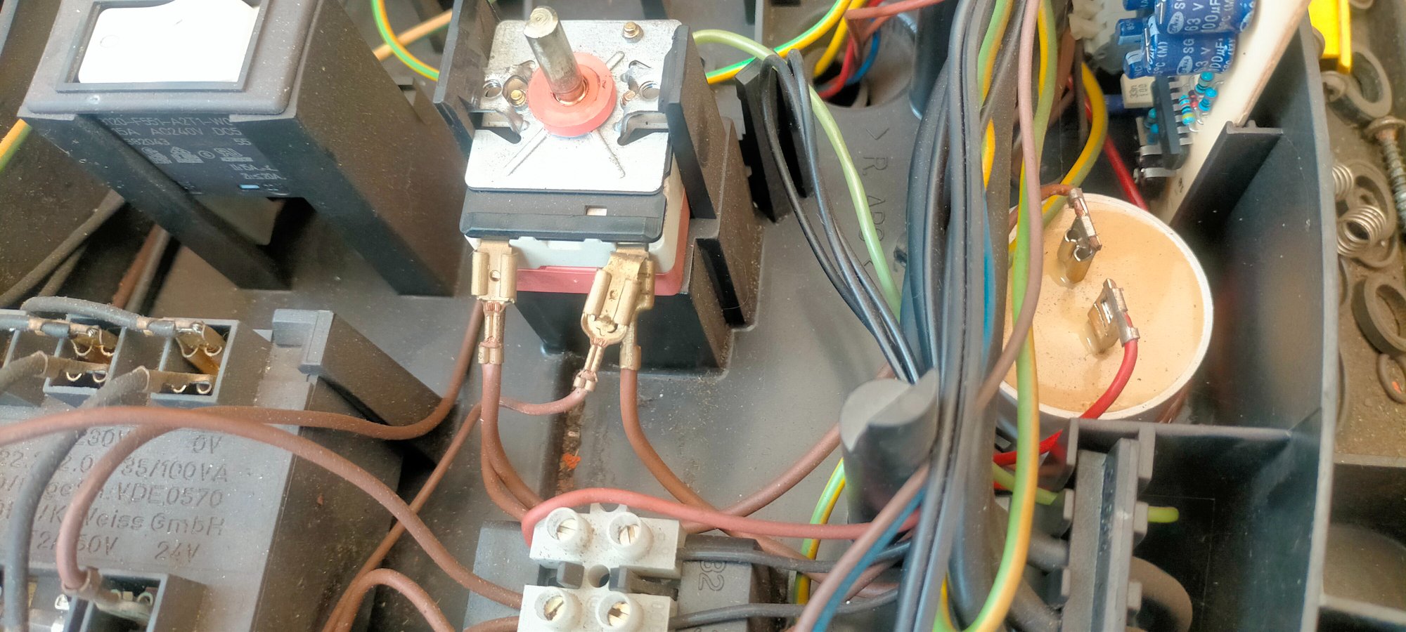

Calling any karcher specialists,
I have a HDS 558c, 240v with diesel burner, problem is it only runs on full heat and not cold, with burner always firing. I used to be able to regulate with temp control switch. Initially I thought thermo control switch which runs a wire with a bulb on the end that locates in a small pocket on the hot water pipe outlet. I did a test on this bulb with a heat gun and checked continuity of wiring, gently applying heat the control switch clicks and continuity stops which has me thinking it may not be this thermo switch.
Any suggestions appreciated before I outlay for a thermo switch.
