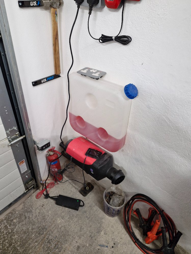

if poss I wouldnt store a plastic tank of fuel directly above the heat source ,,,, just in caseAnother diesel heater thread!!!!!

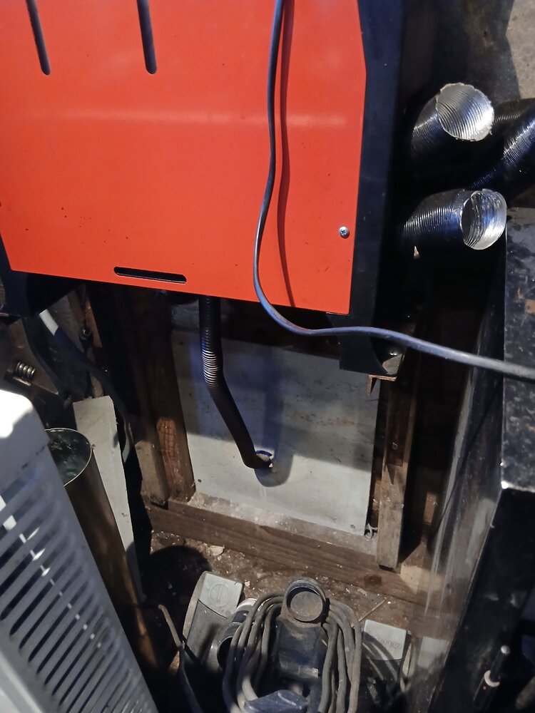

Inside IMO. Ensure the exhaust and Combustion Air inlet are both taken to outside.
(Work in progress but the concept of mine -)

Not a good idea to have that fuel tank there!.Another diesel heater thread!!!!!
