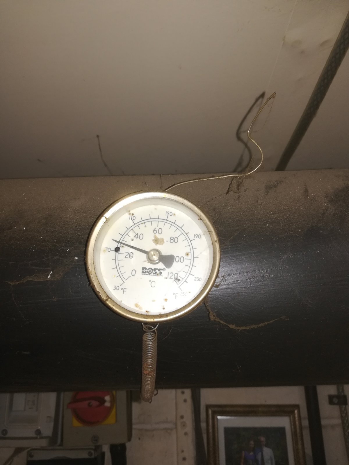

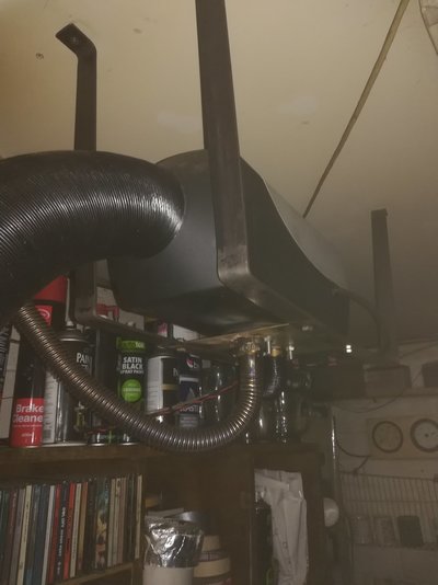

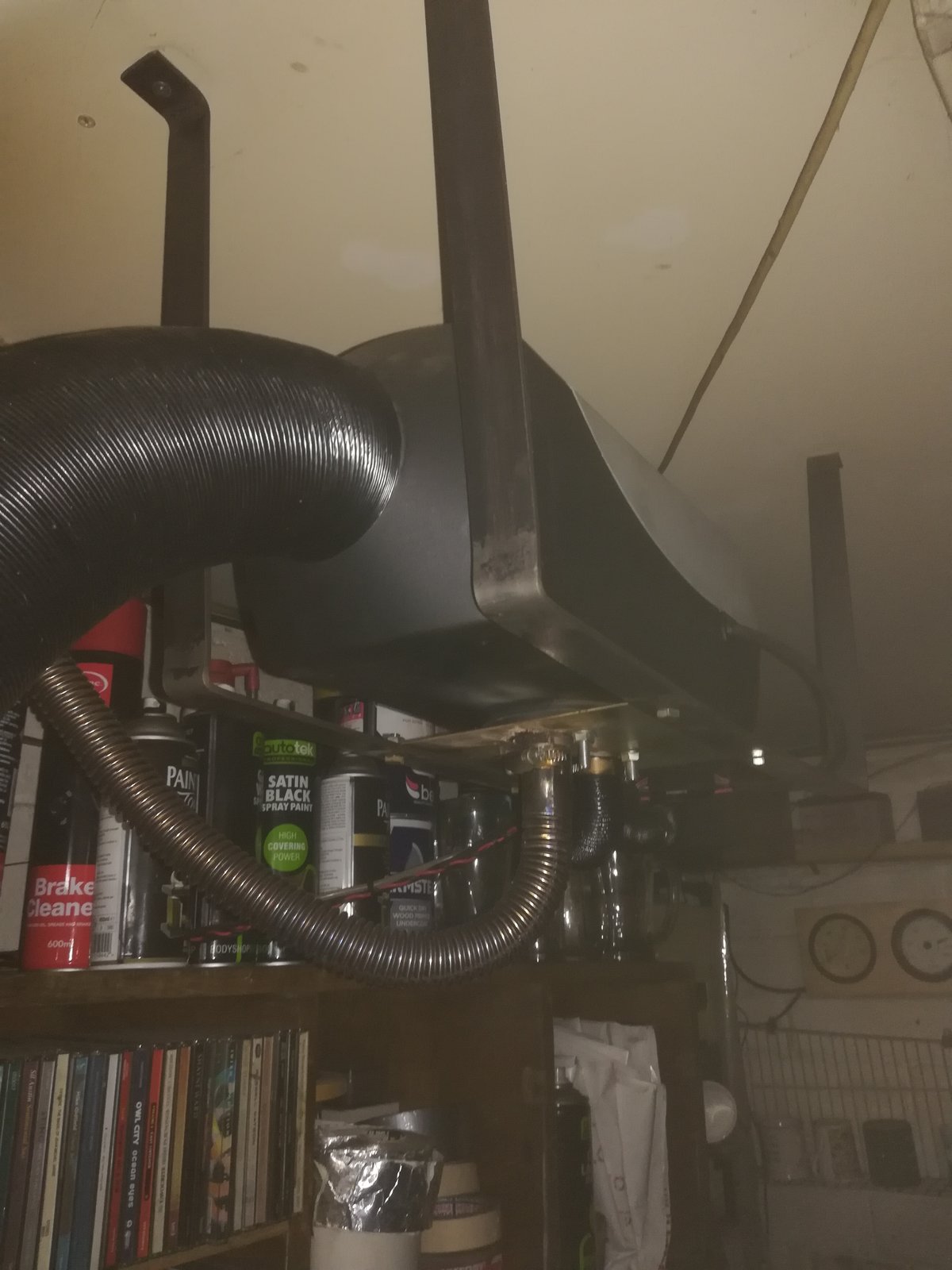

The unit has been fitted like that for 2 years in total we had burner out to examine it was clean no sign of corrosion so we must have the pipe length & diameter just right the Pipe works like a rad the exhaust out is just warm enough to be uncomfortable if you hold hand in front of pipe outlet.
He finds it is cost effective against the air-con unit running as heater especially in the really cold snaps
In his old WS he had wast oil burner with heat exchange ( copper pipe wrapped round flue that worked for at least 10 years lovely hot water for hand washing
Photo about 5 Mtrs along pipe after running all day on thermostat
