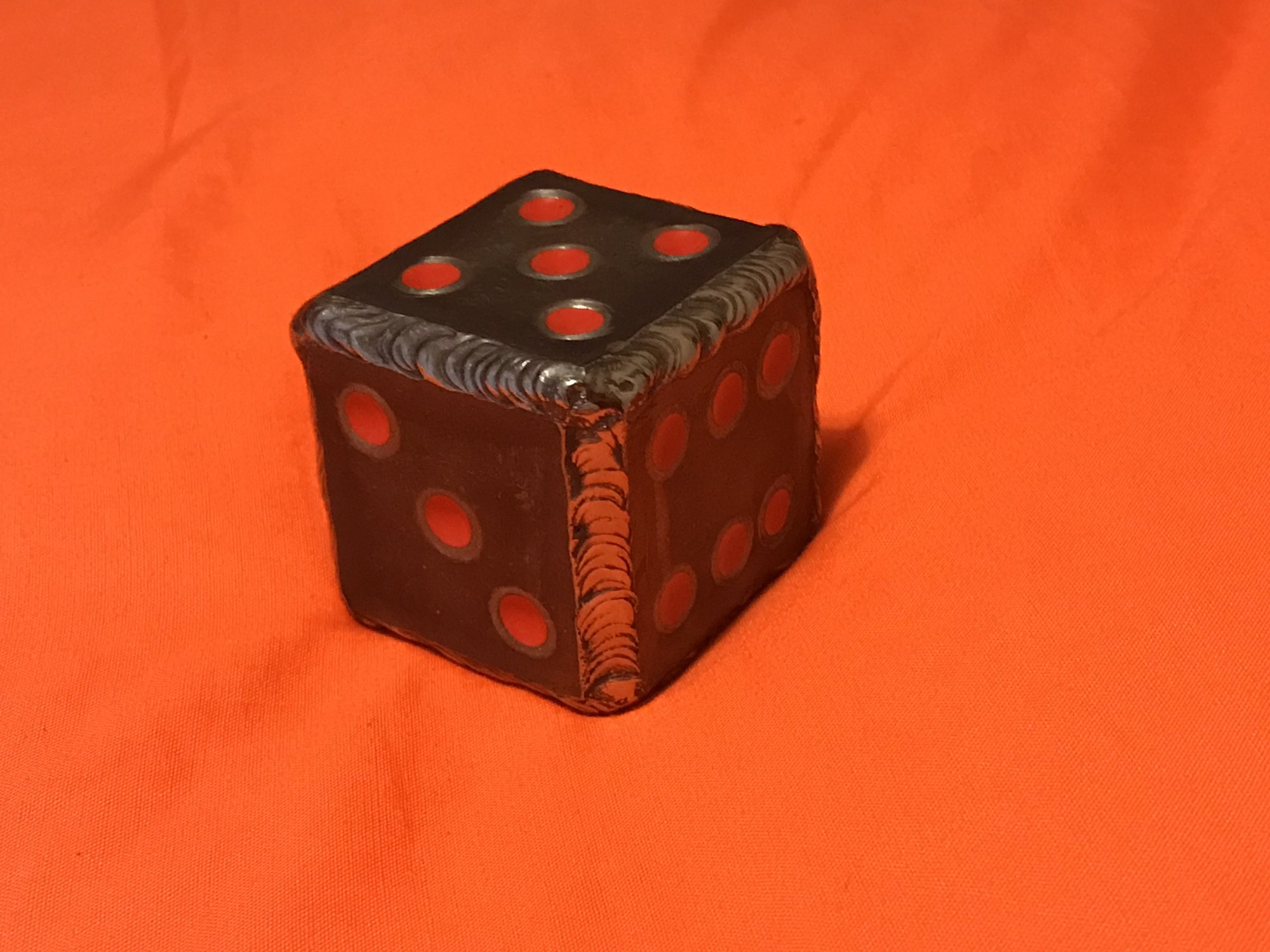

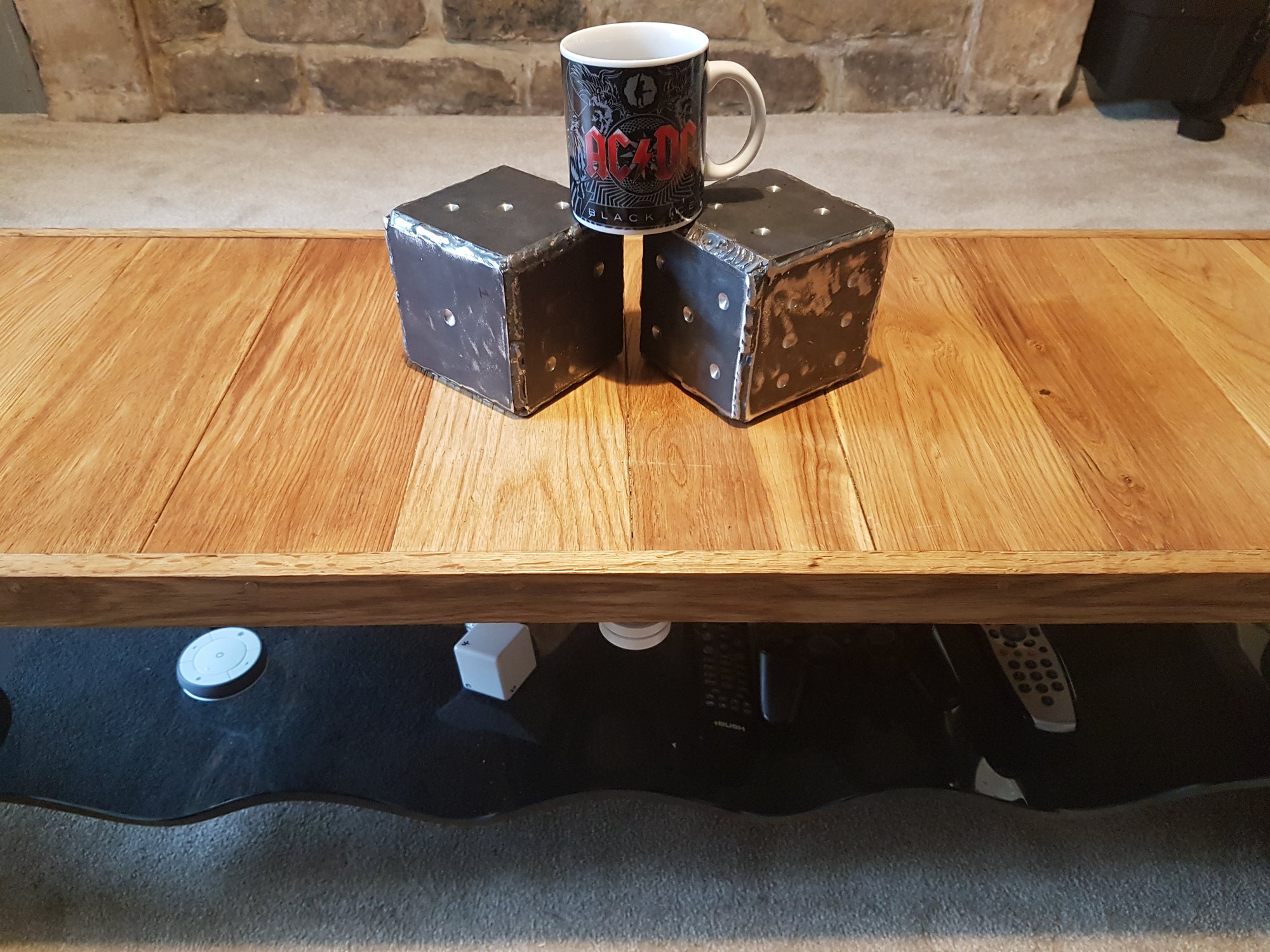

Can I be honest?Well, 2 actually, so dice... Made more for some practice than anything else. Mug included for scale. They're just under 3kg (6lbs 5oz) each. View attachment 153541
Thanks.Can I be honest?
The idea is nice but the execution is not great. As it was a practice exercise I’d suggest you work on those corner welds some more.
There are missing gaps and un fused areas all over. The idea is there is no plate edge on the corner showing and that the corner is nicely rounded off.
