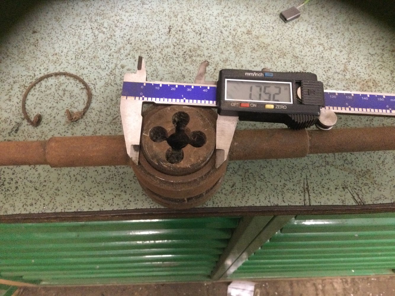

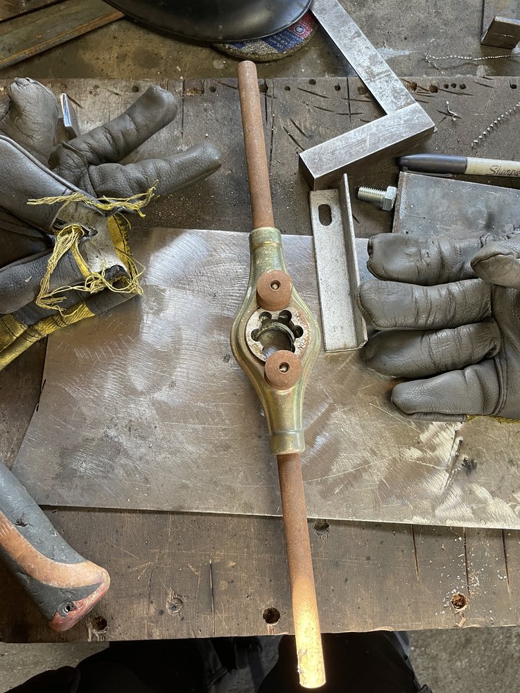

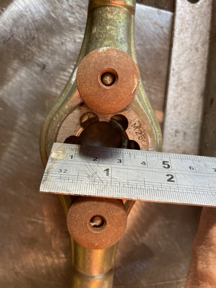

so i bought a 3/8bsp tap and die and a 1/2 bsp tap and die..
both taps are too big for my current holder (m4 - m12) so i found a larger one (m4 - m20) and got that.
only to find it opens out to 14mm
and the 3/8 bsp is 14mm across the corners but the 1/2bsp is 18mm...
but i can mod that by taking the blocks out and machining them..
the 3/8 bsp die is 1 1/2 inch diameter and i have a holder for that.
but the 1/2bsp die is 1 3/4 inch diameter and im struggling to find one....
only see 1 1/2 and 2 inch on ebay.
anyone know anywhere that sells these size of holders...
cheers all
