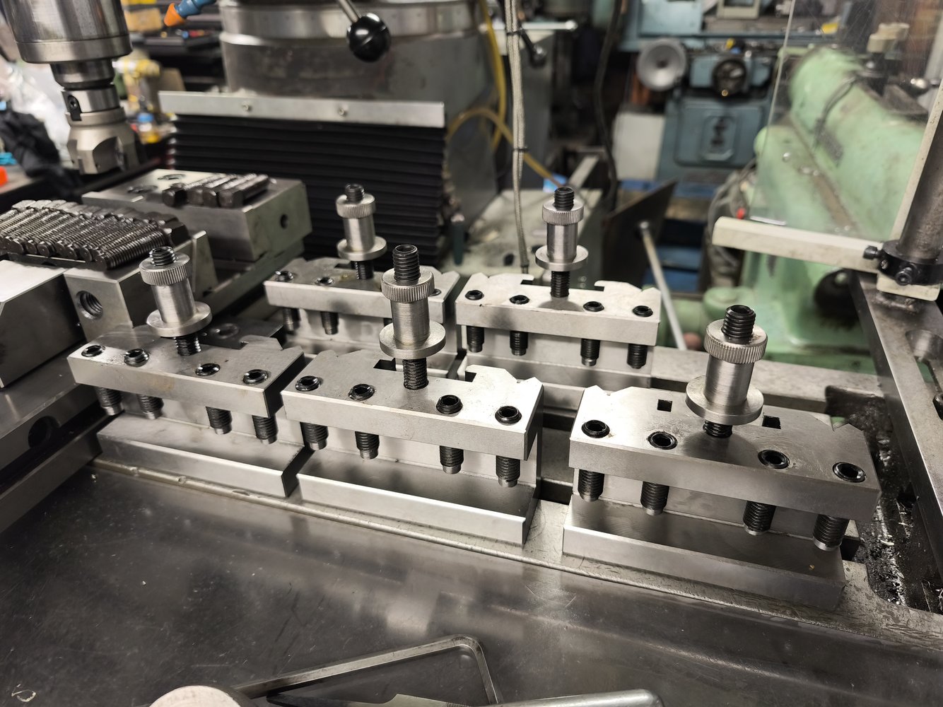

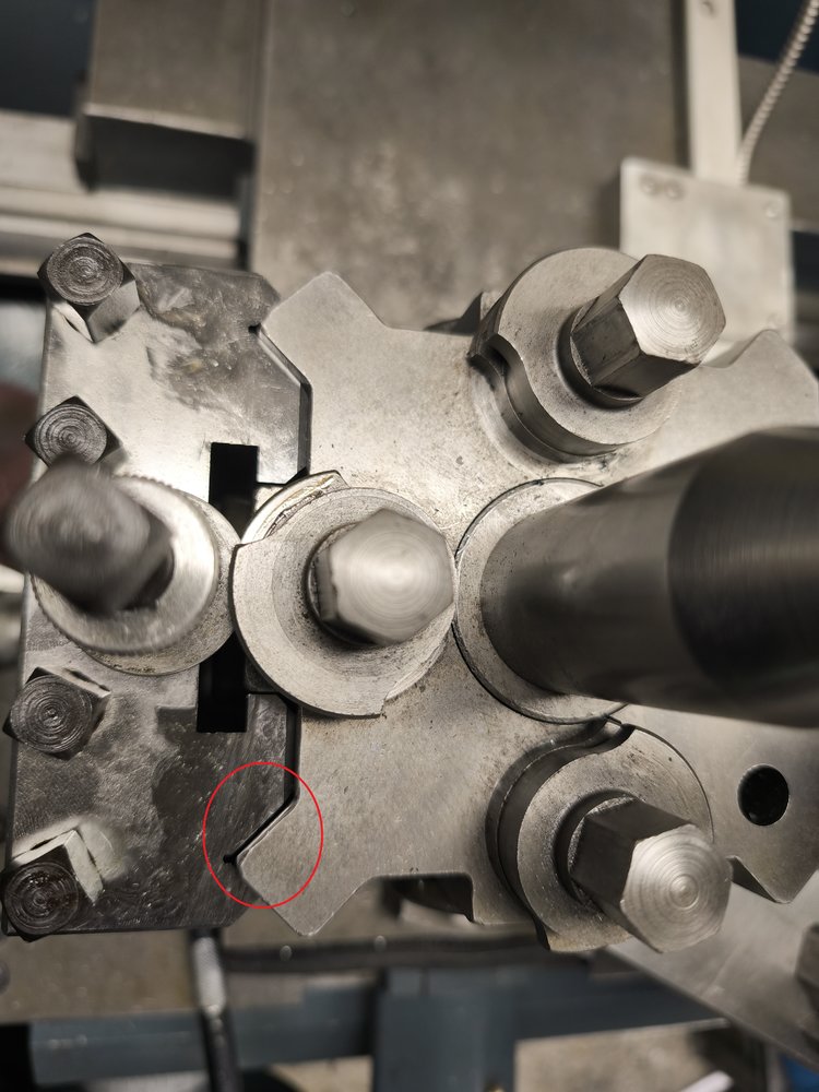

On my Elliott Omnispeed lathe, I have a T3 quick change toolpost.
I have been looking for more T3 tool holders on eBay, but they don't seem to come up very often (for £50 or less per tool holder).

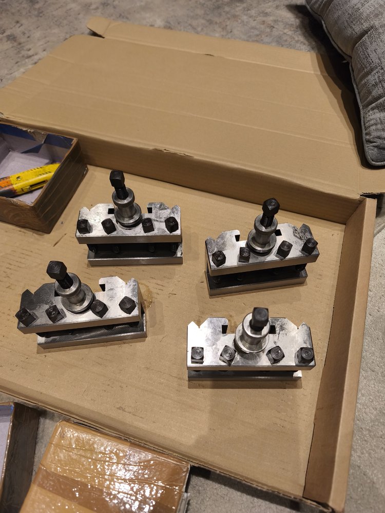

I found a listing by 'Bluefox' on eBay (an Indian company) for 5 x T3 tool holders which worked out at £46 per tool holder delivered and I placed the order.
This morning they arrived all individually packaged.
Excitedly, I opened one up and ran over to the lathe to see how the tool holder would fit.

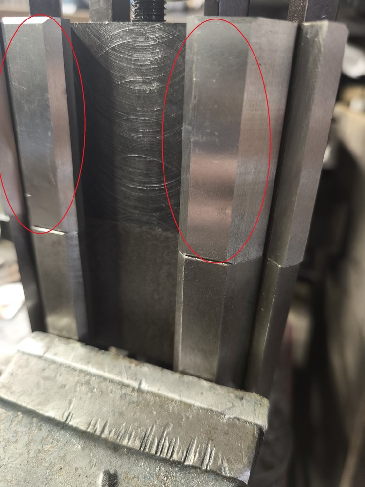

Unfortunately, it seems that the tool holders don't fit too well

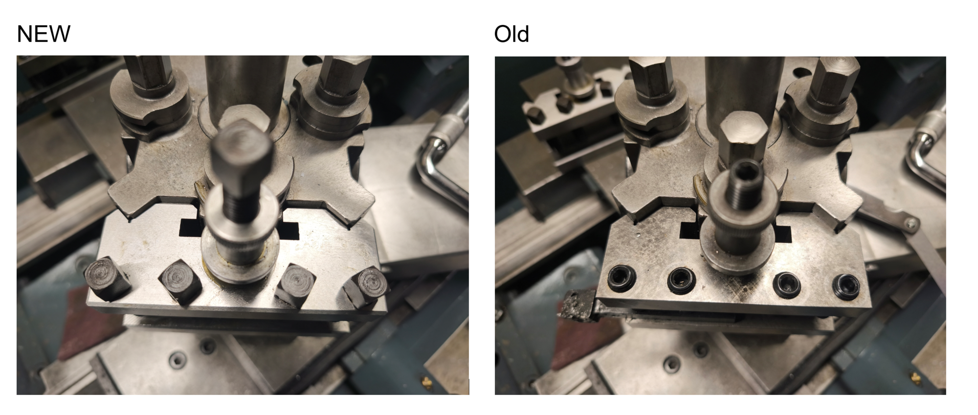

Here is a photo of one of the new tool holders.

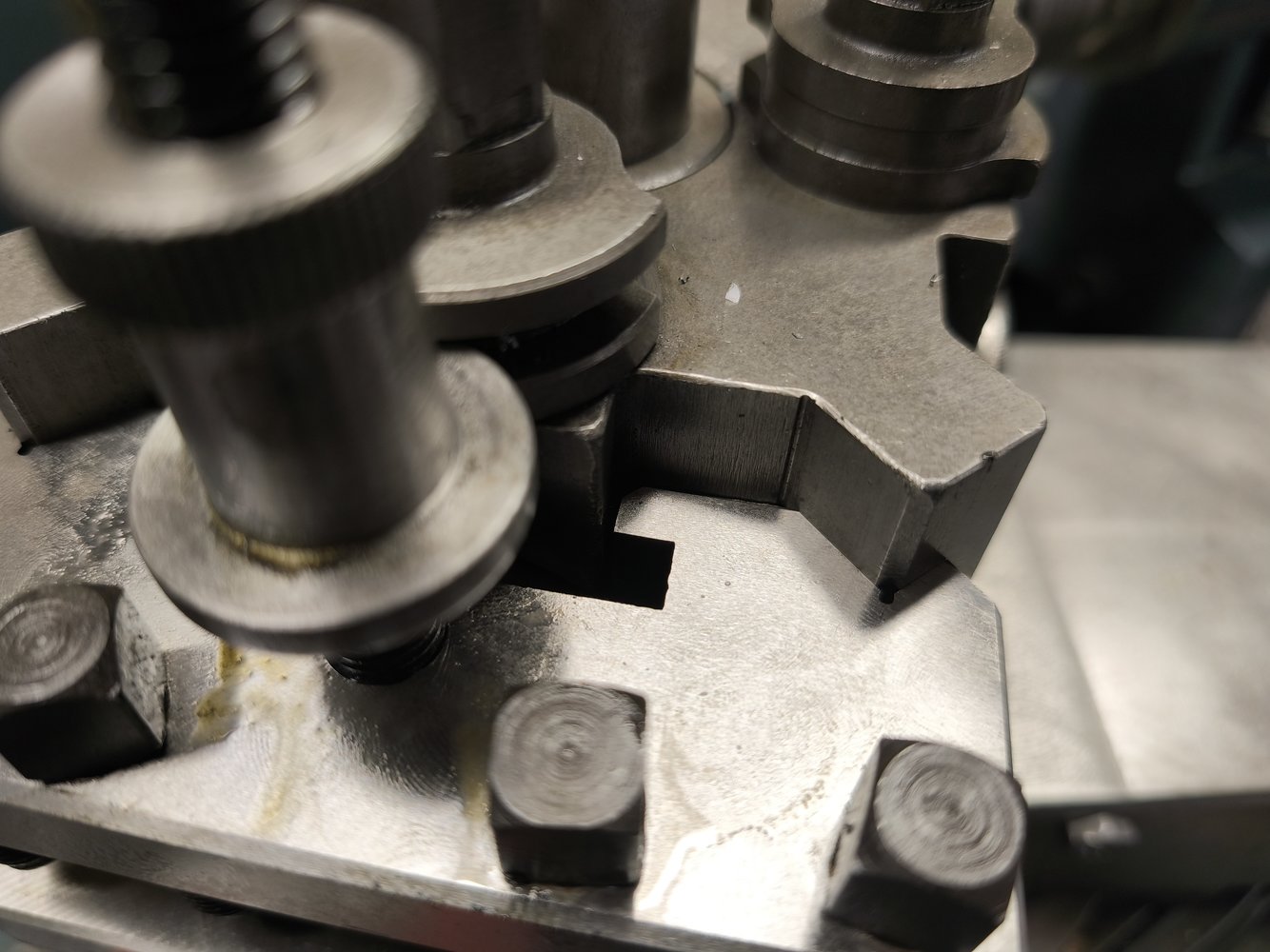

There is a gap between the new tool holder and the toolpost (circled in red).
This is how my existing tool holders fit.
Nice and flush on the old or original tool holders.
The gap between the new tool holder and toolpost is approx 0.55mm.

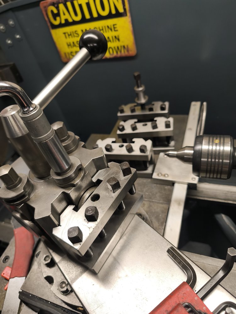

Side-by-side comparison

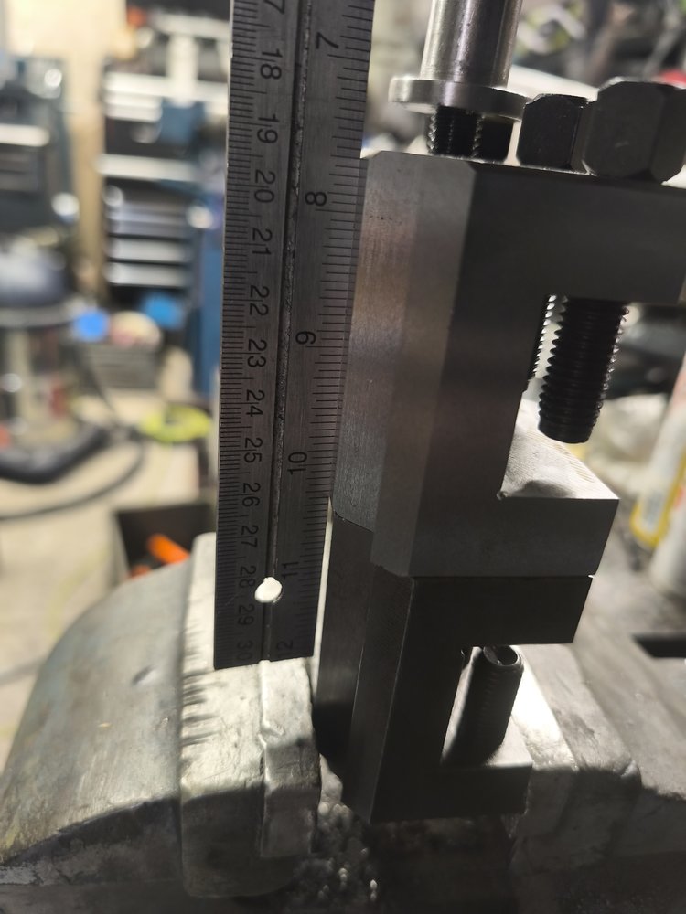

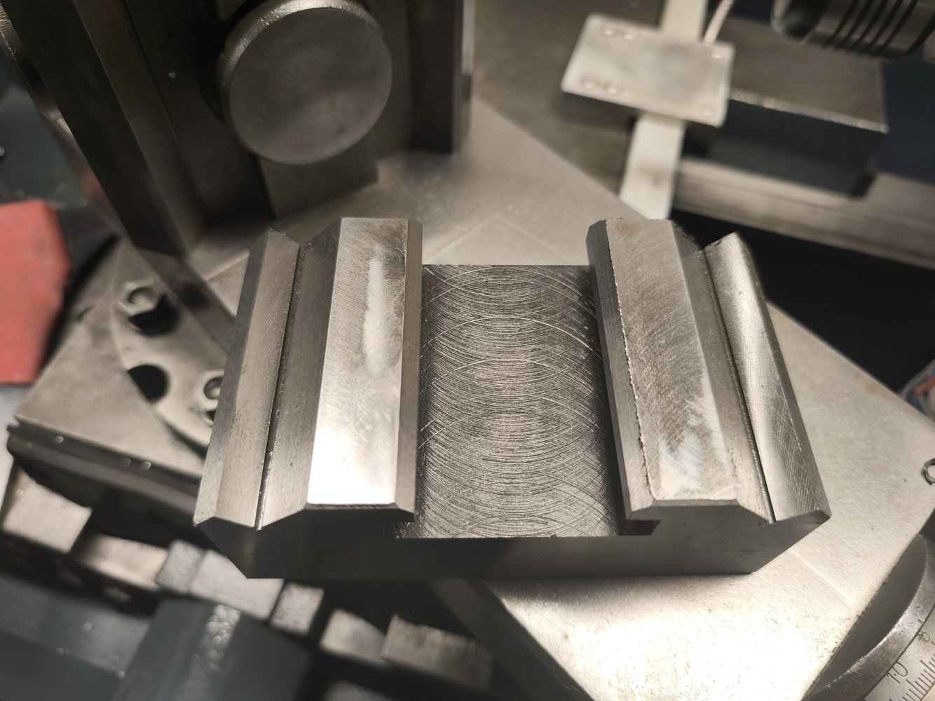

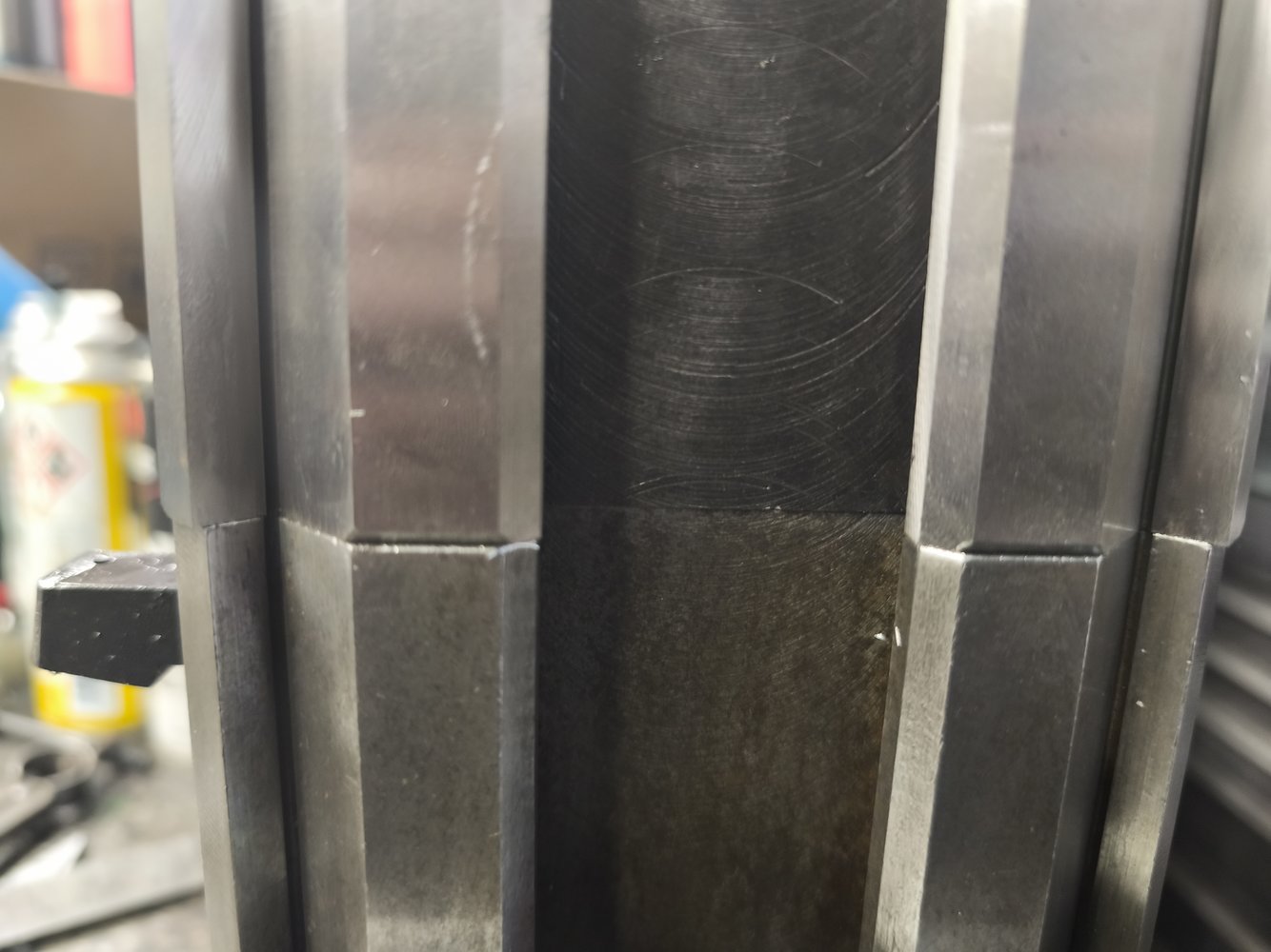

I placed the two bottoms of an old and new tool holder on each other to compare the difference.
The old tool holder is on the bottom, and the new on the top.
The 'V's seem to align perfectly (although the outside edges of the new one are slightly longer.
The problem seems to be that the flat part of the new ones is ever so slightly 'thicker' than the old ones (circled in red).

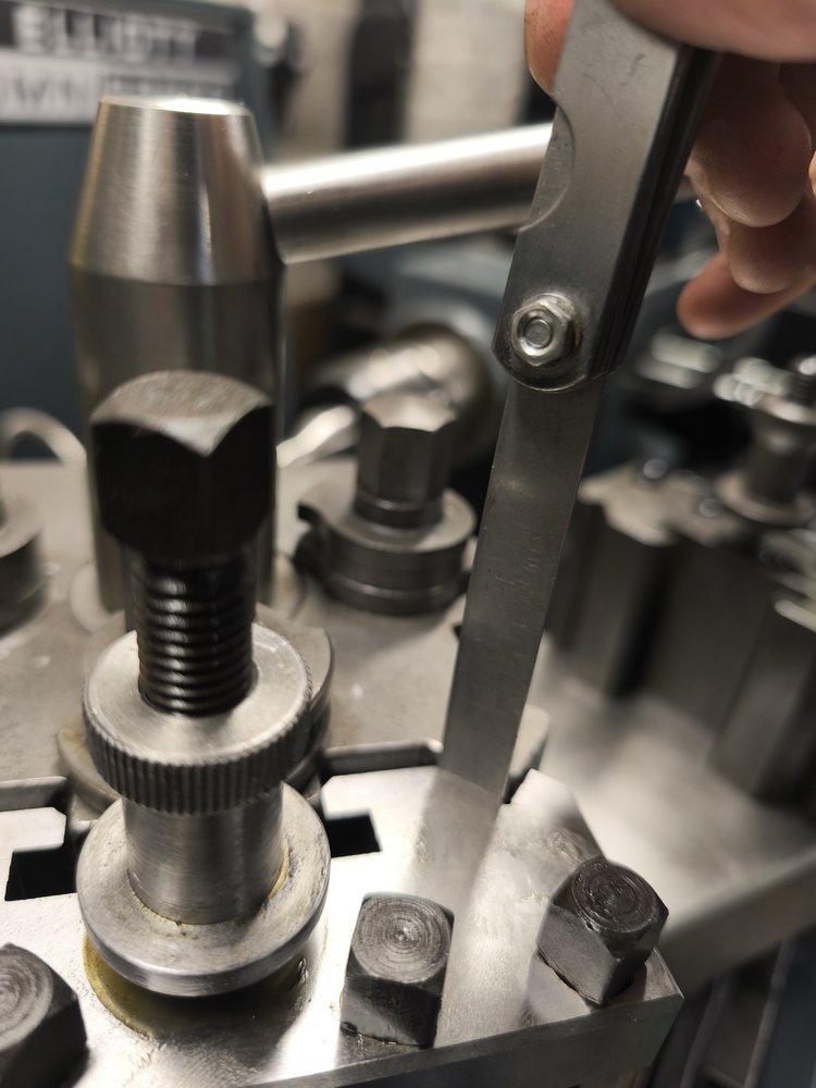

Further demonstrated by holding a flat edge against the surfaces.
How do I fix this?

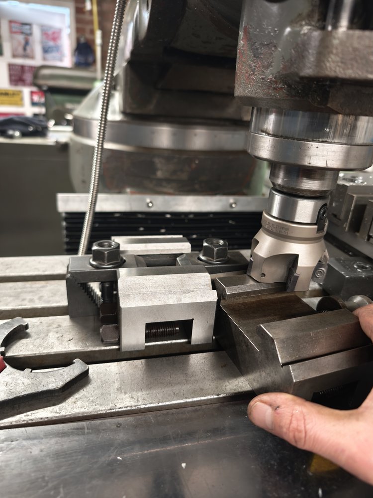

As far as I can see I have 3 options.

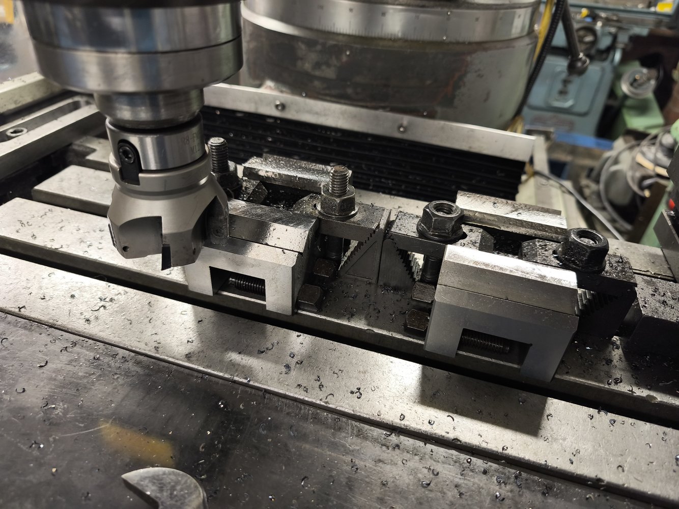

1. Use a face mill to take off ~0.5mm on the new holder (something I can do 'immediately').
2. Get my SG up and running properly and then grind ~0.5mm off (I will need to level the SG again, balance the wheel, learn how to operate a SG and then have a go).
3. Send the holders back and keep looking for holders (least preferred).
