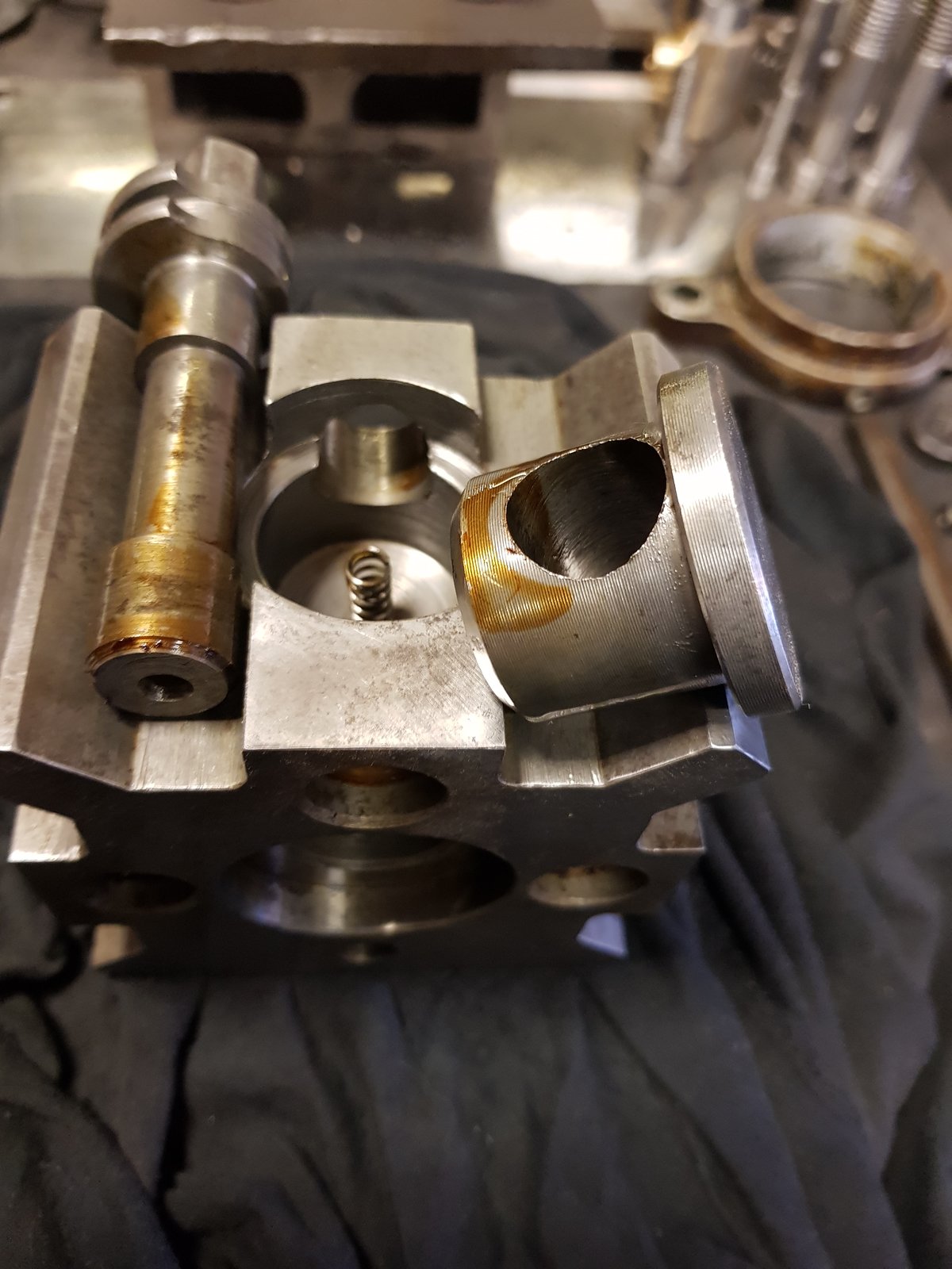

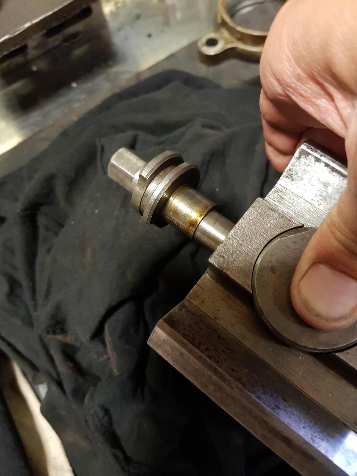

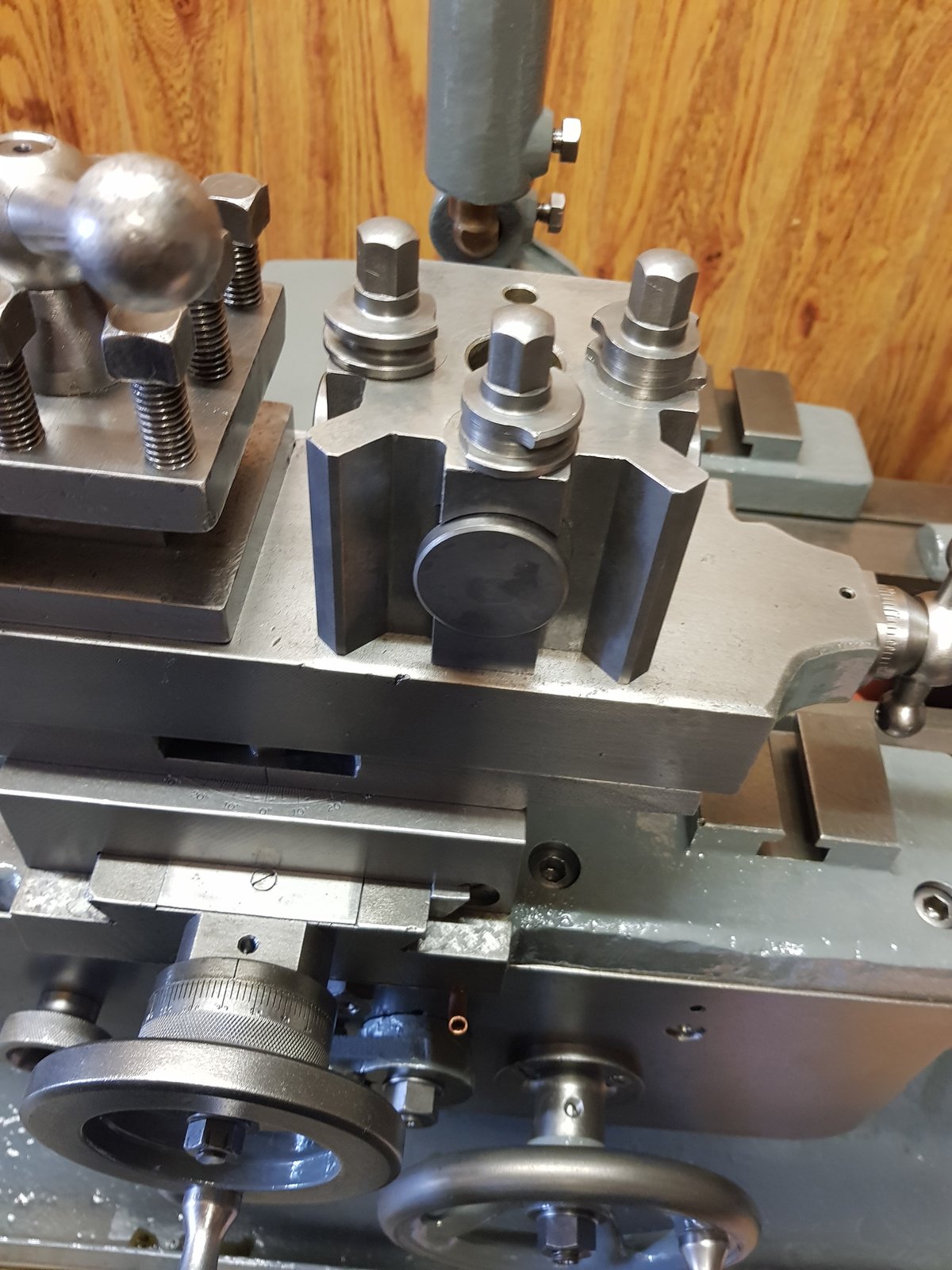

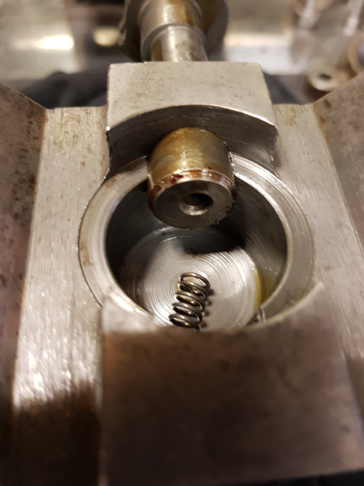

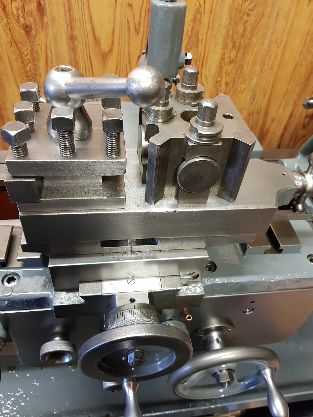

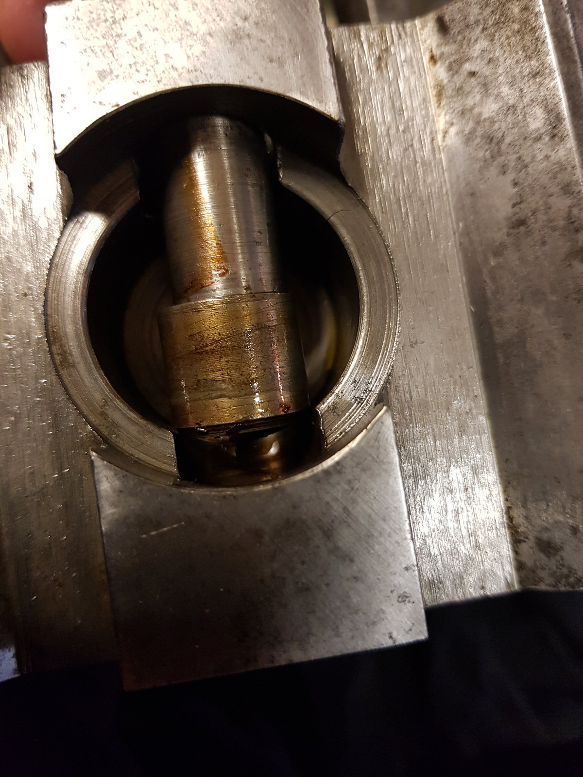

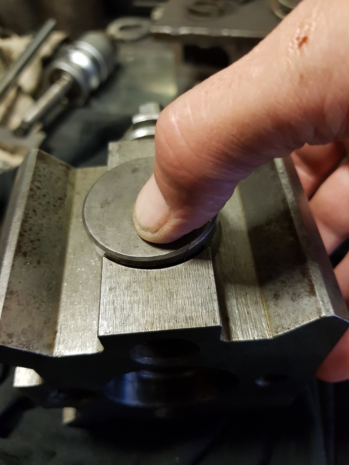

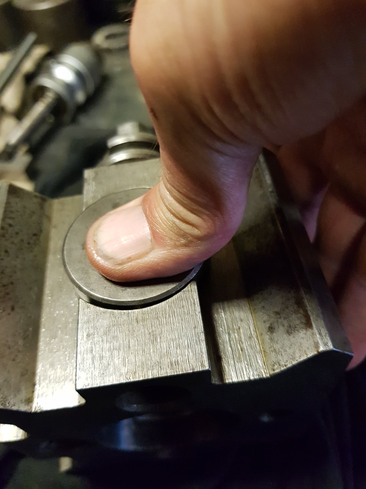

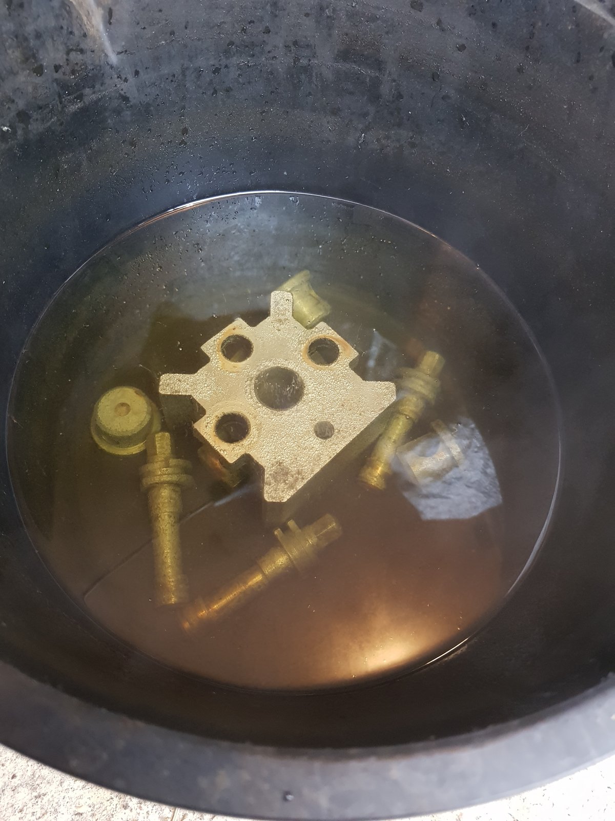

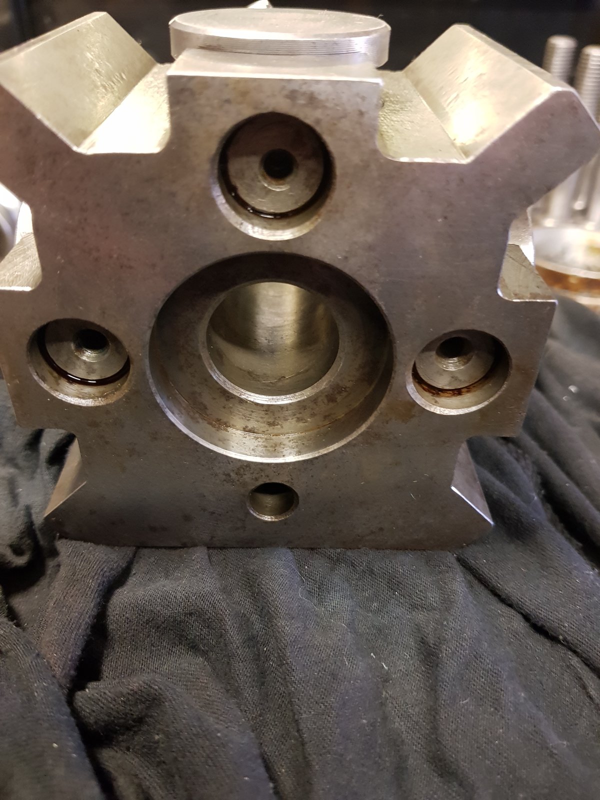

Was having a sort out in the workshop and realized I had a genuine dickson S2 tool post....ideal size for the empire lathe...anyway I thought for those of you that never took one apart and need to..I did a few pictures explaining it. Basically depress the round tool holder (spring loaded ) rotate the locking pin and gently pull at the same time. You will feel the offset cam find its location and you should be able to withdraw the locking pin from the housing. Gently depress the round tool holder as these have a spring .very simple....
