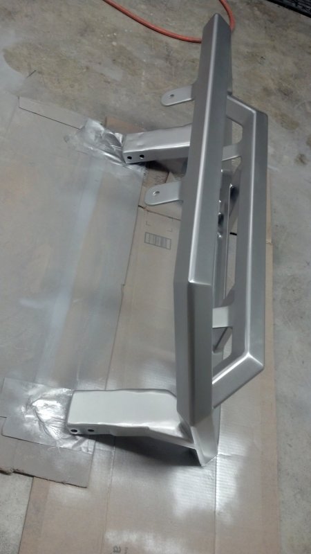

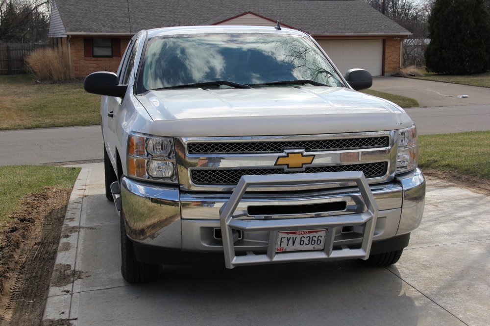

I purchased a Silverado and wanted to make a push bar.
I looked online and found one I liked and made my version of it.

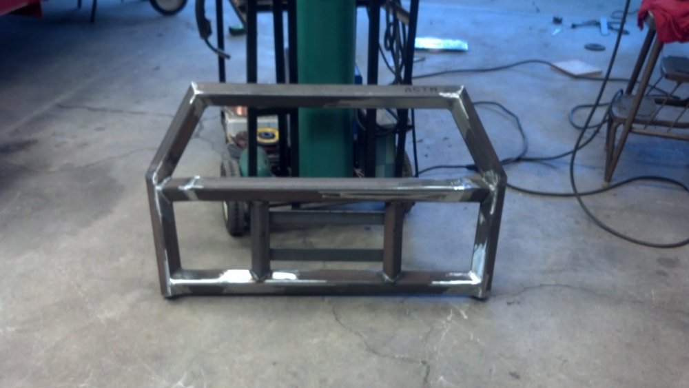

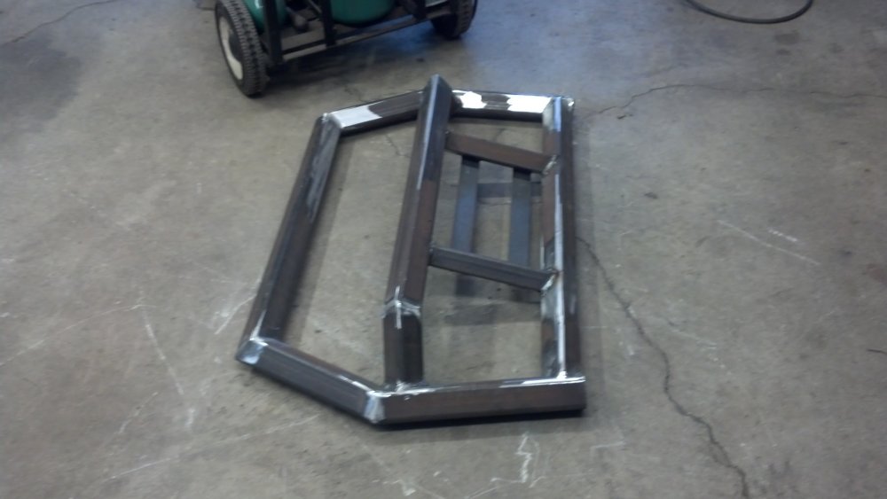

Mine is made of 1/4 inch thick 2 inch square tube.
I took 1/4 inch plate and boxed it and made it mount inside the frame.

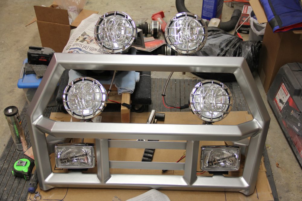

I welded tabs for 2 round spots , 2 round driving and 2 rectangular driving lights.

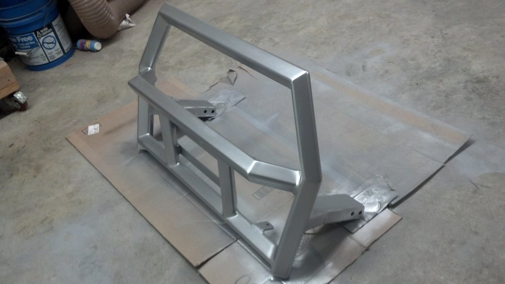

I fully ground and polished all welds. I painted it to match the oem silver and it is a real close match.
