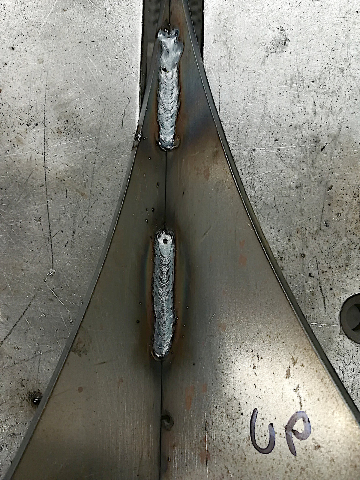

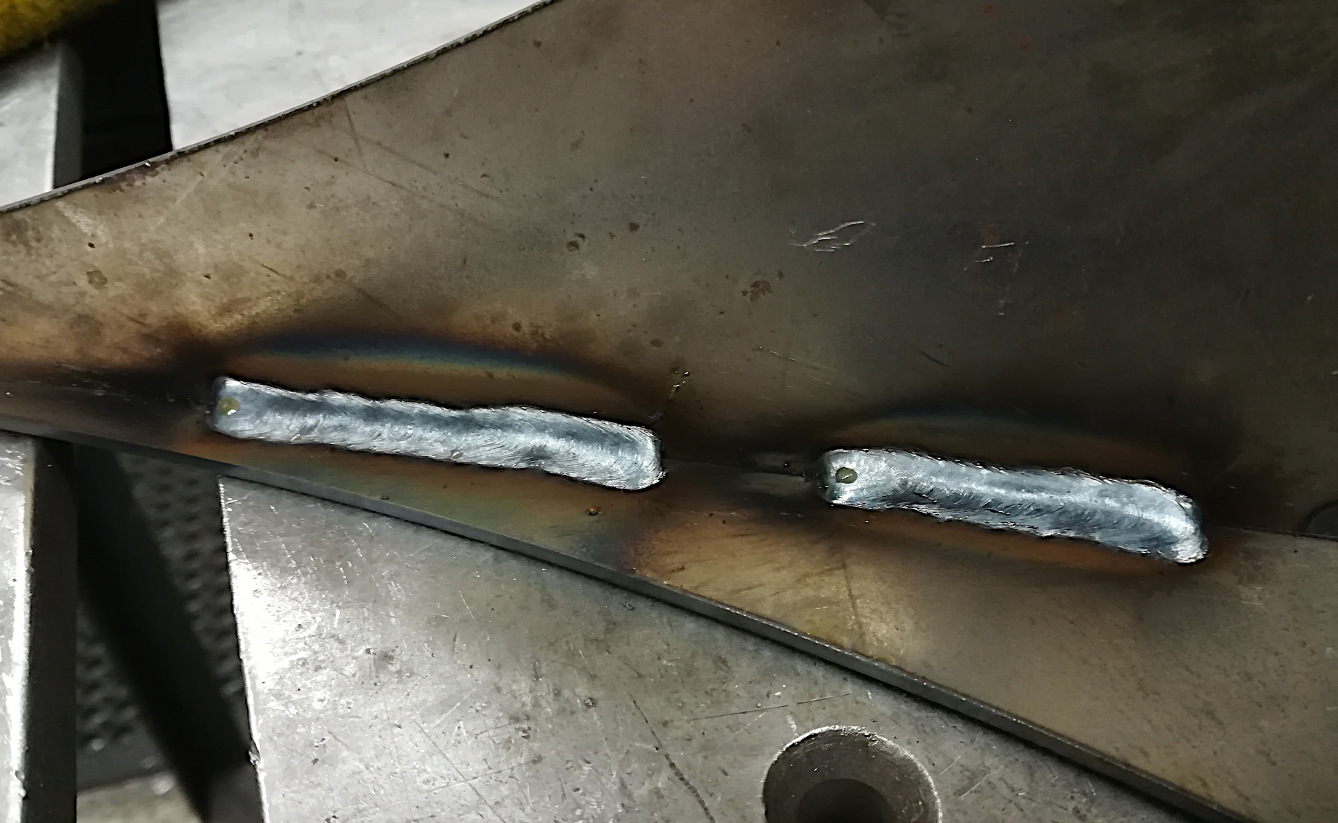

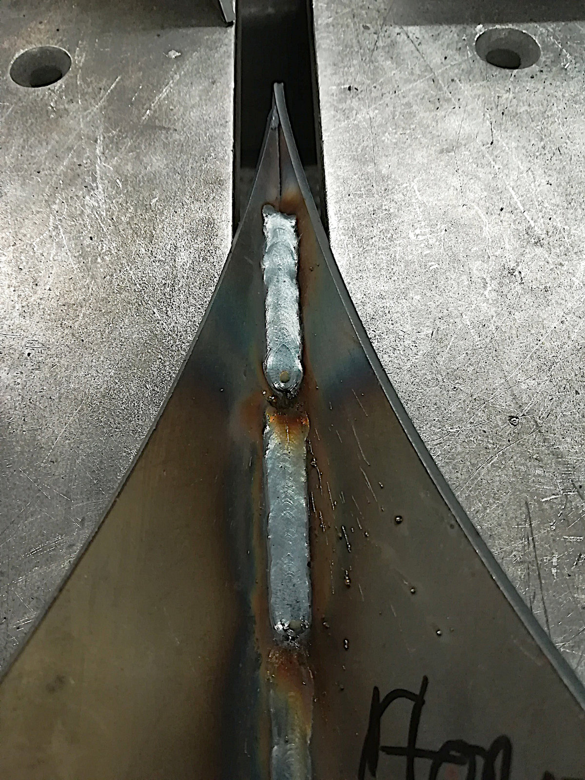

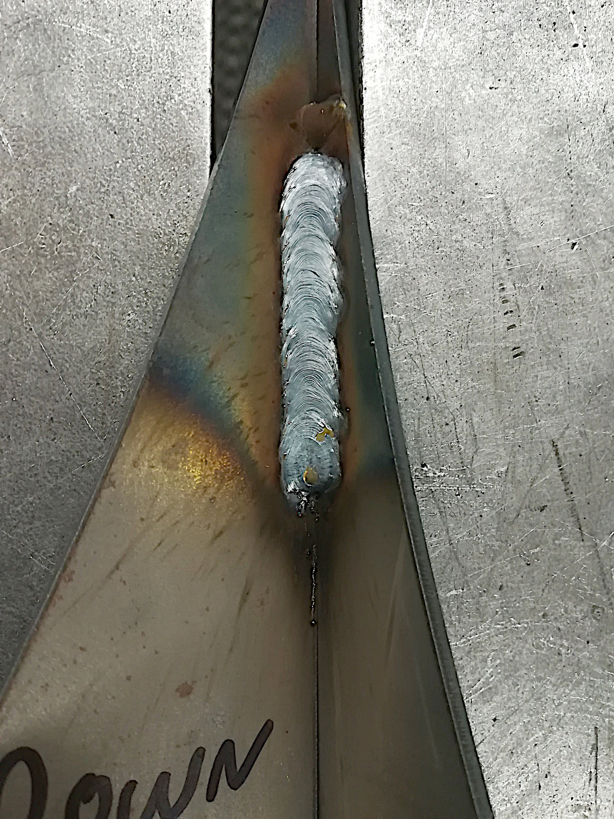

If I said my vertical-down fillet welds were much better than say a horizontal fillet what might be my issue?
The vertical-down has a nice concave finish and the horizontal has a pronounced ridge along the bead.
What might be the go-to thing to look at???
Thanks
Thanks
6m/min on 0.8 is quite low on amps unless you're going uphill, though. I'd want to go up to 7.5-8m/min and travel faster for 3mm plate.
