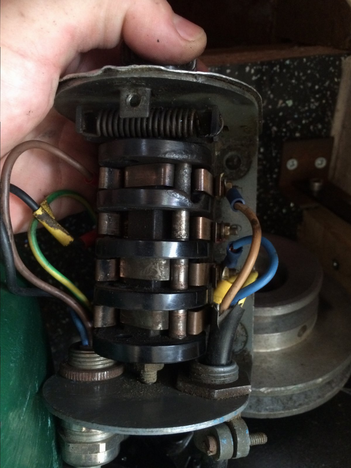

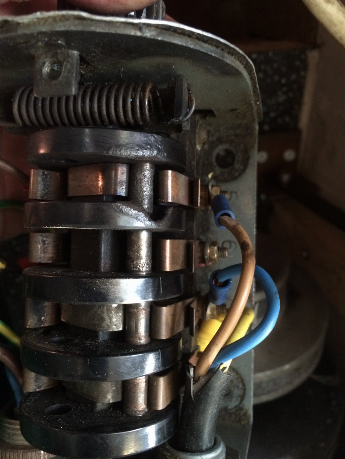

so my smart and brown lathe has a dewhurst reversing switch like a myford. whilst using the lathe the other day there was a pop from the switch and some smoke and the rcd tripped. took the cover off to find this one of the copper fingers has srched arcross the insulating disk and burned a chunk off. it looks like the finger has moved from central and i can only assume this caused the problem.
so my question is this, does anyone have any experience of these and is this salvageable? there seem to be a few on ebay but as they are common to myfords they go for a decent price. i havent taken it to bits yet but i was considering making a new 'insulating disk' out of nylon or acetal or something but i am a bit worried as to why it arched across.
