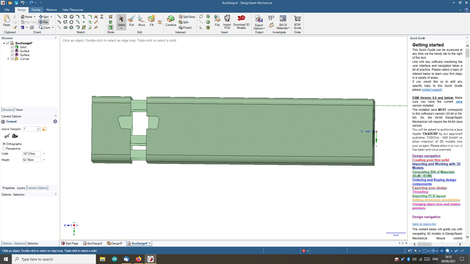

I was getting on quite well, but have one or two stumbling blocks. My project box is in two parts and the first part is fine. I then designed a cap for it and offered it up to the main part on the design and it has become part of it. If I try to detach it, the design goes to wireframe and I can't get it back.
I tried cutting the design in two, but can't get that to work and the instructions are meaningless. They call it "Splitting".
Use the Combine
tool to split bodies and surfaces.
Splitting bodies and surfaces
Use the Combine
tool to split bodies and surfaces.To split bodies and surfaces
- Click the Combine
tool
from the Intersect
ribbon group or press I. - Select the body or surface you want to cut.
The Select Cutter tool guide is activated. - (Optional) Control the behavior of the cut by selecting options.
- Click the surface you want to use to cut the body.
Depending on the option you chose, the cutting surface will be kept or deleted. Review the information in the Structure panel to see the bodies or surfaces created by the cut.
Mouse over the target body to see the regions created by the cut. - Click each region you want to delete.
When you are finished selecting the areas to be deleted, click the Select Target
tool guide to combine some more, or select another tool.
| If you want to split a body by a face of the body, select the Split Body tool.If you want to create an edge on a face, select the Split tool. |
To split the target object with the cutter object and the cutter object with the target object
- Select the Combine
tool from the Intersect
ribbon group. - Select the Make all regions option.
- Click the objects you want to cut.
Target
and cutter must be the same type of object, either both bodies or both surfaces. - Mouse over the surface to see the regions created by the cut.
Because this option can create a large number of regions, we recommend using this option along with the Merge When Done option to quickly merge all remaining regions when you click another tool or press Esc to finish using Combine
. - Click the region you want to delete.
