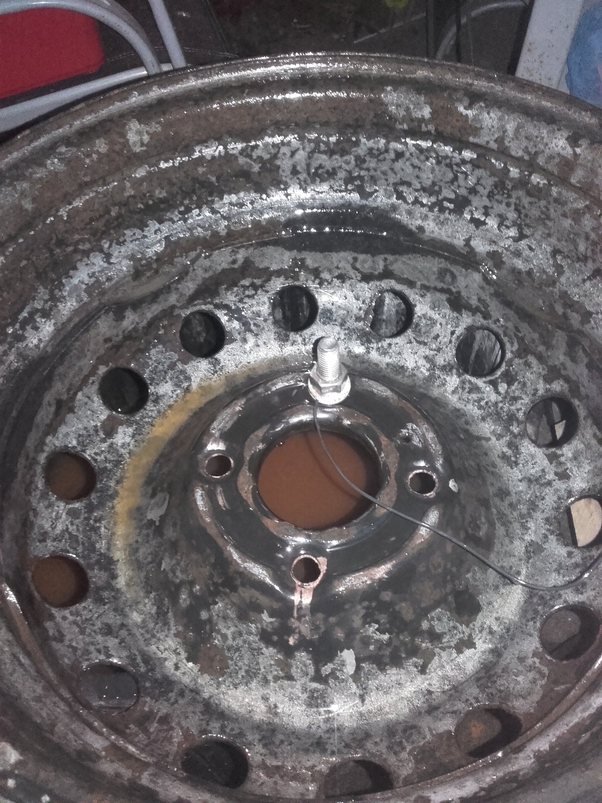

Need to derust a couple of steel wheels.
And to think everything in the photo was being thrown out!
My 38 year old CB pack made from a battery charger:
10ml of these per litre, so 350ml into 35 ltrs of water:
And leave to ferment:
Safety first:
So the rust is coming off nicely:
https://flic.kr/p/GnDWAv
Quite why SWMBO moans...
The plan is to jet wash the derusted wheels then give my Aldi compressor / grit blast pot a whirl.
The wheels just need to be "black" I was thinking good old hammer finish paint?
