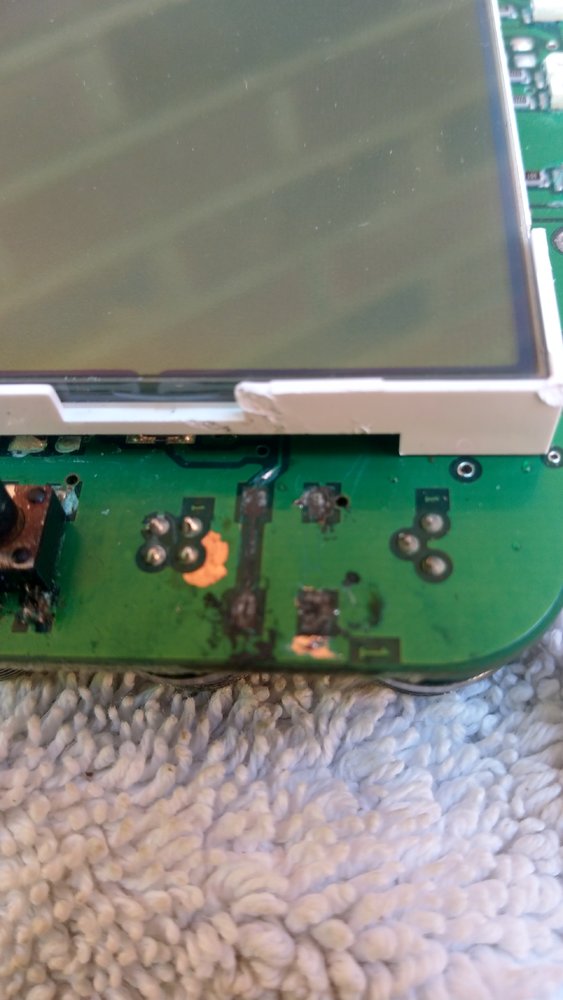

I’ve used this trick in the pastEnameled copper is pretty useful in this instance
Dare I say it. And hot melt glue

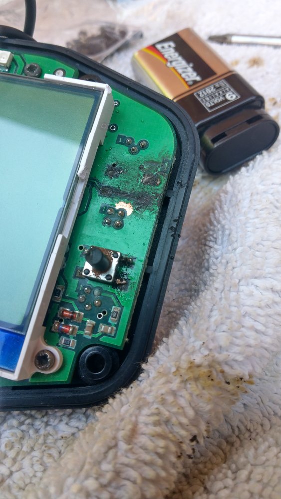

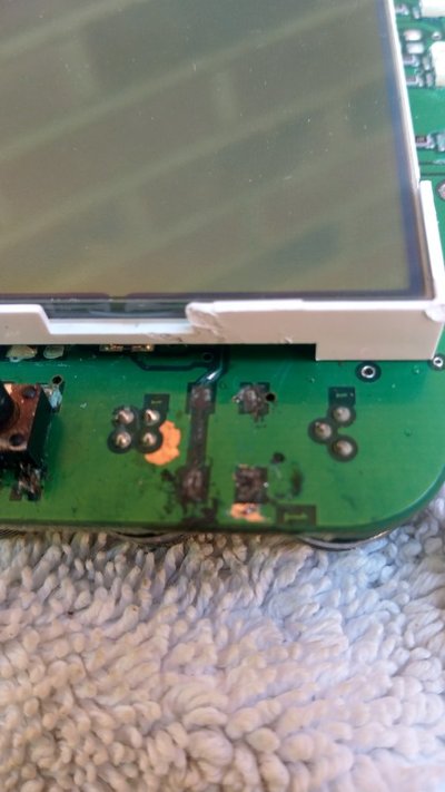

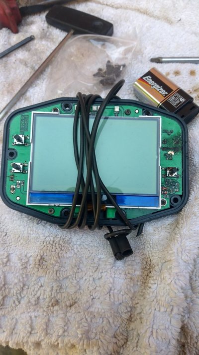

Ok I've had a good go of it and had to bridge a track, I managed to get the switches on and connected but it wouldn't turn on. I tested the switches were actually working and connected by probing the tracks and pushing the buttons and I got continuity on and off.
The tracks were already pretty mashed so worth a try![]()

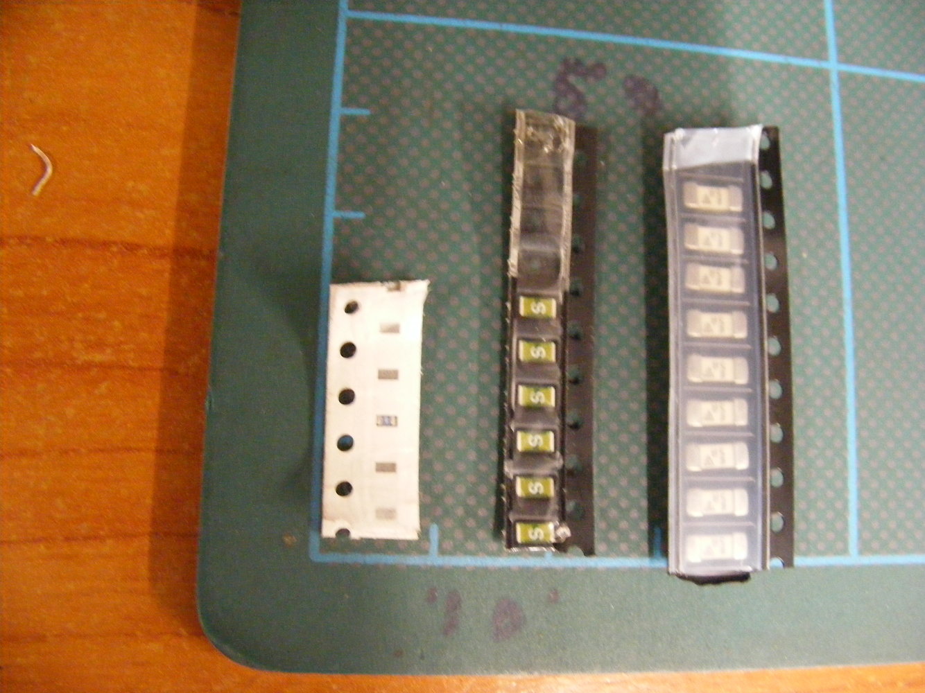

Is it totally dead if so look for a surface mount fuse
Was it surface or through hole

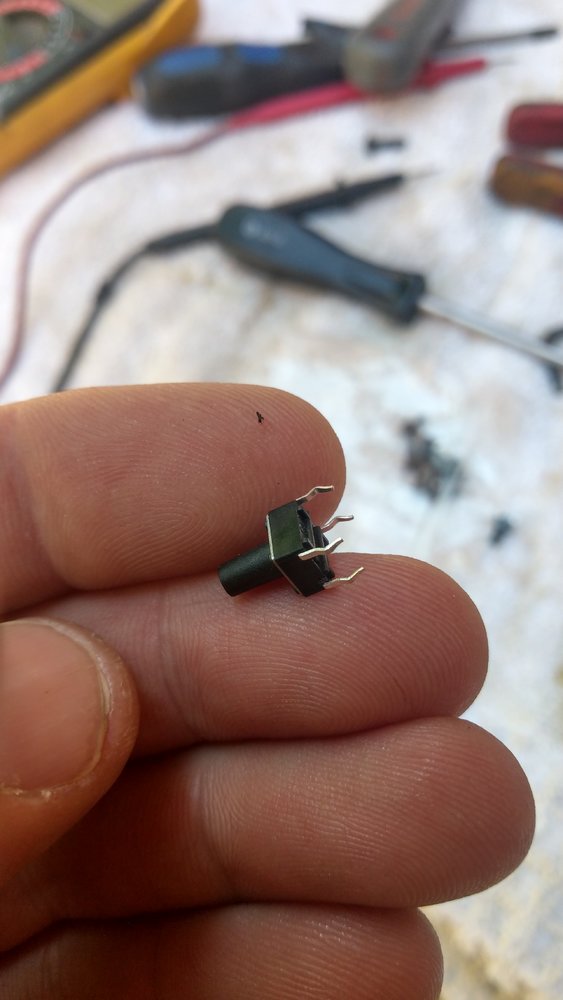

You are correct!That’ s a Mychron 4 by the looks of it.
They don’t use all four legs, just two to make a switch.

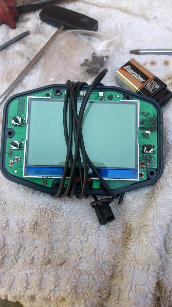

I know you probably know this already but you may have to hold the ON button down to wake it up. This is to prevent accidental switching on.You are correct!
Yes I worked this out, unfortunately even though the new one was working it didn't want to switch on, the tracks were already well knackered![]()
