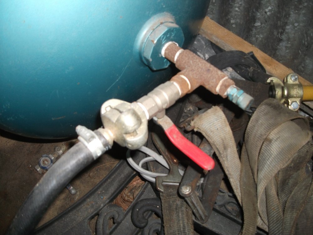

I've just finished putting in my new copper piping and larger receiver etc but flow from the compressor to the regulator is rubbish, it just doesn't flow out of the regulator very well and there is a considerable pressure drop when the air line is opened. The flow from the air receiver is fantastic. My pressure switch has a gauge on it and is separate from the compressor regulator so thinking about ditching the regulator. Thought I'd go 1/2 full bore valve and then connect the flexi to the copper piping. I have a filter regulator at the end of the piping so I can control the pressure from there. I can isolate all the sections and easily drain down each section so wondering if anyone has done this and if there are any issues with my plan?
