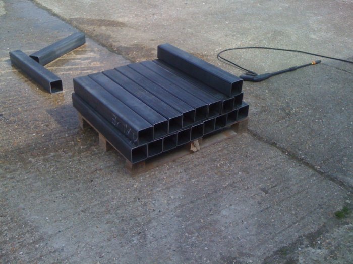

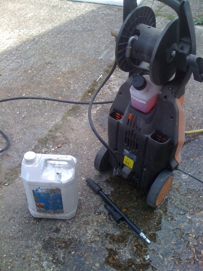

Well, in my eternal quest to find labour-saving ways to degrease stock, I decided to try putting my usual water-soluble degreasant into the soap dispenser of my pressure washer and see if I could just blast the grease off.

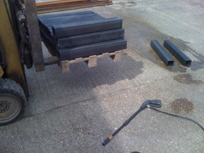

It actually worked pretty well - would have been excellent except it only dispenses soap (or degreaser) while blasting at low pressure, so you have to sopa it up with a crappy flow rate and then blast it off at high pressure with no extra chemicals. If I could figure a way to feed degreaser into the high pressure flow, I'd be grinning from ear to ear.
Anyway, worth a go if you're as bored with wiping grease off as I am. You can just about see that the two which have been blasted in the last pic are a much lighter shade of grey.
Thought I'd share! Al.
