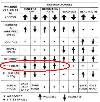

Wait a minute! This can't be right! DECREASE wire diameter to INCREASE penetration???
Since increasing stickout decreases penetration (more resistance = less current), increasing wire diameter should similarly increase current and increase penetration, right? Am I missing something, or is this just a mistake?
The chart below is from http://www.esabna.com/EUWeb/MIG_handbook/592mig7_15.htm.
