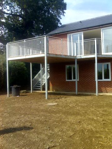

Heres the final stages of one of my latest projects. A decking area on 2 new build 400k houses.
One as the pic, the other is the opposite way around on another house.
No drawings, just a rough outline for sizes, and guidlines the rest was made up in my head.
Not a good way to work on a project this size, but not given a choice.
Framework is hot dipped galvanised, the handrails/ railings powder coated white.
Groundworks was terrible, having to kango 30mm off the top of some of the pads, and pack others up 30mm. One of the messiest and dissorganised sites i have had the pleasure of!
More pics in the gallery.
