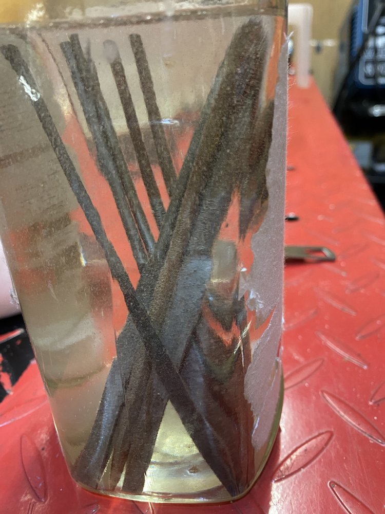

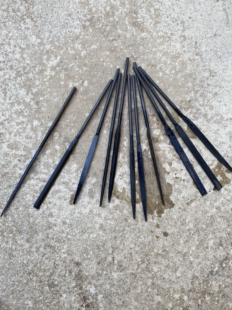

Much more grabby, got that dry cut to the teeth, which they had lost and become a bit slippery if you know what I mean, so clearly cleaned the teeth out of the easier to remove bogies, turned them a nice black as well.What're the teeth like; Any good?
It did not remove deep aluminium clogs tho, nor some epoxy i'd clearly worked on, that will require mechanical removal, but well worth doing
