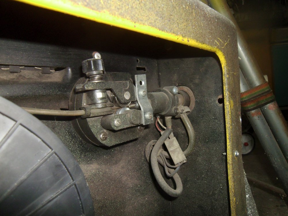

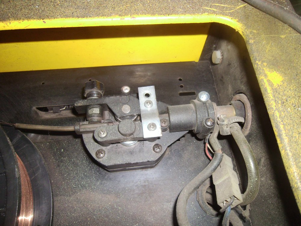

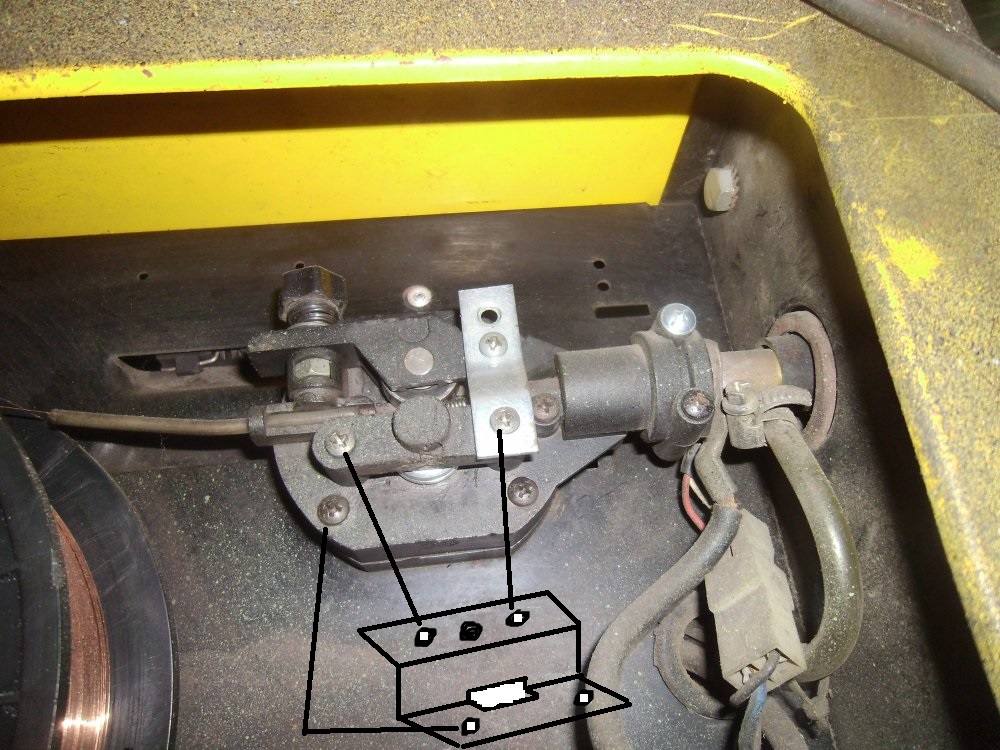

Just aquired a well used deca mig 416, (looks like a deca star 180) it works fine but has one snag. The wire feed pinch is very poor and the feed roller does not push the wire constantly and consistently. I tried dismantling the whole assembly and the motor and feed mech have a lot of wear. I tried to modify the feed clamp force with little or no success, new feed roller, still the same. Tried with a little g clamp, and as soon as the wire finds resistance at the weld it will bundle up and tangle, instead of maybe slipping a bit. Its rather annoying.
So my question is can i buy one of the wire feeds in the shop and fit it to my machine?? as finding an original one is going to be rather difficult as its an old machine.
Thoughts??
Thanks Patrick
