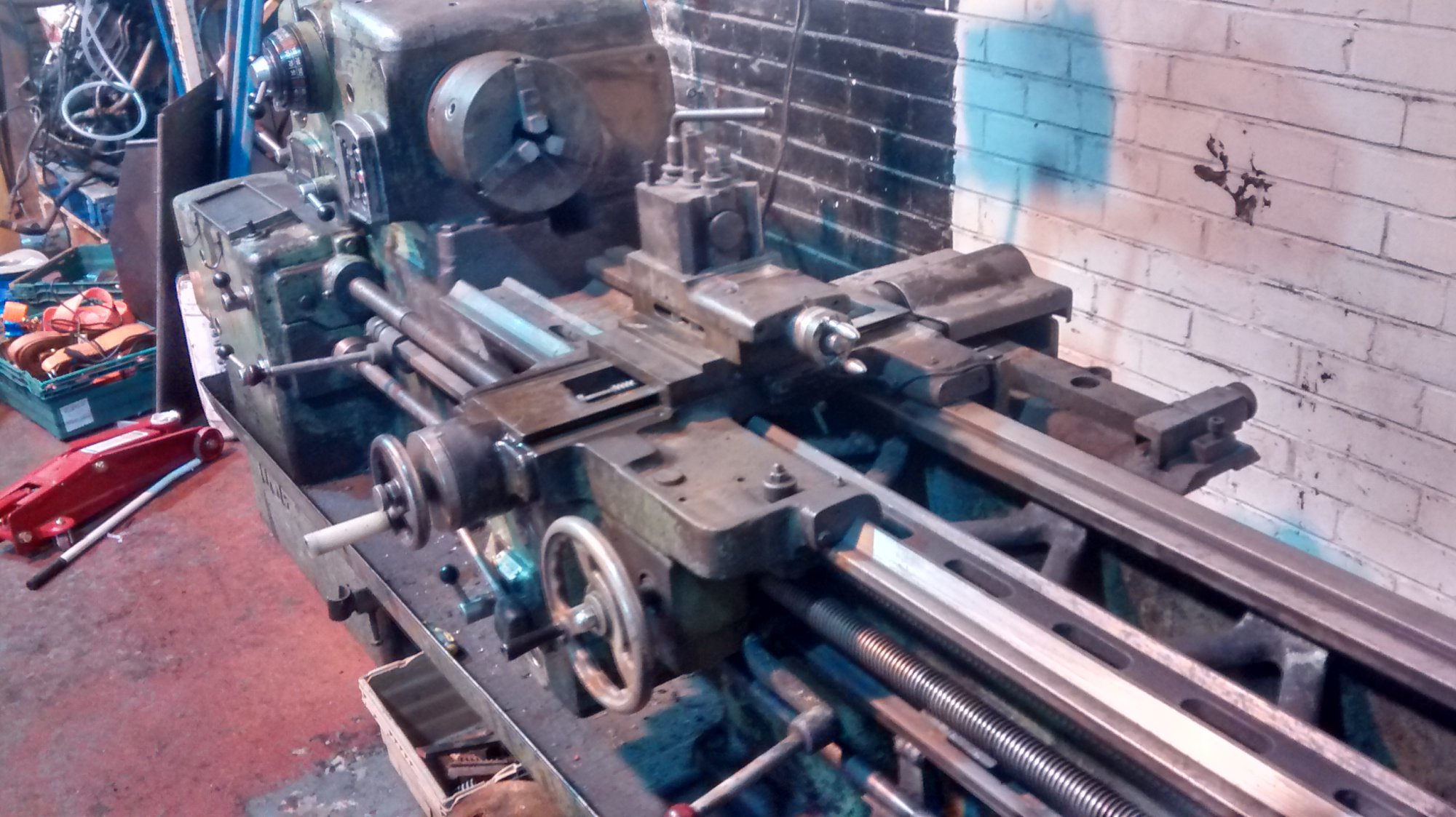

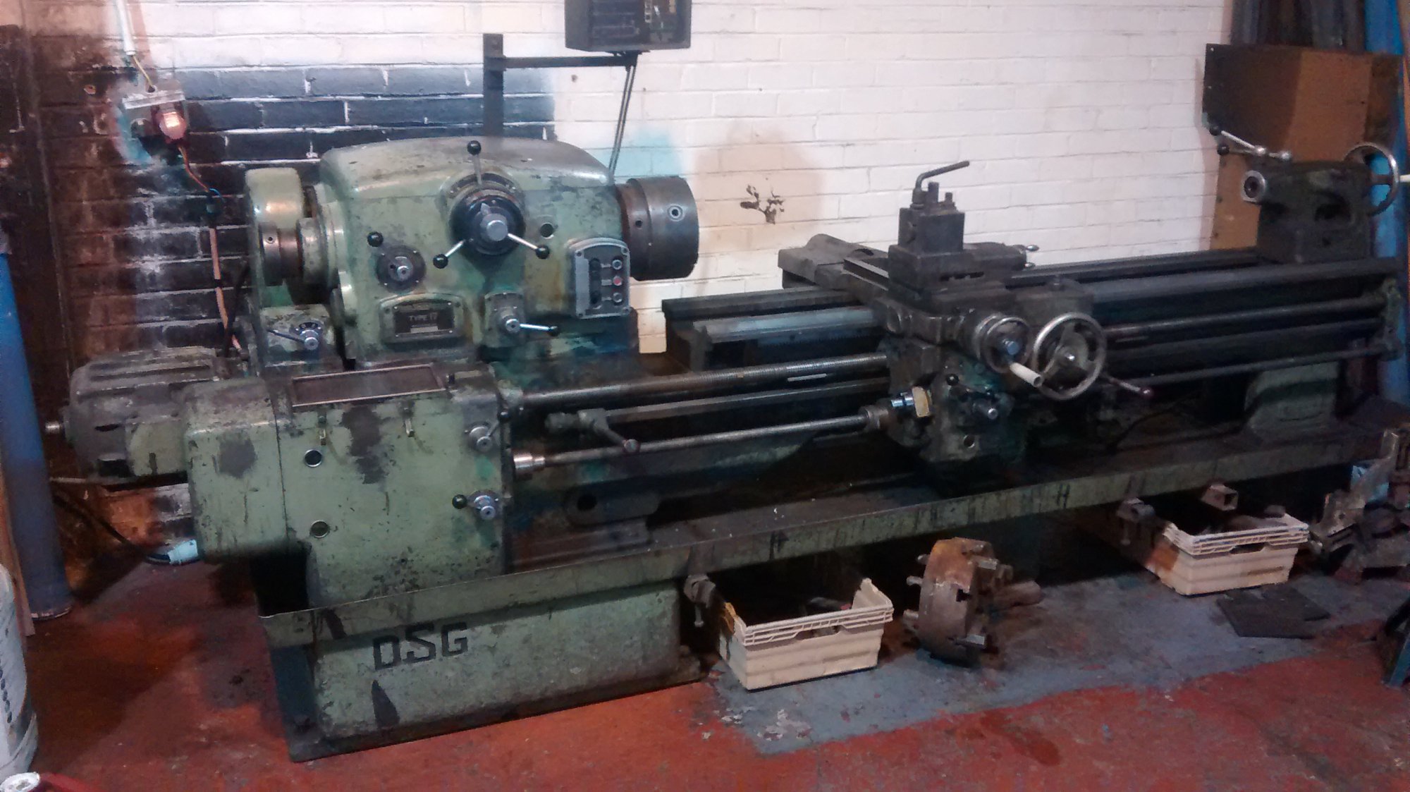

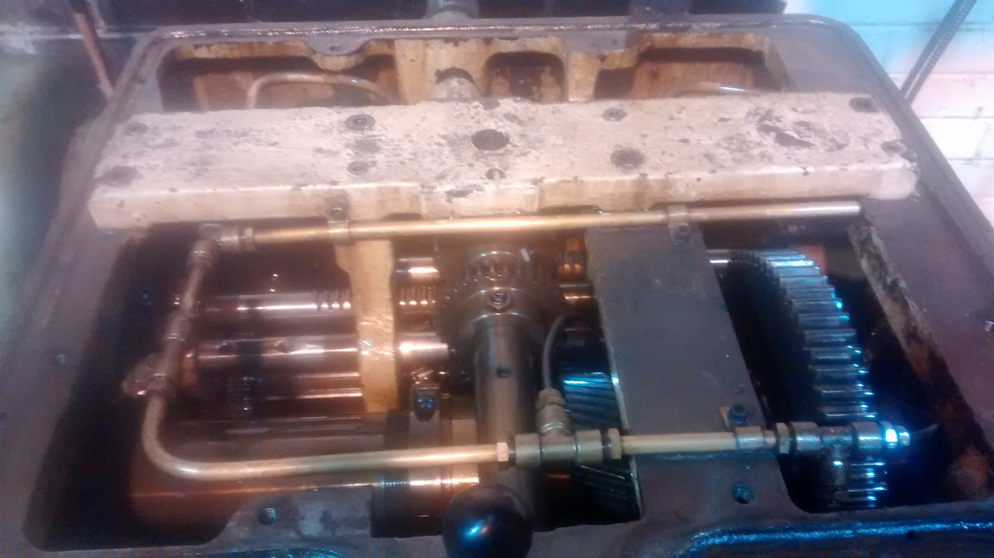

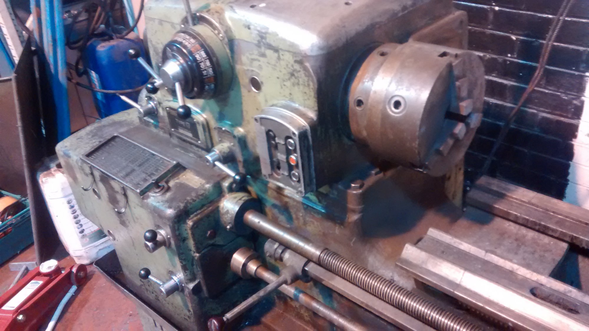

picked up a 12hp Dean Smith and Grace 17x72 last week (works 17inch diam by 72long)
much bigger than anything I'm used to (grew up with a myford ML7)
got it into position, checked oil level in top gearbox and it was empty so filled that up with gear oil, there's an oil pump in there to pump oil over the gears/bearings which didn't want to work at first but just as I was trying to figure out what was wrong it started to pump (yay)
cleaned out the sump for the coolant, was full of gunk, cleaned down the coolant try and a few nooks and crannies
cleaned up all the slides/bed etc a bit but just used an old oily rag - I'm not sure what I should be using ?
I'd like to give it a good clean up and oil all the slides etc... any advice on what to use to clean it, I'm worried most of the stuff I'd normally use to clean up metal work will leave it bare / open to rust (break cleaner etc..) what about Swarfega Jizer Degreaser ? - it's the only name I recognised when looking for degreaser
(need something for the slides etc.. but the rest of the lathe too)

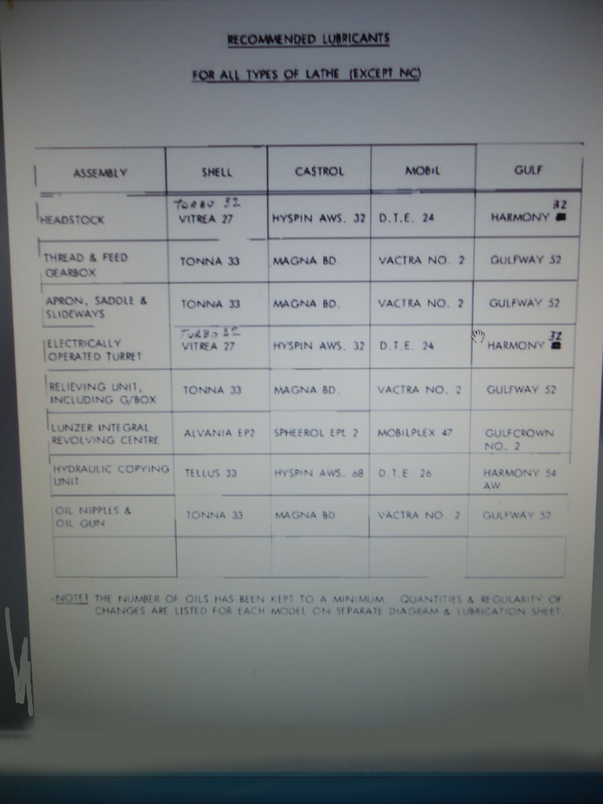

also, oiling... what I thought were worn down grease nipples are really oil nipples, I've ordered an oiler for them (fingers crossed it fits) - what kind of oil should I use, or is it a case of anything will do?
ordered some Rocol soluble cutting fluid / coolant - rocol is the only name I recognised so went with them
I need new pipes/nozzles for the coolant, bought these for now but now sure how good they'll be ? don;t look very industrial http://www.ebay.co.uk/itm/181731342537
I could do with a light too, this is the best I can find right now (I'll put an LEd bulb in it) http://www.ebay.co.uk/itm/Machine-light-task-21-/182070911845?hash=item2a6445a365:g:obsAAOSwX~dWqSlD unless anyone has a recommendation for something better ? - £105 for a bulb on a stick rubs me the wrong way

inside top gearbox checking oil flow
after a bit of clean up
