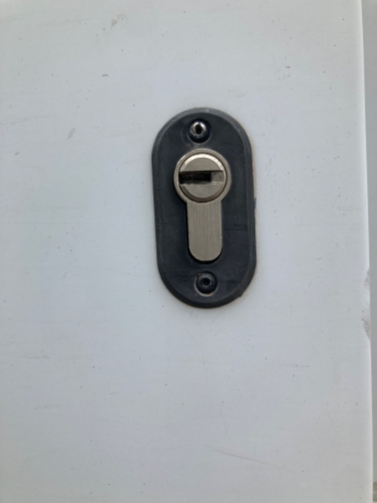

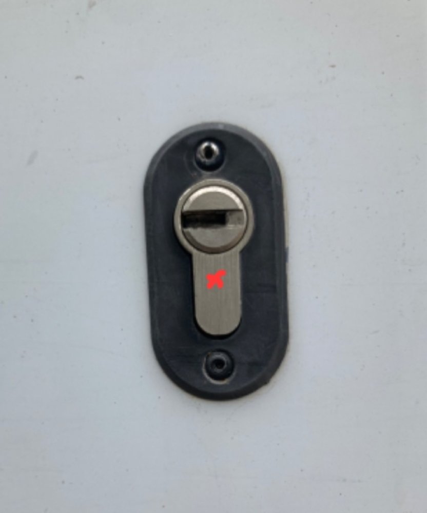

Where to drill??cobalt drill...usually make short work of thise as the local theives have proved recently...
through the lock, if you drill the pins out then you can take the screw out of the striker and use a screwdriver to turn the lock and remove it...the rest will be fairly simpleWhere to drill??
In other words he's trying to say "good luck with it"That looks like a "Eurolock" insert cylinder.
No brass pins to drill through but hardened steel ones like needle bearings.through the lock, if you drill the pins out then you can take the screw out of the striker and use a screwdriver to turn the lock and remove it...the rest will be fairly simple
Through the rotating cylinder exactly the part where you put the key.Where to drill??
And that's what I was trying to say earlier on.However, even back then, the better ones would have a hardened steel pin you had to get through and would usually wipe out your drill bit, even carbide tipped ones
Hence the cobalt drill...the local locksmiths round here don't even try and open a lock anymore, just cobalt drill...if its not a single lock they just keep going up in size til they have removed the whole cylinder...the local vehicle thieves caught onto this and do pretty much the same if they have the time...or bend the passenger door out if they are in a rush...failing that, a bump key, lock specific encoder or just get handy with a set of picks...fastest cheapest option is the cobalt drill thoughNo brass pins to drill through but hardened steel ones like needle bearings.
They have to be rotated to allow you to remove the cylinder from the lock
