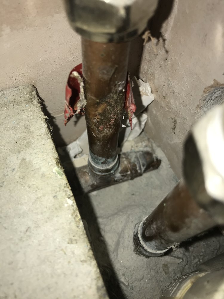

I need to remove a hot feed to a sink we are removing. Currently the sink is fed by a tee from the hot feed to another sink. Removing the tee and replacing with a straight coupling is going to be quite hard given its currebt position (almost as it cones through a wall. If the tee is capped off directly after the tee is this a problem? Whats the definition of a dead leg (length) that could cause problems?
