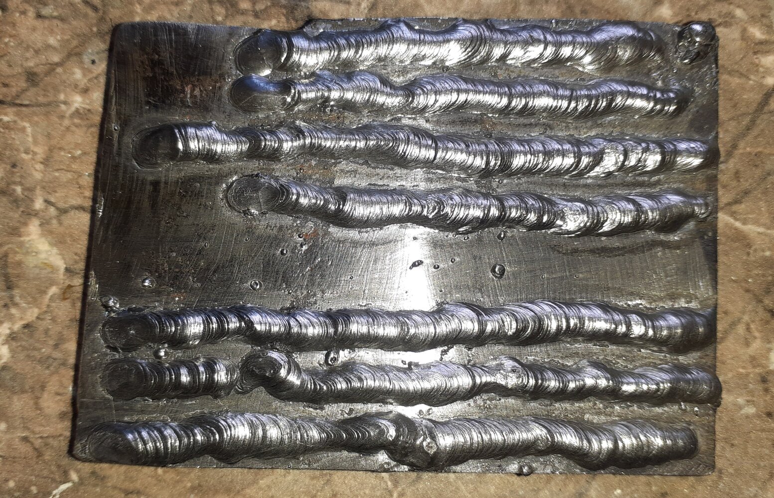

This is the first time I've ever run DCEN with any welding rods. I was using SIP 6013s from Toolstation, 2mm rods at around 50 amps.
The top 4 rows are DCEP and the bottom 3 are DCEN. I'm still trying to perfect a steady hand with the smaller rods.
