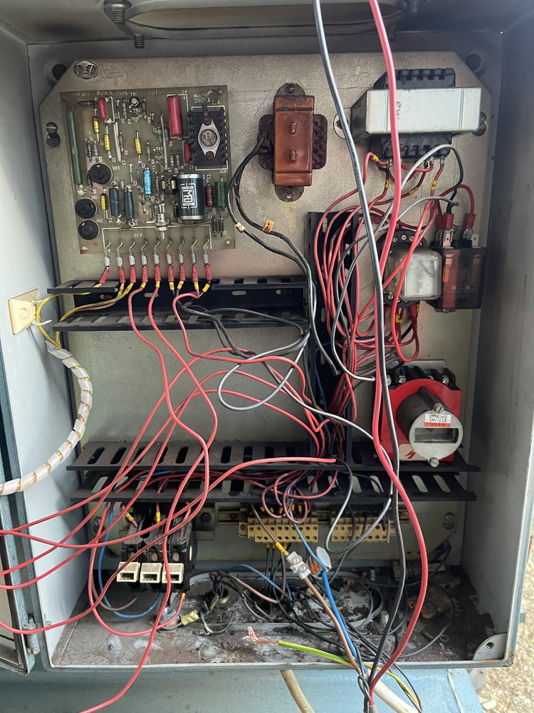

welding positioner i bought at auction of course doesn't work, i wasn't expecting it to really.

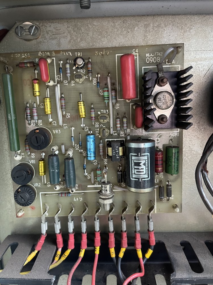

NECO DC Shunt motor
can anyone identify this board.
Pins from the left i've got 1,2 & 3 are potentiometer, 4 and 5 go to three position switch on the door.
pins 6 and 7 go to the motor, must be shunt/field winding i think?
8 goes to a relay and 9 goes to a transformer.
