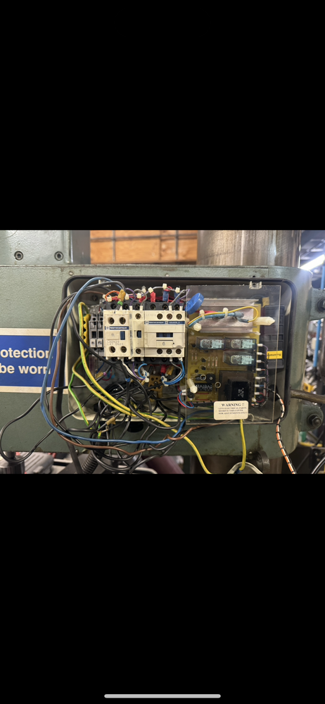

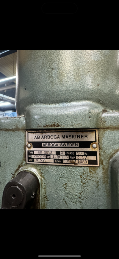

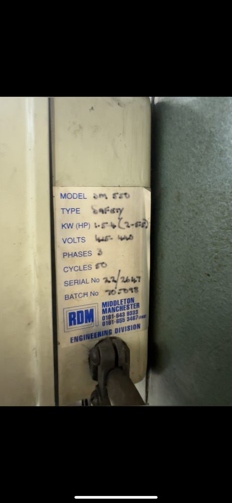

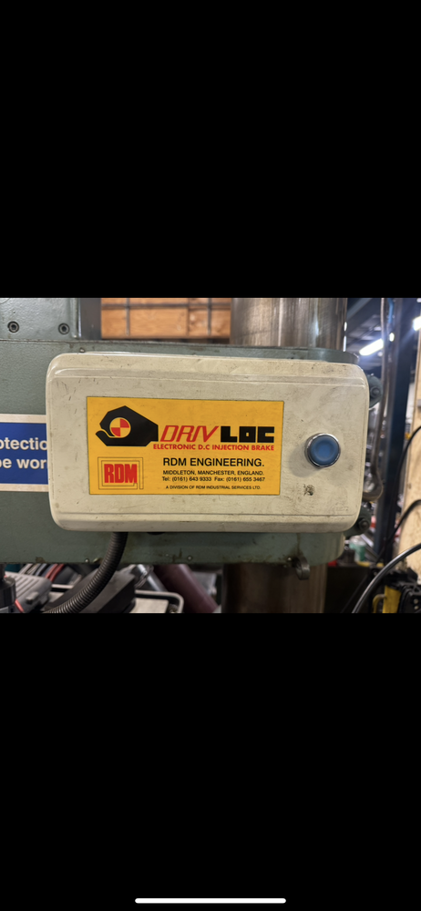

This is a small radial arm at work.
It stopped working some time ago and their electrician gave them a price of £1100 to replace this brake.
I've checked the contactors and all switches, all check out okay which leaves the boards.
Short of a wiring diagram or sending back to the manufacturers, can I replace this unit (or even just the boards) with a cheap-ish alternative.
We need to keep the safety function of a long microswitch/estop that if pressed stops the machine immediately.
