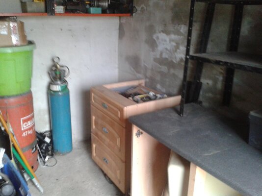

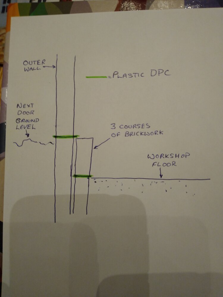

I have section of wall in my garage/workshop that has a damp issue. The construction is rubbish in this area due to some strange DPC positioning.
The sketch shows it as it was, I removed the inner course of three bricks high years ago as it did nothing. As you can see the next door ground level is below the DPC but that is three courses above my floor level. Those three courses are damp and wringing in winter.
There is no access down the side as my wall is the boundary and there is a shed close to it on next door's land (so no french drain). Also the inner layer of bricks at floor level are damp because whoever built it used commons for the foundation's.
Any ideas from the collective for stopping the damp?
