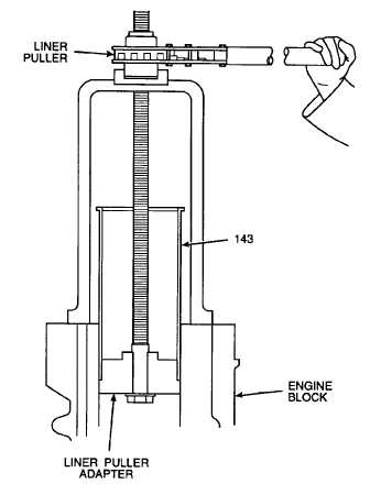

I wouldn't go near it with plasma, one bad move and you'll have serious damage.
Just go under the engine and use a hammer and block of wood to hit them upwards, make a slide hammer to allow that to be done from the top, or make a puller where you tighten a nut. They shouldn't be that hard to remove, I think you're probably worrying about this too much and thinking of rather extreme approaches.
