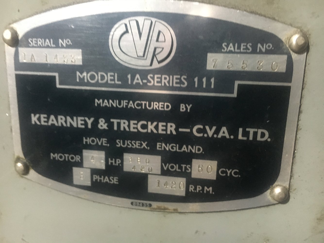

Jameson also made some BIG lathesYes, the history is complex. I spoke with some ex CVA employees and after K&T took over the toolroom lathe manufacture was outsourced.
J L Jameson in Ewell made quite a lot but later still Coles in Dorking continued manufacture (and re-manufacturing second hand machines).
Plate above is from a 1982 build by Coles.
Joe (mentioned above) recently sold one made in 1985 and that's the youngest one I've seen.

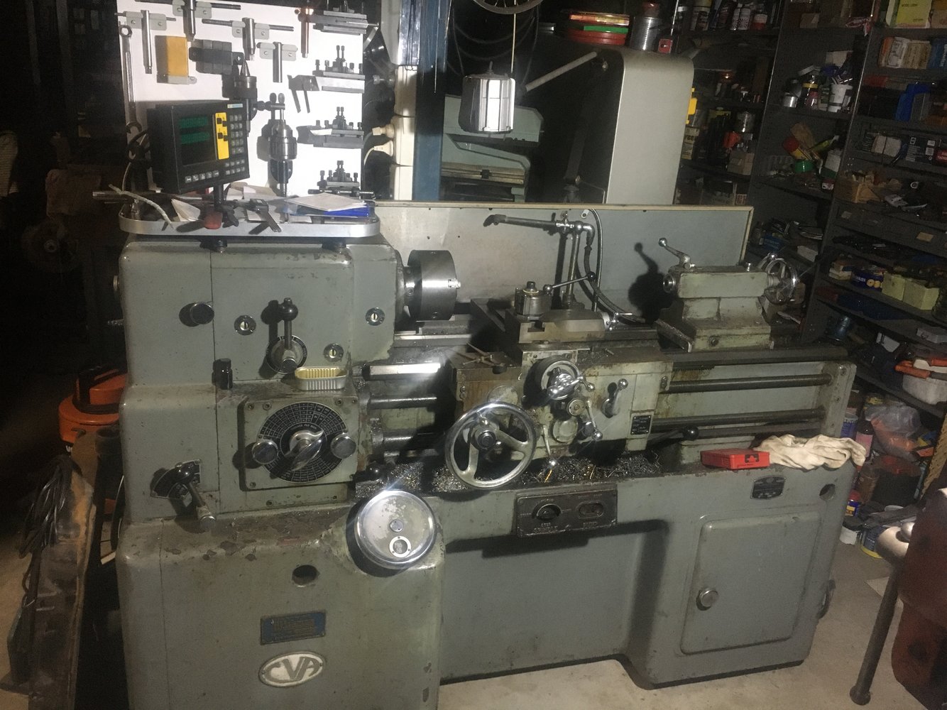

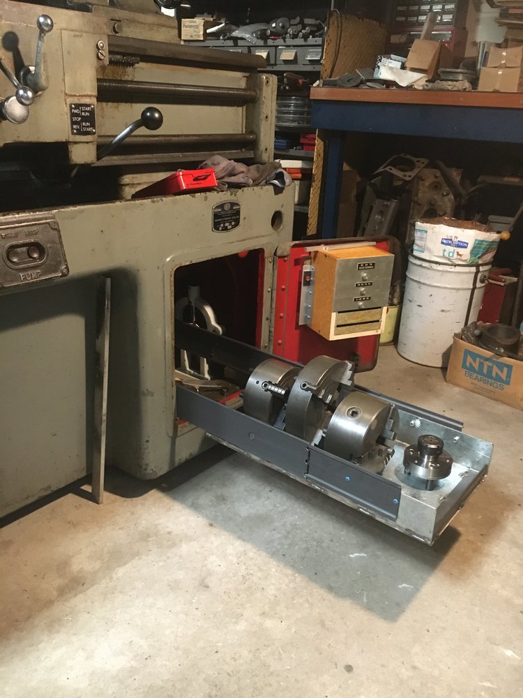

I have a 1977 CVA made by E.F Cole in Dorking, I picked it up about a year ago and it was in a bit of a sorry state - but you could see all the bones were good!

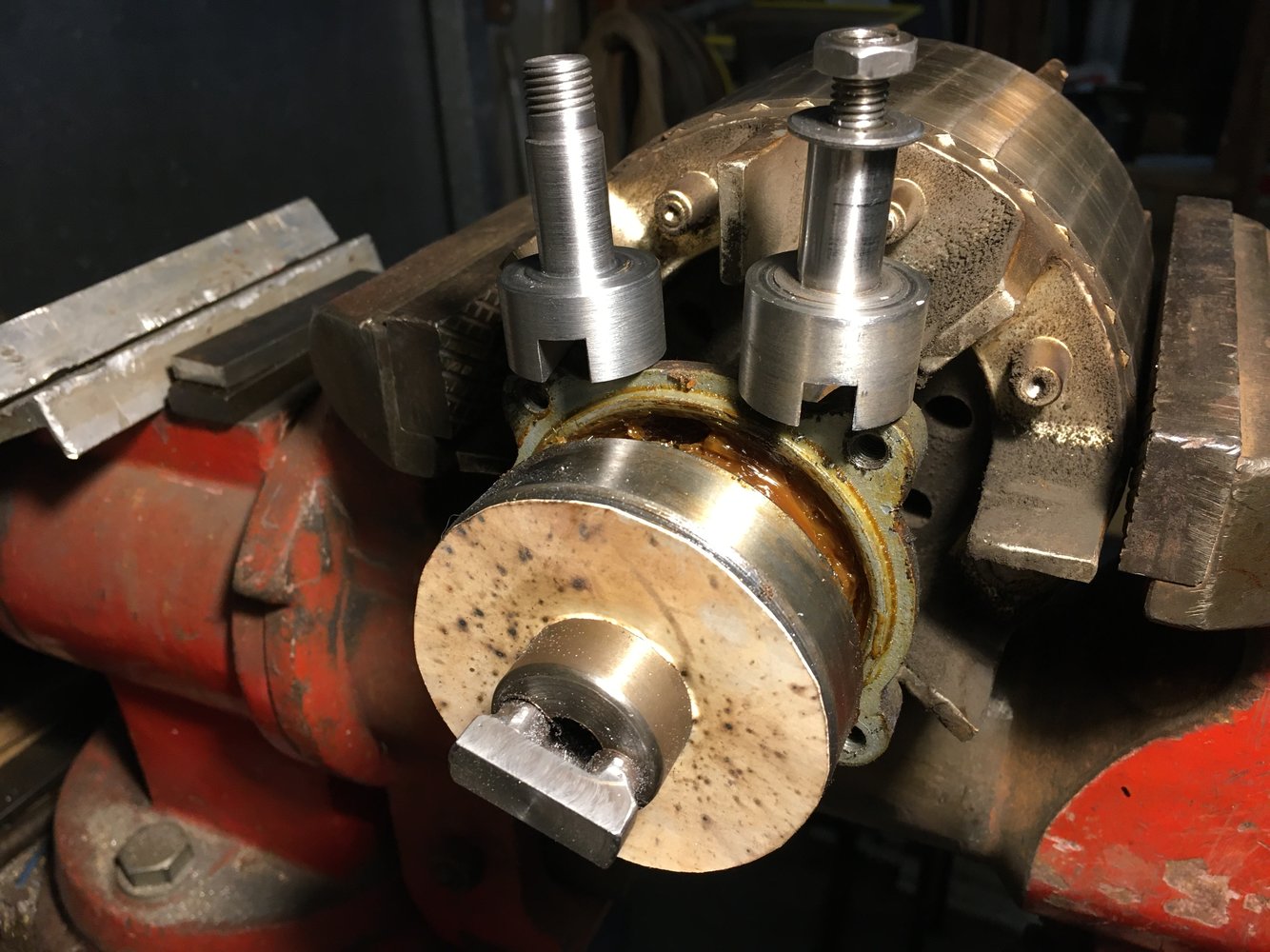

I stripped it down entirely, replaced any seals that had gone - of course the gearbox shaft seal was done! Flushed the lot with paraffin, cleaned it all up, rebuilt the little feed clutches in the apron and the lubrication system and of course a paint job!

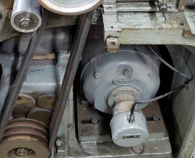

So my question is, I'm not sure my brake is working, it stops pretty quick but I assumed that was just resistance from the gearbox. I have that unit by brooks on the end of the motor which I think its the brake? How quick should I be expecting this to stop?

It should stop as quickly as if you moved the stop start lever straight from forward to reverse or reverse to forward.
