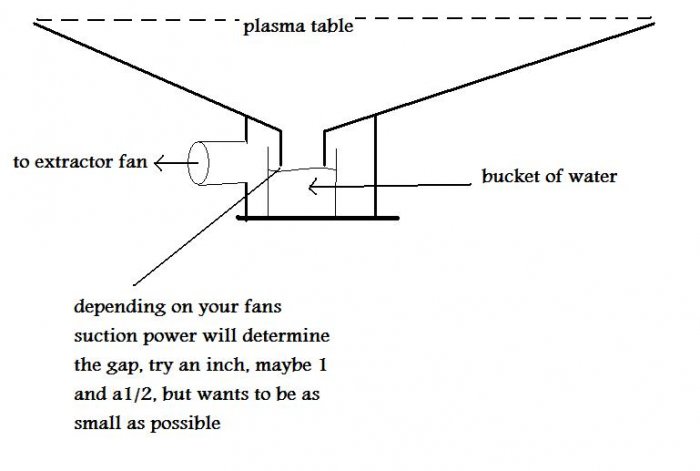

After a few weeks of having a plasma cutter i have decided i need to make a proper table for it.
Now the question is what type?
I was all set to make up a nice box and fill it with water to catch all the dust etc but then i saw this
Which looks very tempting!
So given the choice between being filled with water and magic potion or what i shall call "auto bucket" what would you choose
