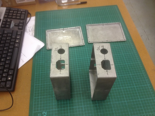

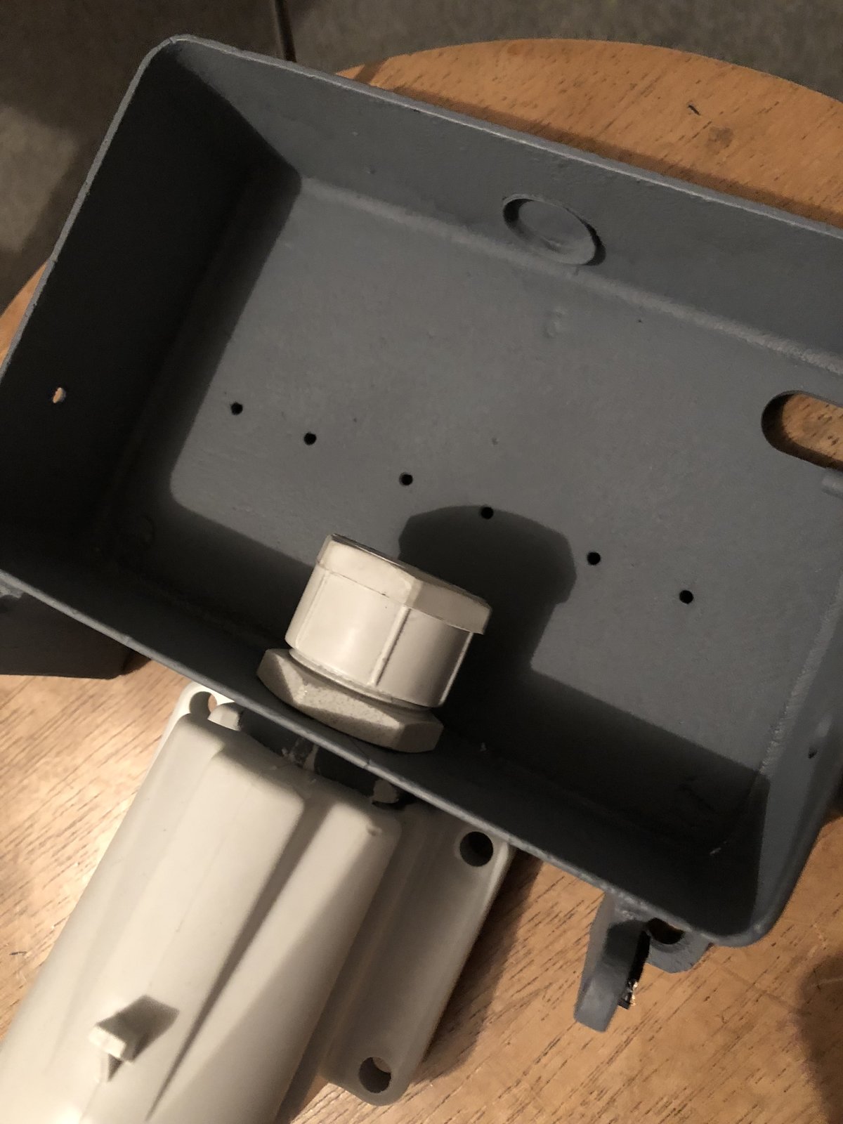

I need to cut some rectangular holes in some diecast boxes to fit sockets etc. Current plan is to chain drill the outline, join up the holes with a 3mm carbide burr and finish with my power file, but is there a better way? I have an abrafile but it's too long to use on the small boxes.
