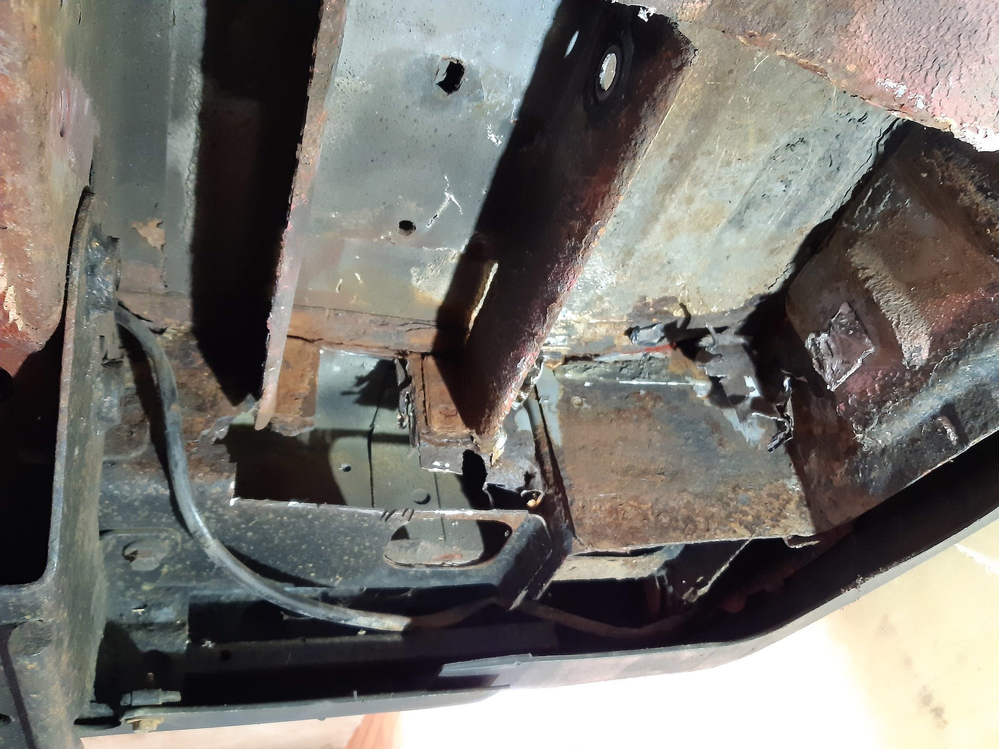

I've used plasma on vehicles a few times, I don't think it's really suited to this kind of work in most cases. The jet of molten metal sprayed from the plasma cut can cause a lot of problems on vehicles.Has anyone had any experience using a plasma cutter on this sort of job?
A few weeks ago I cut the boot floor out of a scrap car to use in a car I was repairing, it worked brilliant for that situation but there was quite a bit of damage done to stuff that got in the way of the jet of dross, car was scrap so it didn't matter but I didn't use the plasma on the car to be repaired.
