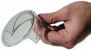

I need to cut a 40mm home in the centre of a 600 X 600mm sheet of acrylic glass. I was thinking about a hole cutter of slow speed so as not to melt the Acrylic. Bit worried about cracking the sheet. Any Suggestions?.
Dave.
Dave.
take some of the set out of the teeth if you want to try standard hole saws ( I would advise against it) Scary cutting aircraft canopy's to put in snap vents Soapy water is good
